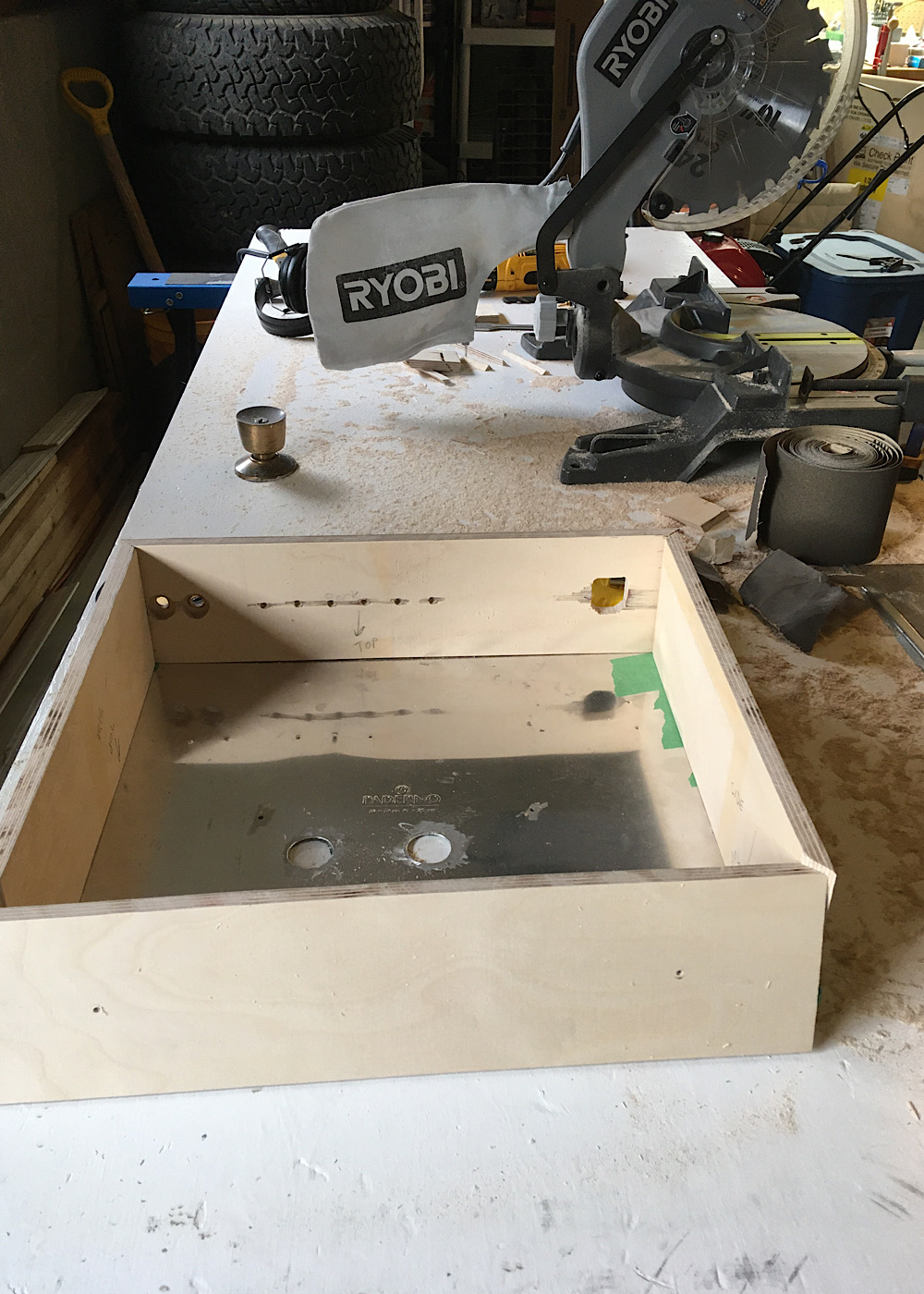

Had a spare couple of hours on the weekend to start building the chassis frame. The material is ~3/8 inch (9mm) Baltic Birch comprised of 9 layers. Incredibly dense stuff. The outer layer on one side is nice enough that I can stain and clear coat it and it will look just fine.
I had to do the ripping with a Skil saw so the long cuts weren't "perfect" but after a little bit of sanding they are "close enough". My new-ish power miter saw with lazer certainly made the 45s simple and extremely precise. Holes in the back panel for power, inputs and outputs went well. Now I am delayed waiting for the VU meters from China - I want to measure them before drilling the holes in the front panel. I won't put the frame together until all this drilling/prep work is done. Note: the front panel is leaning sideways in the photo, but the fit is actually perfect.

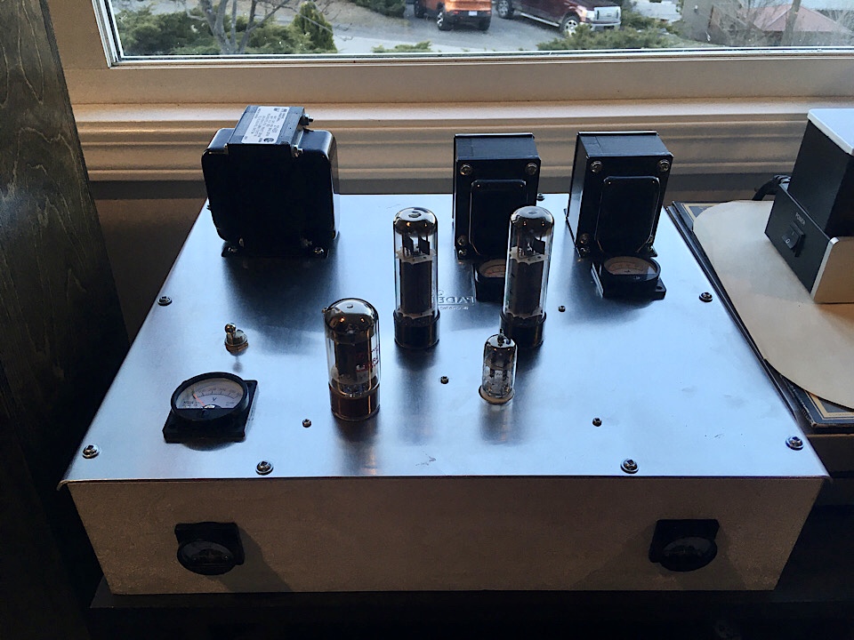

Time for a big update.
I've had all the parts I need to build the amp for a few weeks now, but due to some major household projects the SSE has been on hold. On Saturday I did the final prep on the chassis frame and got it glued together. Yesterday was a big day:
- drilled the holes for the voltmeter and ammeters in the top plate
- drilled the holes for the transformers and installed grommets in the wire holes
- drilled the holes and secured the top plate to the wood frame
- installed the SSE board in the chassis
- installed the transformers onto the top plate
- installed power connector, input and output terminals
- wired up the power transformer, power switch, power connector
- wired up the OPTs
I still need to wire the inputs, install the choke and supplemental cap, and then thoroughly double and triple check my work before I can go through a checkout. The amp will be tested and run for a while without any of the meters connected. Here's a pic to show the progress (tubes installed just so I could see what it looks like). I'll have to remember to take a pic inside the chassis next time. Note: the chassis will be stained the same colour as the speaker to the left in the pic.

It works!!!
Yesterday I wired up the inputs and installed the choke, then double and triple-checked all the wiring and decided there was no point in waiting any longer.
Note: Always powered down and unplugged between steps.
1) Powered it up with no tubes and watched, listened, sniffed for problems - no problems detected
2) Same as above with a 5AR4 installed - no problems detected
3) Same as above with all tubes installed and old crappy speakers hooked up - no problems detected
4) Same as #3 - measured B+ voltage (R4 to GND) = 414-416v
5) Measured R17 voltage = 31v
6) Measured R27 voltage = 31v
7) Hooked up a source = Music from both speakers!
I let it play like this for about 15 minutes and then shut down and unplugged everything, then hooked it up in my main system and powered it up.
Some observations:
1) It is dead quiet! With my ear 2 inches from the cones, the speakers literally sound like the amp is powered off when there is no audio signal.
2) Initially, it sounded a bit crunchy in the top end, but then I remembered I had installed a questionable "NOS" GE 12AT7 for the initial testing, so I swapped in a Marconi Radiotron 12AT7 and I couldn't believe how much that improved things.
3) (After a few hours of burn in) this amp sounds fantastic to me! It is in triode mode with no CFB and I am perfectly satisfied with the power/SPL.
4) Yes, my B+ is much lower than anticipated, but I think I know why. The new version of the Hammond 274BX has two primary windings - one for 115v mains and one for 125v mains. My mains power measures at 119.8-119.9v so I decided to go conservative at first and wired up the 125v primary winding - therefore all the secondary NLVs will be lower than spec. At this point I feel like I should just go head and us the 115v winding and my rough math tells me I should gain around 30-35 volts from that.
***I really would appreciate some feedback from the community on #4 above. Do you think I am right about the 125v vs. 115v windings causing my low B+? What other issues could be contributing to a low B+?
Right now, these are my numbers:
B+ = 415v
Cathode v = 31v
Cathode R = 680
Cathode I = 45.5mA
Dissipation = 17.5W
* Shuguang 5AR4, Radiotron 12AT7, 2x EH EL34

Congratulations! It's a great thing when all your preparation and hard work pay off!
Yes, your primary tap is likely the reason for lower B+, but you're not really too low. Try using the 115 tap and monitor the results. You might check your heater voltage to see where it is. In my build, I over-spec'd the power tranny a bit and I got closer to 7v, which I didn't really want. So I run the amp on a variable transformer to keep it close to the 6.3 spec. Plus it's isolated from any line garbage, which may or may not be a benefit.
At any rate, enjoy the music! Let us know if you change anything up, and how it turns out.

Thanks for the feedback!
I should note that I am running one of these MS22 12103-B Ametherm | Mouser Canada on the L terminal of the AC power connector. According to the datasheet, R at 50% current is 2.65 ohms. I am guessing I am losing about 4-5 volts here before I even hit the primary... (?)
I am questioning whether I really need it there since I have the CL-140 on the board...
Congrats!!! It really is an awesome amp.
I have a CL-90 on my L terminal and the CL-140 on the board, too. I'm between 454 and 457 B+ so I don't think inrush limiters affect voltage once they warm up.
Mine is also dead quiet. Likewise, I can't hear anything at all at the speaker cone with the volume down.

Thanks dwinstonwood!
I'll leave the inrush limiter there for now and switch to the 115v primary. I bet B+ will be close to 450v.
I hope to try it later today and report back. I've run out of solder, so it might take some ingenuity. 🙂
