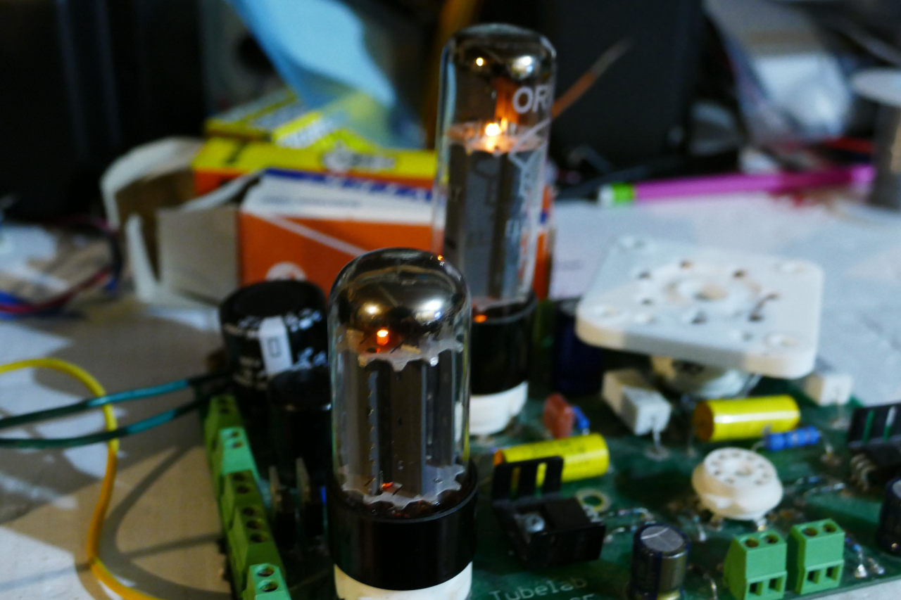

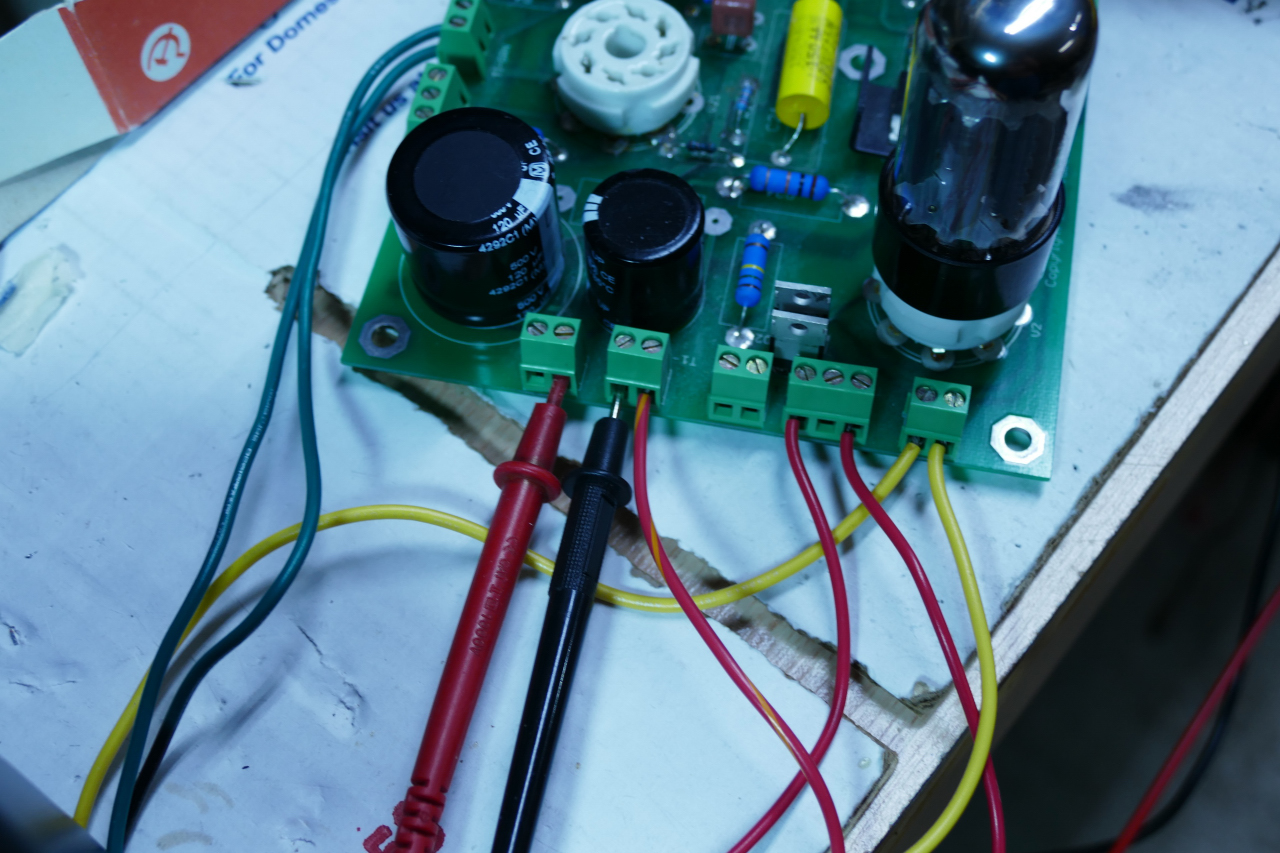

There has been some conflicting information in this thread, and I'm not sure exactly what state the board, tubes, or other parts are in, so let's try some simplified "divide and conquer" troubleshooting starting from the transformer.
I grabbed an SSE board in unknown condition from my junk box. It is a very old board which has been used for all sorts of experiments that may end badly. It has been blown up and rebuilt dozens of times in 15 years.....just ignore that monster tube socket in the upper right. It was from a "I need more power" experiment that failed, and will be removed when we get that far.
The power transformer is one that was on my bench for testing TSE boards. It's a bit low in voltage compared to what's usually seen in SSE boards, but it is good enough for use here. My readings are in the 460 volt range without output tubes, where yours should be around 500 volts.

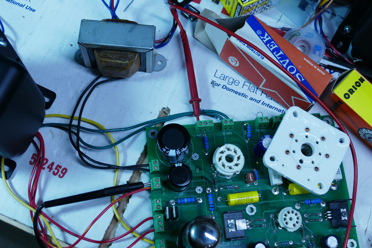

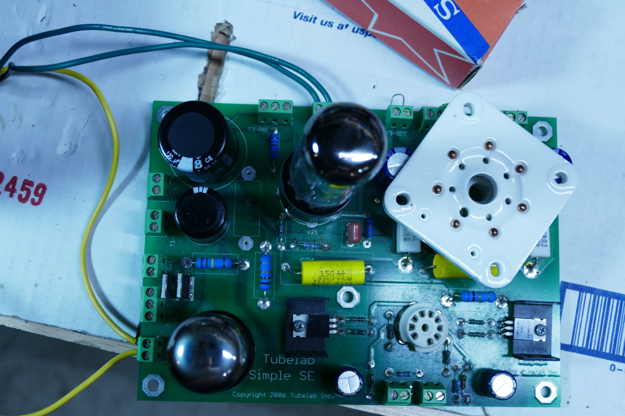

Connect only the green pair of wires from the transformer to the T1-GRN connector, and the yellow pair to the T1-YEL connector. The primary, fuse holder, power switch, IEC inlet, and power cord should be connected as previously used. We are going to test all of this wiring and the transformer.
The red and red-yellow wires should be taped up, or otherwise insulated so they can NOT TOUCH anything...especially you. They produce several hundred volts.
Install the rectifier tube, and one output tube. See the first picture.
With the dim bulb tester in line, power up the board. The tester may glow dimly at first, then show very little glow. Both tubes should have their heaters glowing. See second picture.
Assuming that these steps check out, the transformer and associated wiring are probably OK, and we will test the rectifier and C1.

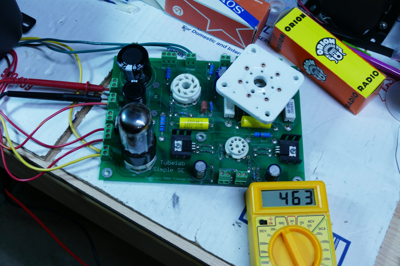

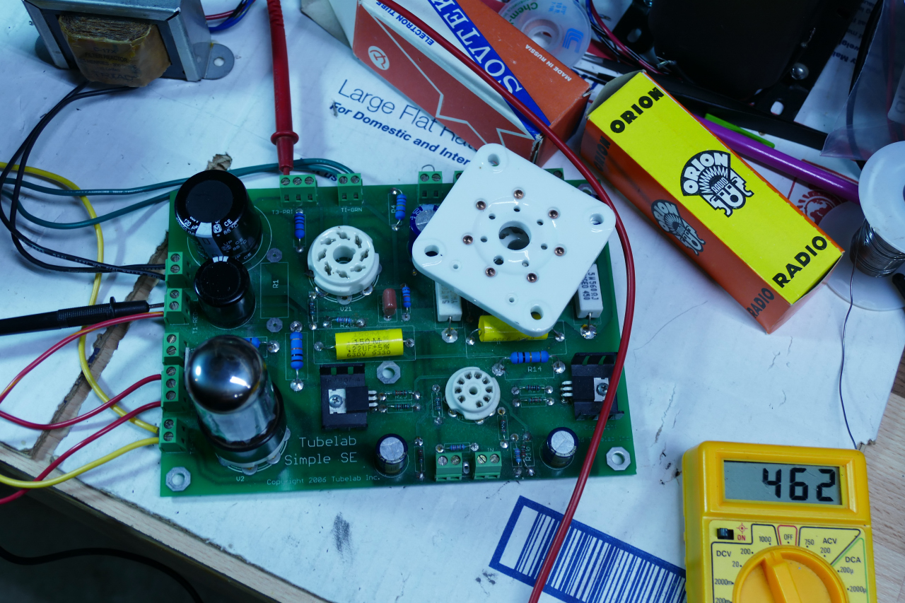

Remove the output tube, leaving only the rectifier tube in the board. Connect the red-yellow wire to the T1-RED-YEL connector, and connect the black meter lead to the other terminal in the same connector. This is circuit ground, so if you can't get a meter probe into the terminal block, connect it to any convenient ground point with a clip lead. Connect the red meter lead to the L1 (choke) connector terminal closest to the T1-RED-YEL connector as shown in the third picture. Alternatively you could connect to the end of R2 closest to the board edge. If you still have the solid state diodes, be cautious of them those metal tabs have high voltage on them. Set the meter to it's highest DC voltage scale, usually 600 or 1000 volts.
Power up the board. The bulb tester may glow briefly during warm up, but should not remain lit brightly or flash. The voltage should rise slowly at first, then climb pretty quickly to around 500 volts. Once at 500 volts there should be a dim glow in the bulb with no flickering. 4th and 5th pictures.
If this doesn't work out, try your other rectifier tube.
Once you have gotten this far, it's time to connect the choke. Remove the red meter lead from the choke connector and connect both choke wires. place the red meter lead in the left most OPT connector on the rear of the board. Alternatively, you can measure the B+ on the end of R4 closest to the back of the board. See the 6th and 7th pictures.
Power the board up through the dim bulb tester. Things should go as before, with a slow rise, then a steep rise and little glow on the bulb, 8th and 9th pictures.
You have not gotten this far before, so likely you will find a fault somewhere through these tests. Try them and see where the results deviate from what I did here this morning. Then maybe we will have a much smaller area to look at.
If all else fails you can stick the board in a box and send it to me. I will make sure that the board works for the coat of shipping.....I would say sent me the whole thing and I'll fix it, but that's likely to run into issues since you are in Canada and I hear all sorts of cross border extortion and damage stories especially from UPS.

I didn't have time to tinker last evening and now I am glad that I didn't because the set of test instructions you posted above is going to be extremely helpful! Thank you very much. I hope to have time on Friday to run through these tests and I will report back.
OK. This went well. Exactly as described and shown in your photos.

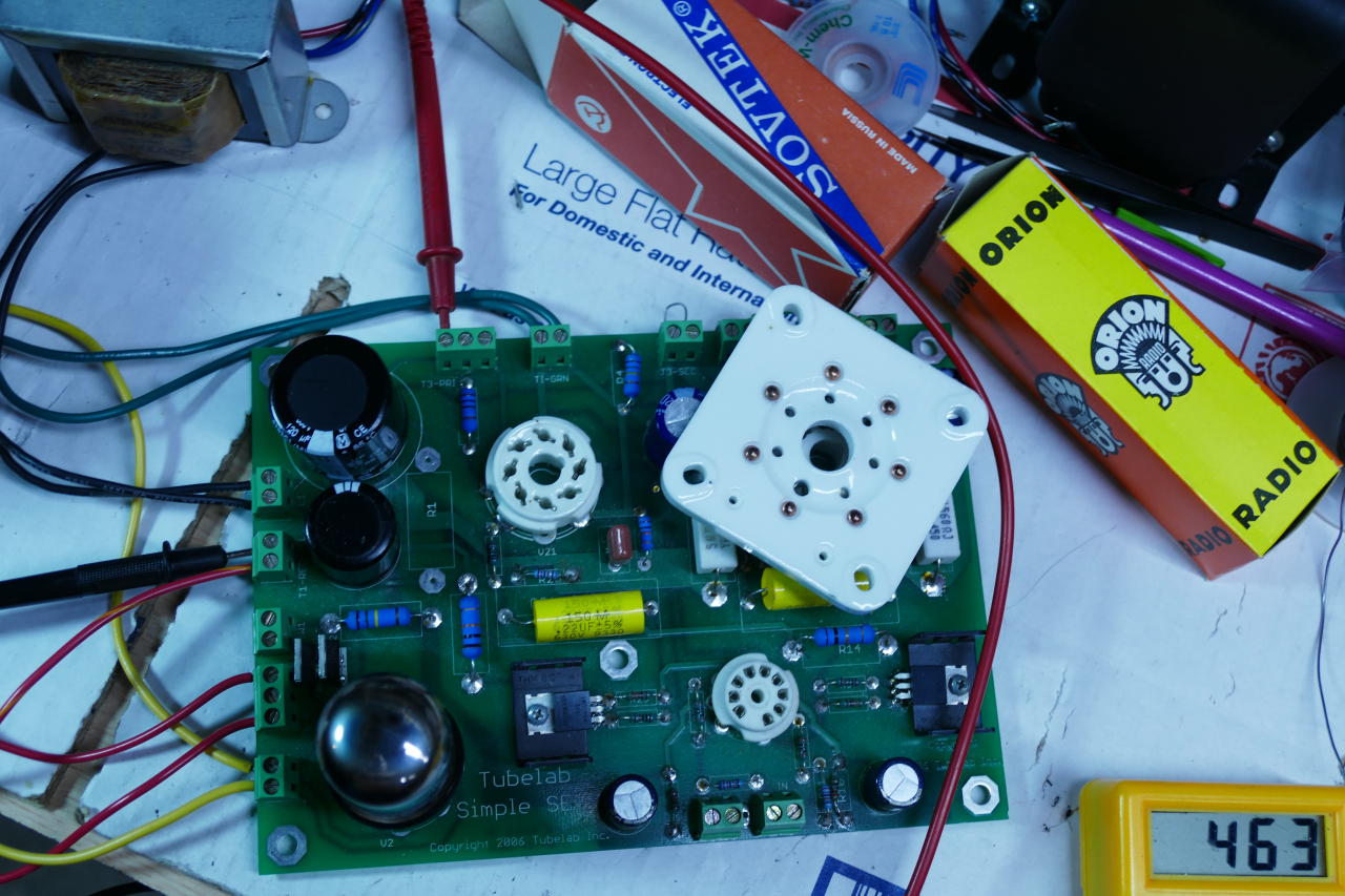

This test failed. Voltage starting climbing quickly but when it got to about 300-350V (don't know exactly) the bulb tester went very bright and the voltage immediately dropped to 3V and I killed the power. I waited 20 seconds or so and powered it on again. This time it only climbed to about 14V then the bulb went bright so I killed it again.
Tried 5U4GB. Same. Very low voltage and then bulb tester got bright
So, at this point I am beginning to suspect that the high voltage winding on my PT is shorting or burnt out or whatever. I am going to test it directly with my meter and report back.
UPDATE: High voltage winding tests fine at 375VAC - 0 - 375VAC
So... do I have a fried C1 here?
That would be my first suspect. If it is possible, remove it from the board and try the test again. If the board powers up (with a much lower voltage reading) and there is no activity on the bulb tester other than a dim glow, then proceed to the choke test without C1. The amp will function without C1, but the voltage will be lower, and there will be hum, but testing can continue.
I have seen resistors (R2) break down under voltage, but they usually make smoke and sometimes flames when they do.

I have finally had the chance to continue testing.
I removed C1 and re-ran the test that failed last time.
This test also failed. With 5AR4 voltage went to ~14V and fluctuated a bit. After some time, the light bulb flickered so I killed the power.
I swapped in a 5U4-GB. Voltage got to ~21V and fluctuated a bit. No flickering.
I noticed a smell of hot plastic (?) but did not see any smoke.
By the way C1 tests fine at 49uF.
You are measuring this 14 to 21 volts where? Black lead on ground, and red lead on R2 or the L1 connector terminal closest to the recitfier tube? I am assuming this is true, so, there isn't much left in the path here.
I see two possibilities, neither one seem likely, and I have never seen it happen before.
An internal short inside the power transformer involving the 5 volt winding, or external to the transformer on the wires (yellow on a Hammond) or its Center Tap if present (Yellow with a black stripe) which must remain unconnected.
The little thermistor TR1 could be fried. I have never seen a bad one, but there is always a first time. Examine it carefully and measure its resistance with an ohmmeter. It should be about 50 ohms. If suspect, replace it with a piece of wire and try the test again.
