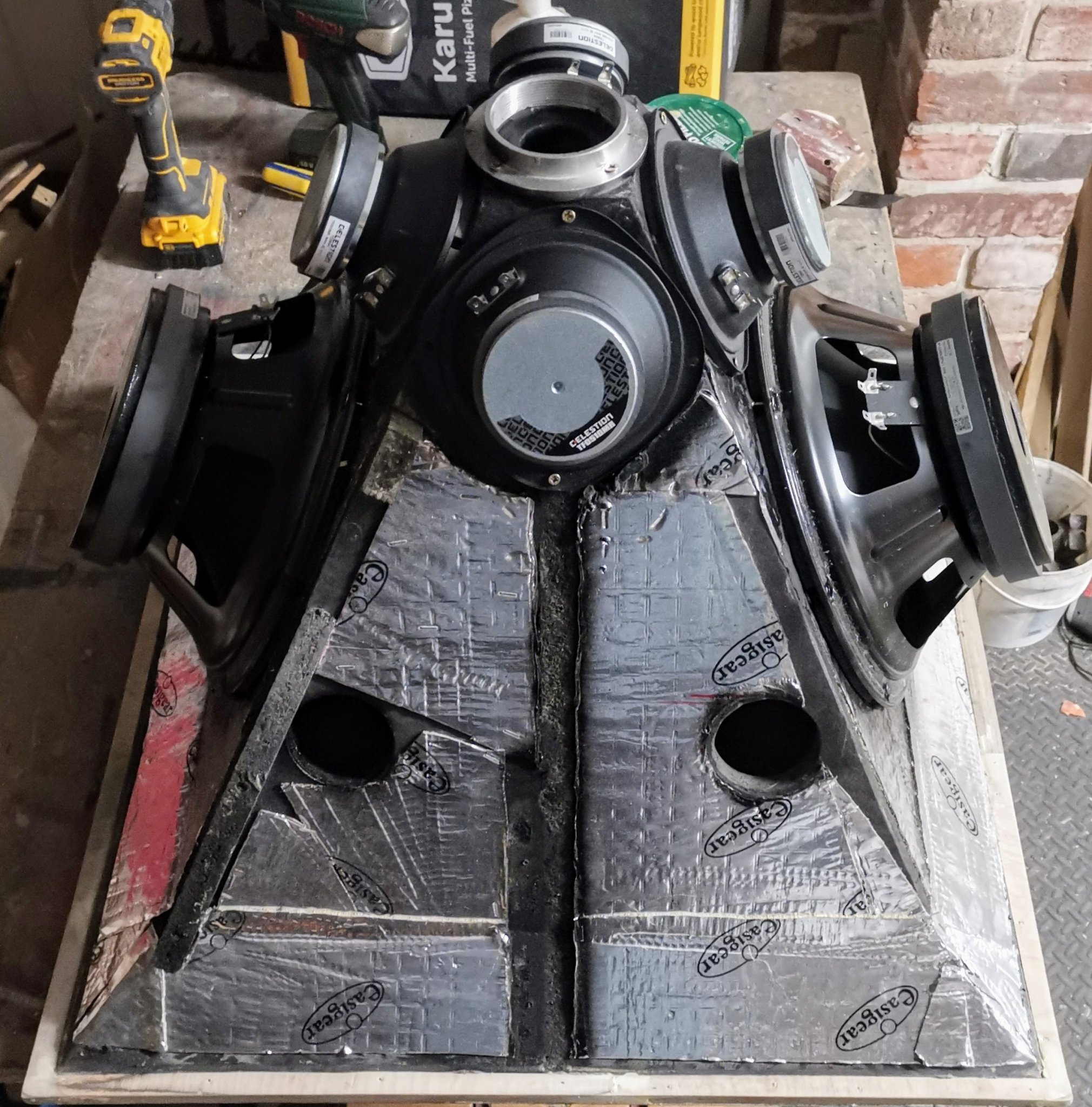

Meanwhile I'm ploughing on with the extra driver loading for the RH cab for my setup.
All taps and ports done.
Making a new rear can enclosure for this side with the 6 side bolts and 4 front fasteners.
Got new rear cab support rails to fit too.
Really looking forward to hearing the finished pair..

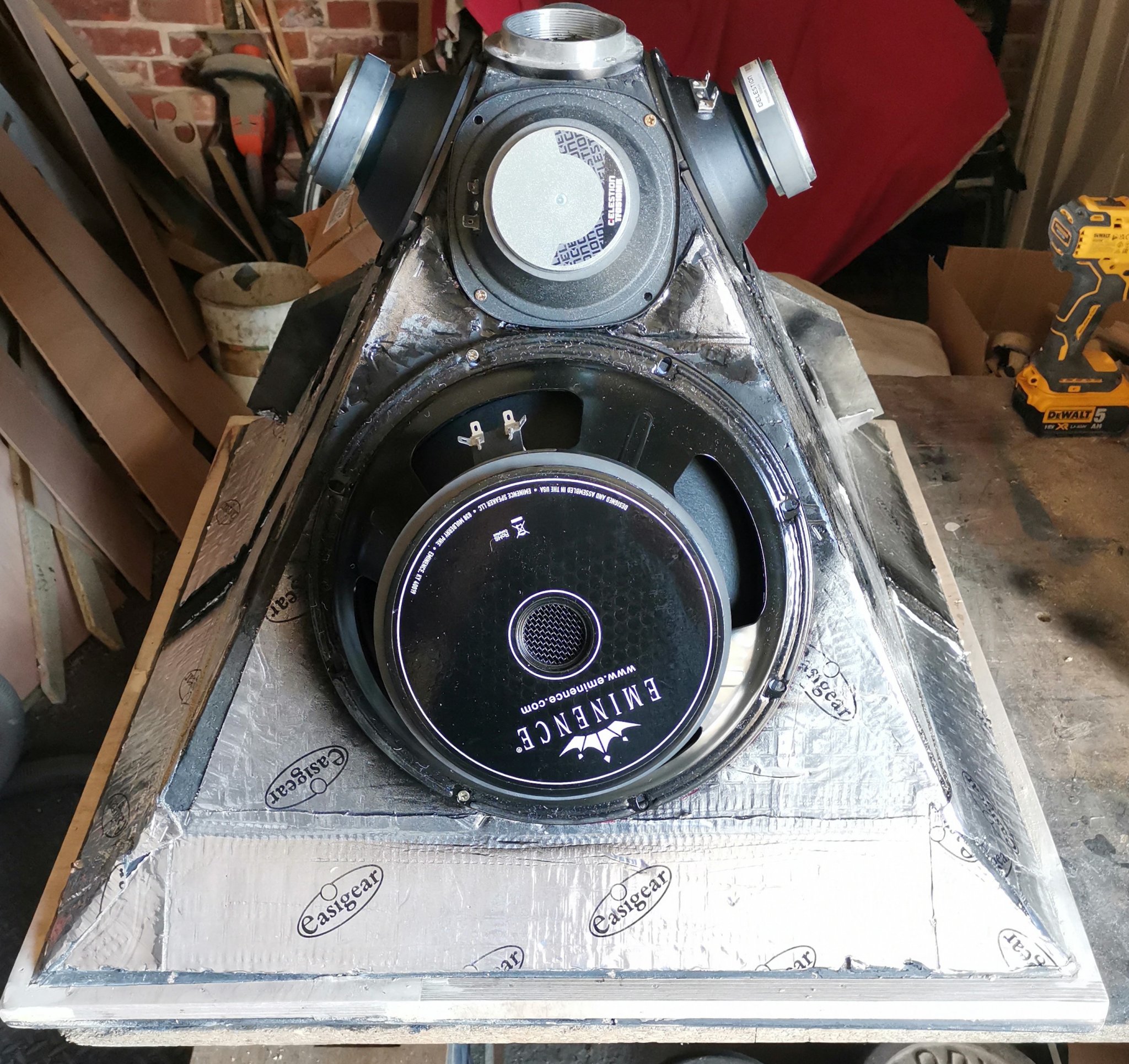

I finished the 2nd cab full driver compliment project.
New full volume rear cab made and painted.
I really like the Danley method of using long bolts through the rear cab shell through T nuts in the horn.
Really positive fixing and pulls the sides in on the bracing runners nicely.
I wired up. 4 MF drivers to give 8 ohms and the 2 LF giving 4 ohms.
I just need to find a nice way of sealing the hole in the rear of cab where the Vitavox S2 drivers stick through.
Tape works but is not so nice - a neoprene ring, flange etc are on the cards.
Got the cab back in place💪
Running them up now 🎶 😃
2 X LF per side shift some air / punch nicely when called for.
I'll swear the 4 X MFs sound sweeter too? It's okay I'm biased - after all the work I've put in on them😂

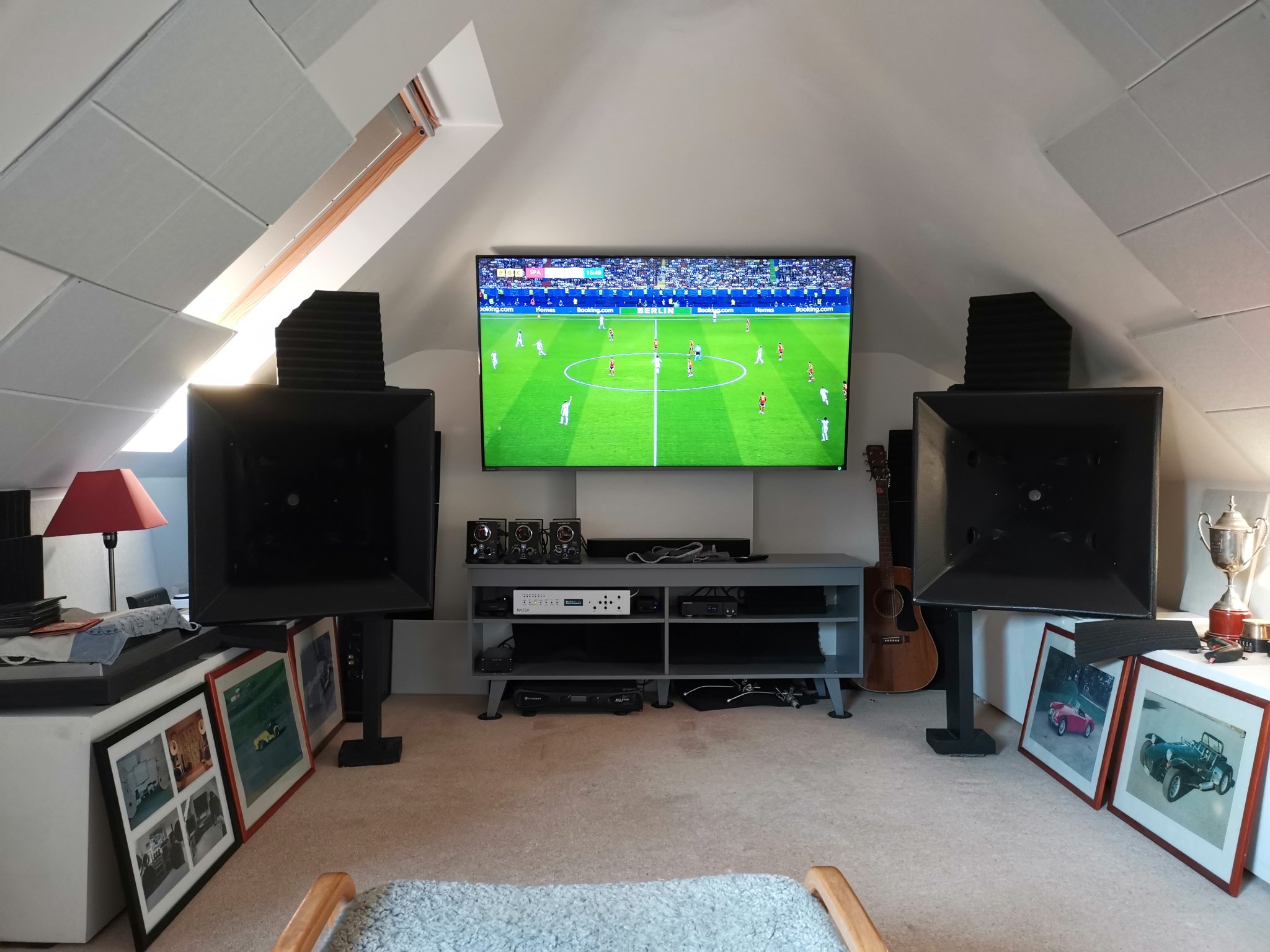

I'm no football fan, so listening to music and researching on DIYaudio and occasionally looking at the screen to see what's happened is perfect🙂

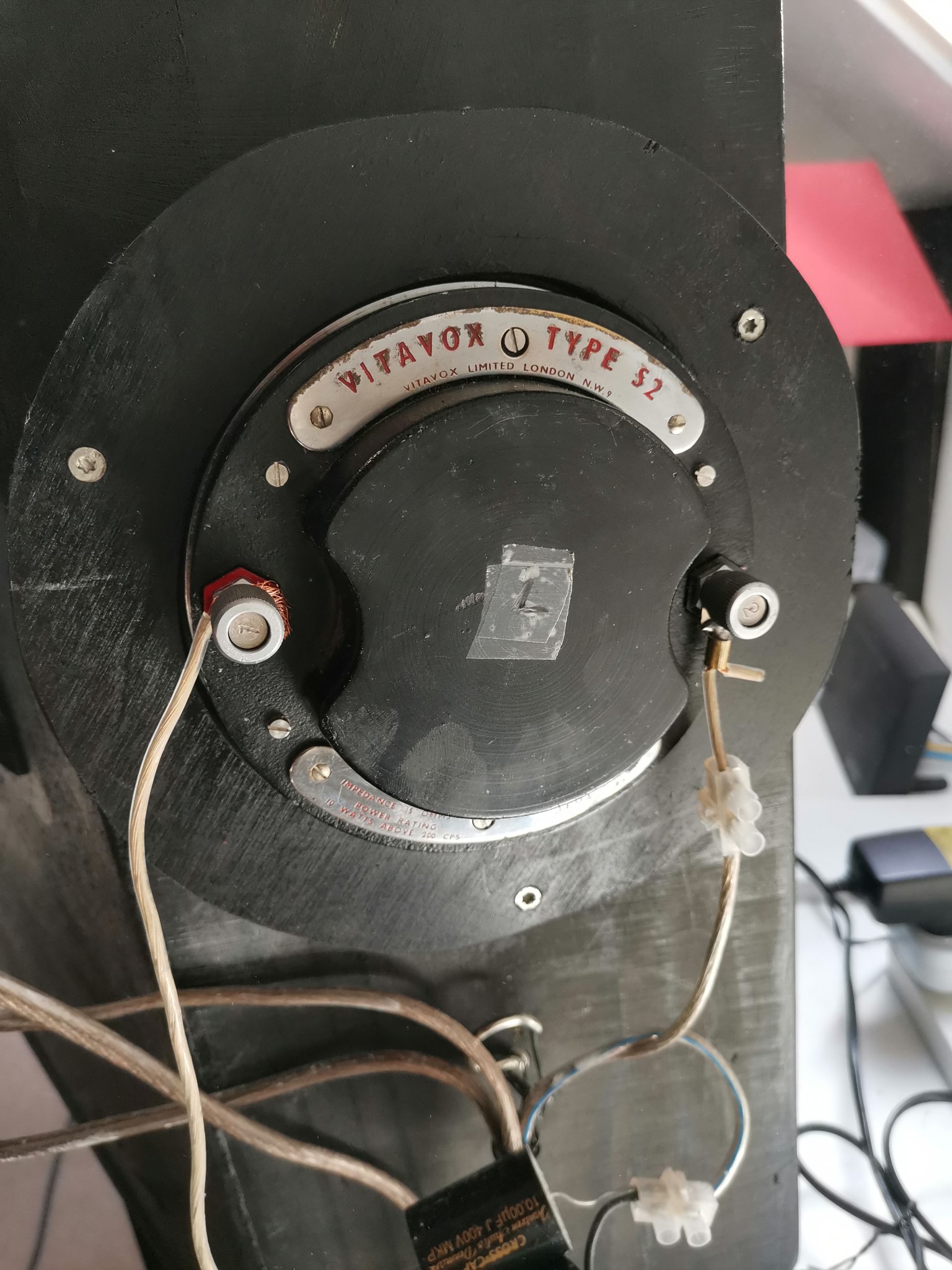

A couple of smaller tidy up jobs done.

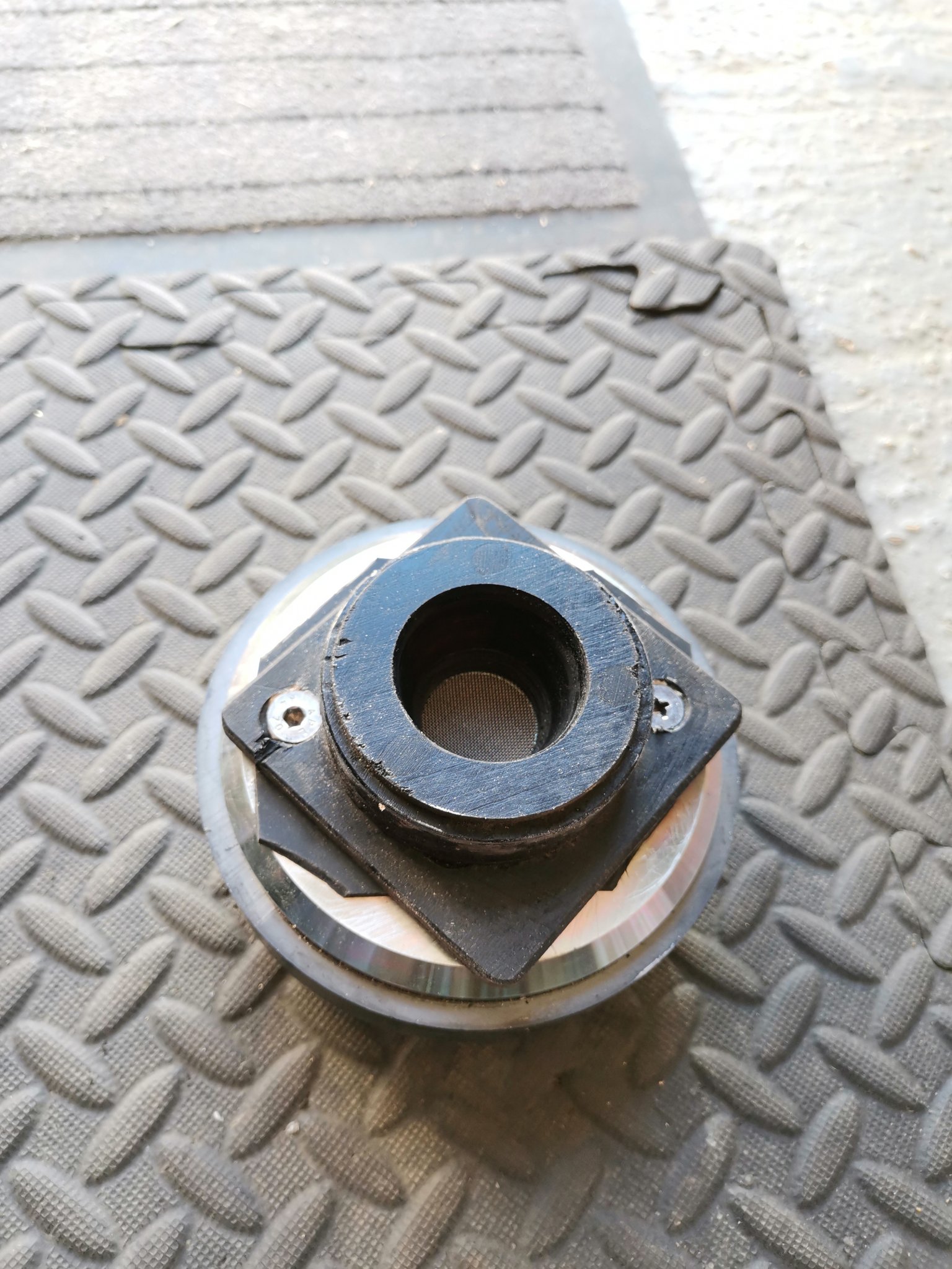

The first was to find a way to seal around the Vitavox S2 drivers that stick out the back through a ~5" hole.
The foam stuck in and tape around needed something better..

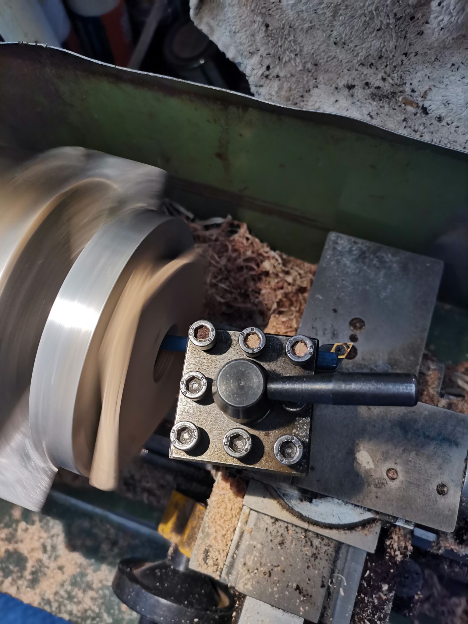

I came up with the idea of a turned birch plywood ring with a recess on the inner surface.
Slightly larger diameter than the S2s themselves.
I cut a ring of springy packing foam that was a tight push fit over the driver and likewise in the recess.
Once bolted up it really made a good airtight seal.
3 screws clamp it in place.

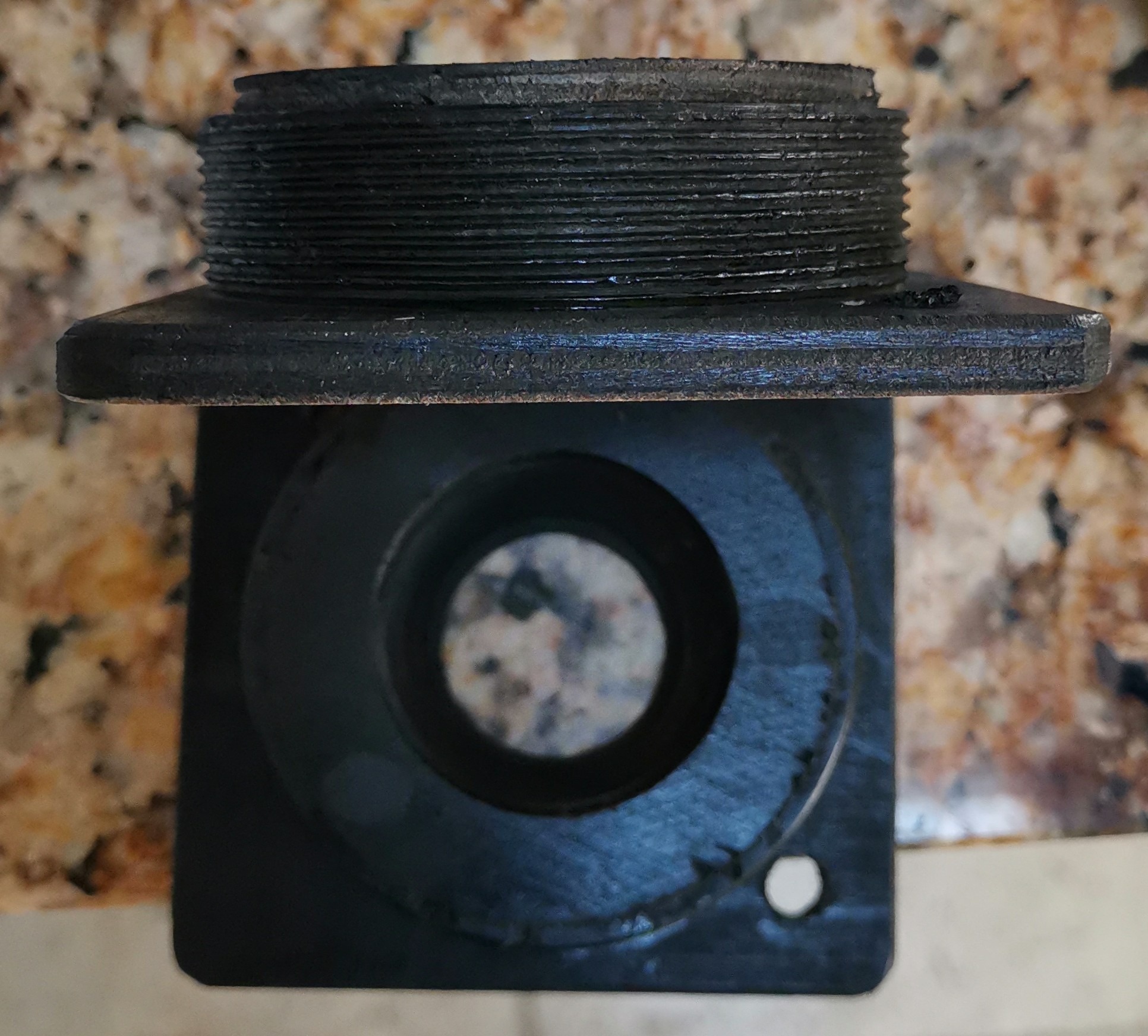

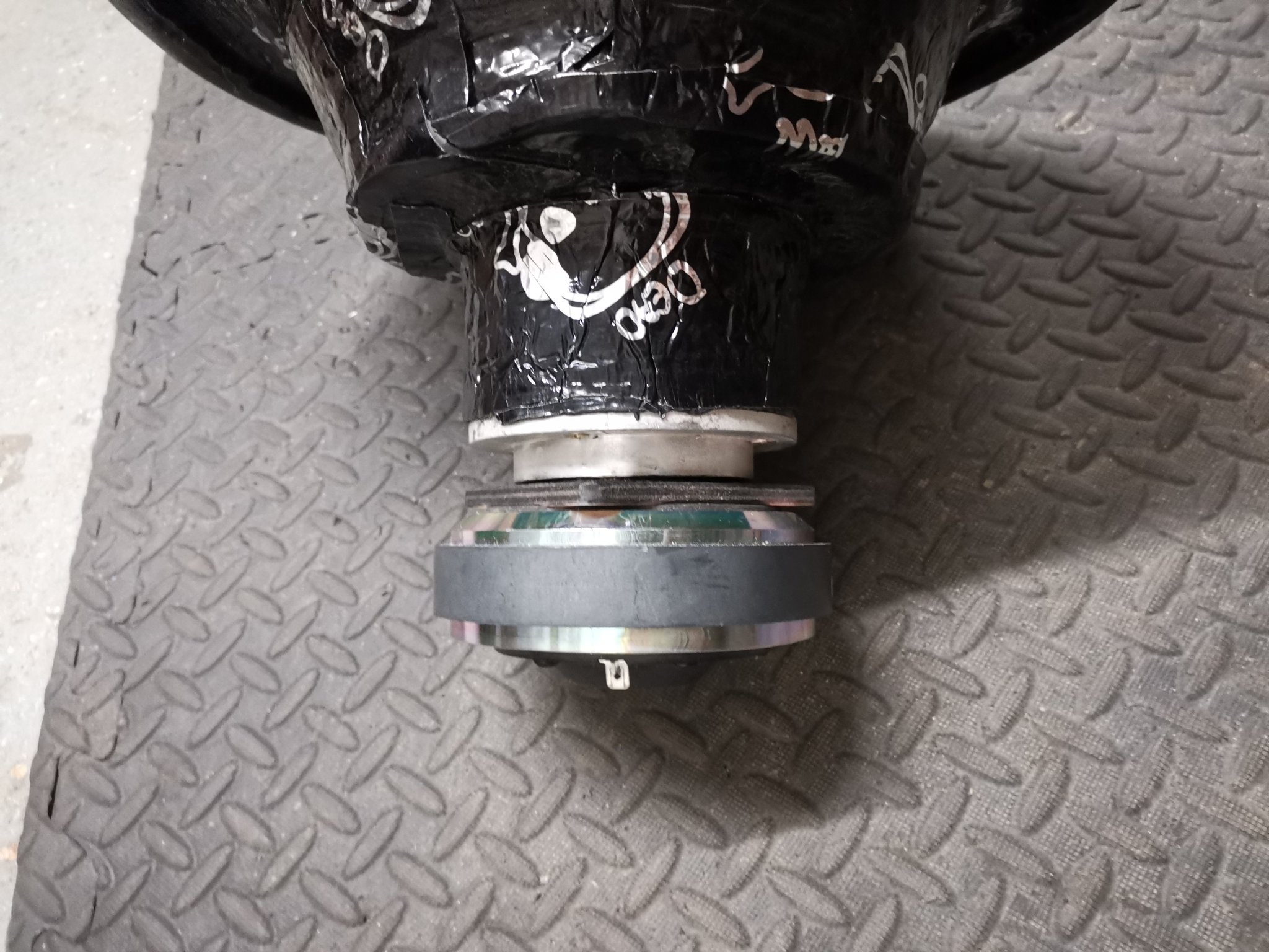

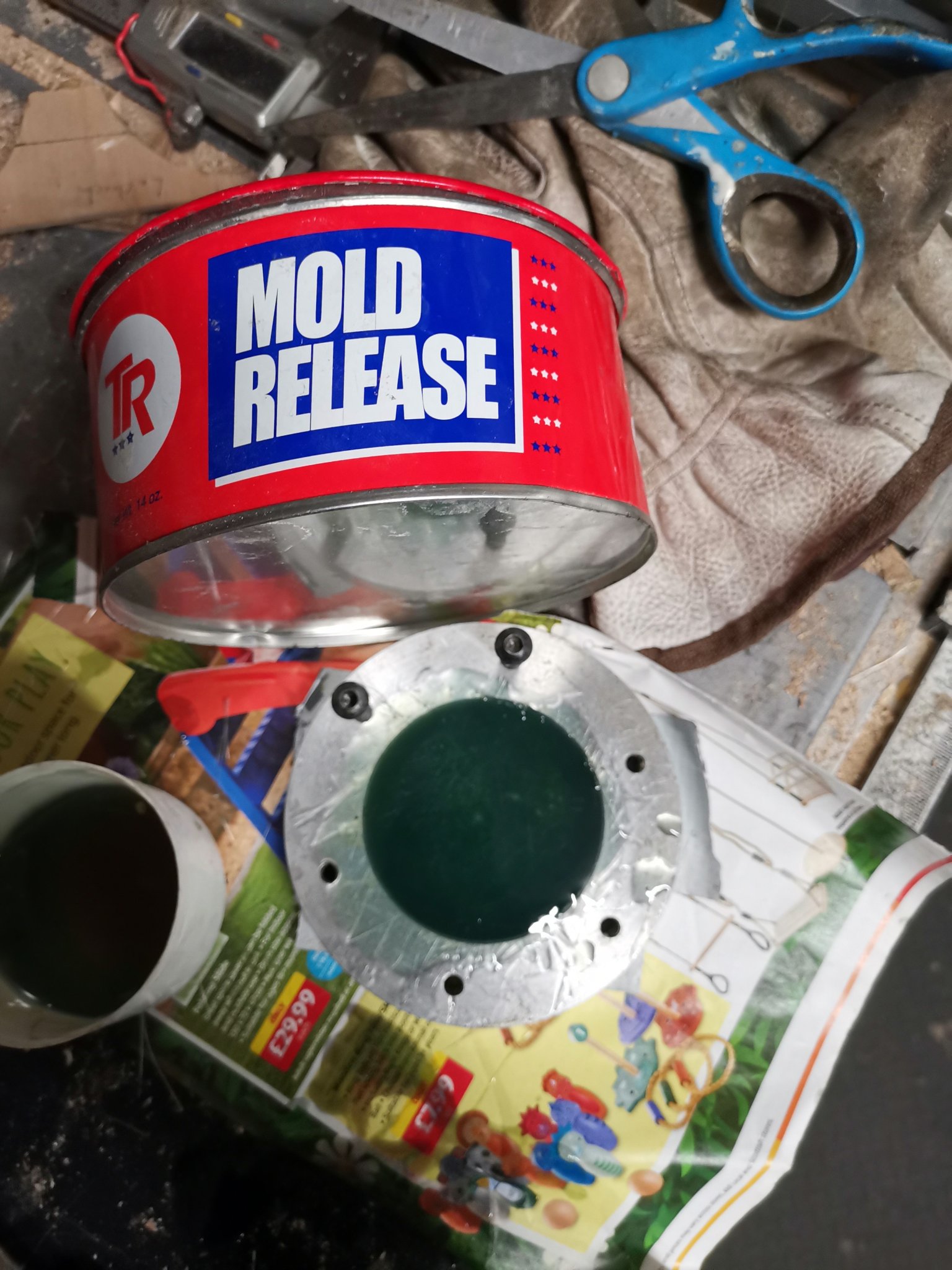

Next up was a pair of screw in adapters to make fitting the BMS 4550 compression drivers back on possible (weddings and garden parties) use.
I was going to turn these but as the BMS are so light I came up with an easier free solution.
Didn't have the plate or bar aluminium to do it from.
I 'cast' polyester resin into an outer adapter ring.
The mould release was works really well - last used when I made a pair of 400Hz Tractrix horns from a mould I also made.
Once released testing in a S2 screw fitting ring.
Whilst this won't be as durable as aluminium it is only for occasional use and does work once the threads were lightly cleaned up with a 45° cutting tool.
Then to fit a spacer and driver flange.
Both from 4mm birch plywood and turn out from 1" to 1.5" over the 20mm thickness.
Close up
Fitted to the driver

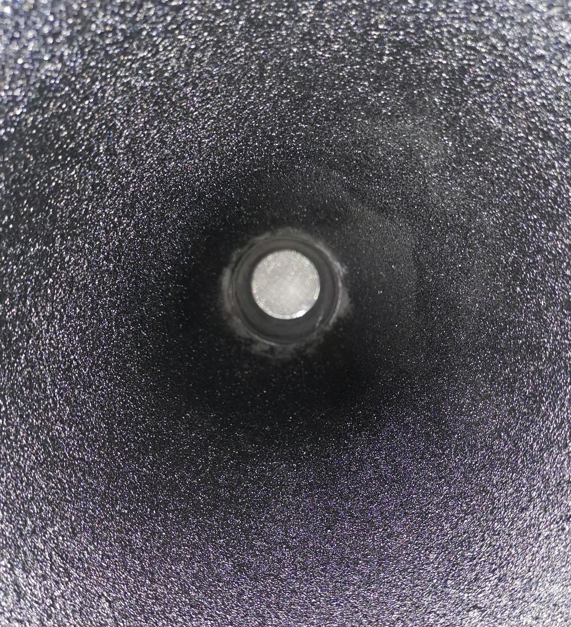

Test fitting on the old Le Cléac'h horn
Internal throat view

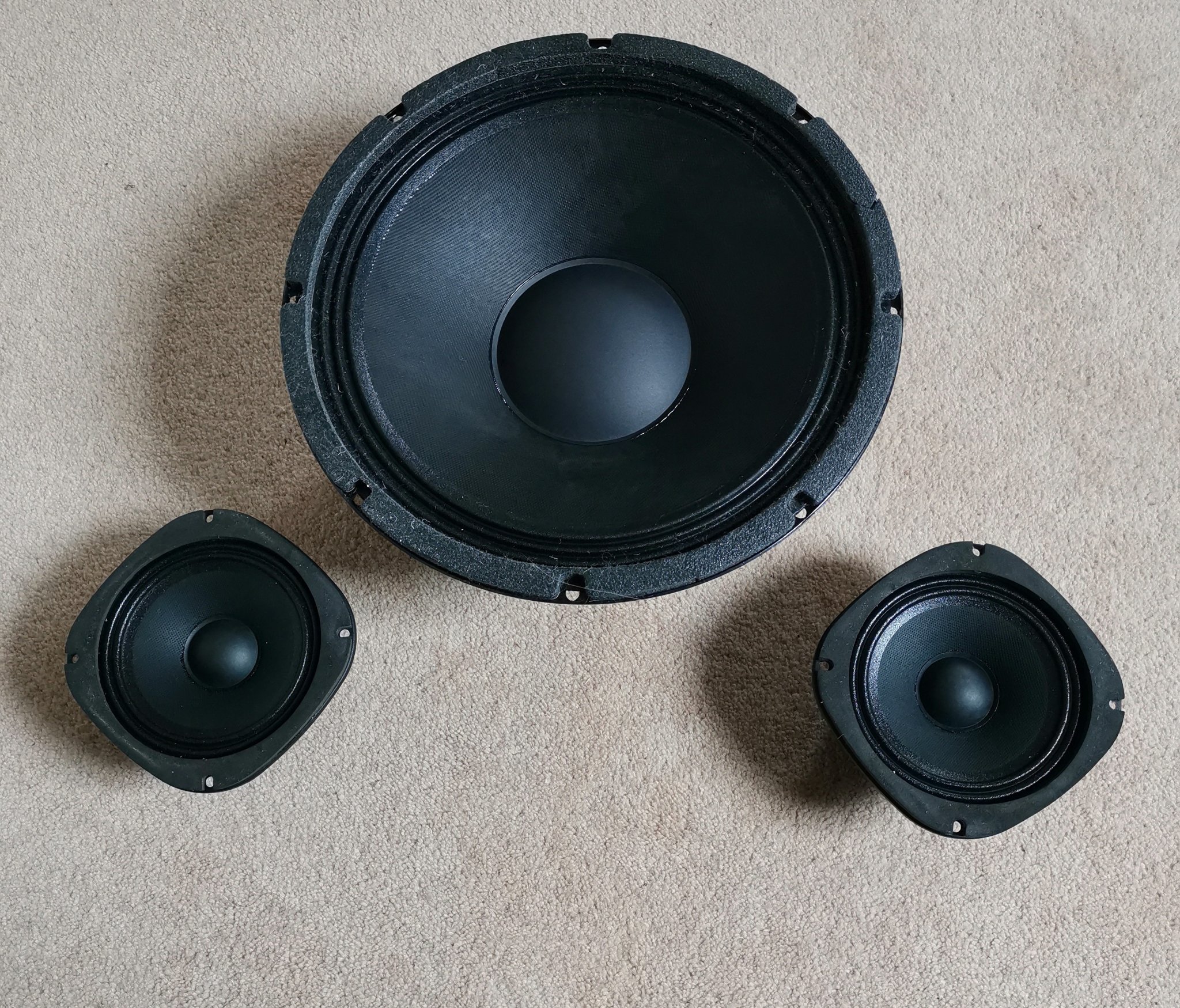

Having made the screw on adapters I couldn't resist going back to the BMS 4550 drivers again.
Spent a little time measuring and setting them up.
Easy as the LF and MF did not need to change at all.
I settled on around 900Hz 1st order XO in DSP for them. Not fully settled on that yet though.
Meshed best with the MF like that.
I'm actually quite enjoying them this time - there are some times when they come across as a tiny bit harsher.
Perhaps a little more careful EQ could fix that?
However general listening is pleasant, clear, dynamic and well balanced.
