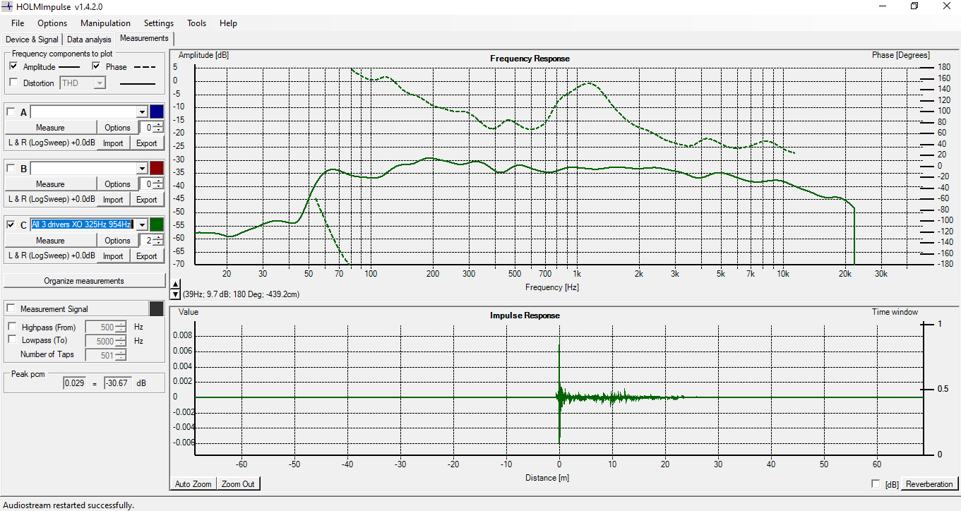

I then did a quick dial in, very easy to do in Najda DSP.
Set up the X/Os, quick time / phase alignment to the tapped horn.
Dialed in the SPLs.
Notch PEQ on the BMS 4550 at 2200Hz
I will spend much time dialling in, trying different X/O slopes. Aiming for nice phase plot.
Quick setup plot from the listening position.
(Ignore the 25Hz bump, that's the tapped horn - it's the way I like it, gives huge scale and energy to church organ and electronica etc 🙂).
The trail off of HF really isn't noticeable from the chair! There's relatively speaking plenty of HF action, for me!

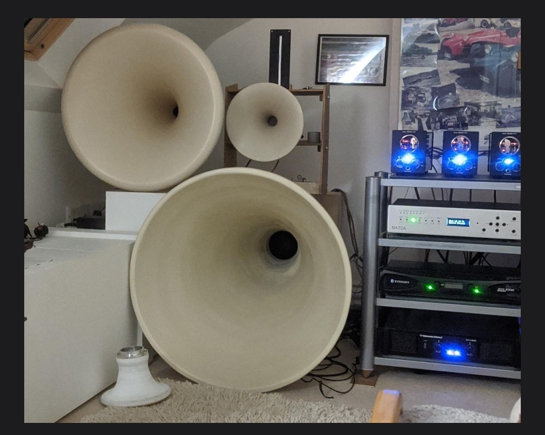

This is what my SH50 alike is up against..
Old pic - now painted black..

...Quick setup plot from the listening position.
The trail off of HF really isn't noticeable from the chair! There's relatively speaking plenty of HF action, for me!...
That's a lot of downslope, even when measured at the LP.
I've found that measurements from the listening position (LP) always contaminate the phase response plots, and usually beyond recognition. So I place the microphone pretty much on-axis at 1m from the horn's mouth, and place plenty of temporary absorption material on top of anything acoustically reflective in-room that's within 2/3 m of the mouth. Suddenly, the phase plot gets much, much better, and I don't try to EQ any frequencies that have really non-flat excess group delay (indicating it's likely a room early reflection instead of a minimum-phase behavior from the loudspeaker itself).
Also, by measuring at 1m, you no longer have to use any downward-sloping "room curve" when measuring at 1m. Just EQ it to flat response at 1m, and by the time it gets to your LP, you have your room curve perfectly.
Measuring on-axis will get you an accurate reading of your high frequencies above 13.6 kHz (the frequency at which a half wavelength fits across the 1" horn throat diameter, and the frequency where the 1" horn/driver start to beam. It you don't try to boost those frequencies above 14 kHz due to measuring off axis above the beaming frequency, then you should hear a much more smooth sounding resulting balance.
I think most people are used to taking the measurements at the LP (like "room correction software" does) but fail to see what happens when they do this. That firmware usually screws up the 100-300 Hz band, attenuating it too much for fully horn-loaded loudspeakers having directivity control in this region.

Yes, it's very interesting comparing 5 way trad horns Vs 3 way + sub of the synergy.

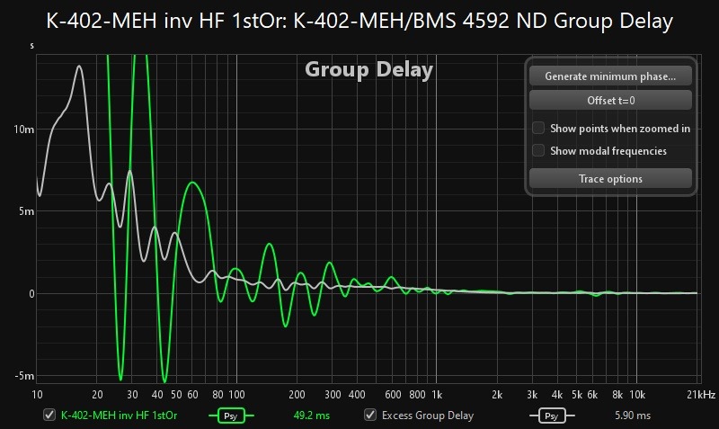

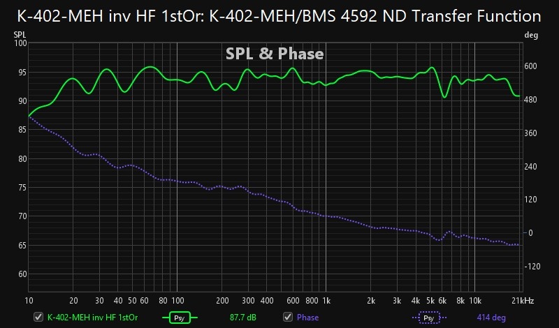

The good thing about MEHs is that a simple set of first order crossover filters--that uses the first cancellation (notch frequency) of the lower frequency drivers as the low pass crossover frequency--will always provide time-aligned settings that is a hallmark of the MEHs that Tom Danley promotes ("unity summation aperture").
First order MEH crossover settings produce a quasi-linear phase response (or should I say "minimum phase response" in the case of MEHs) of the lower frequency drivers mounted to the horn (midranges, woofers) without the creation of significant excess phase (all-pass) or large spikes and delay offsets in the excess group delay plot--all of which are audible. They actually need the 90 degrees of phase shift of a first order set of filters to time align the lower frequency drivers, which are closer to the listener, to the higher frequency driver.
Chris

I didn't have much time to play around today.
I changed all X/Os to BW 6dB and tried the tap frequencies of 325 and 954Hz as the points to cross at in Najda.
Removed all PEQs, set the driver SPLs more evenly to balance.
Then played around with the X/O points to smooth the phase a bit.
Then added some PEQs (not much really).
This gave the result below.
Can't seem to get that phase hump down..
Or get the bass phase to flatten out.
