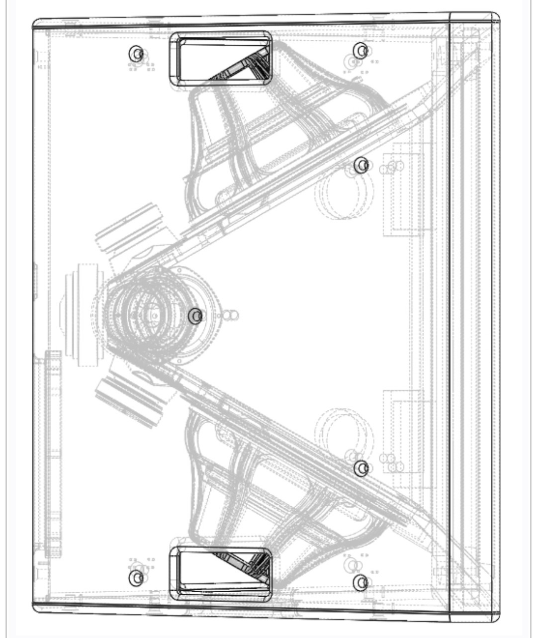

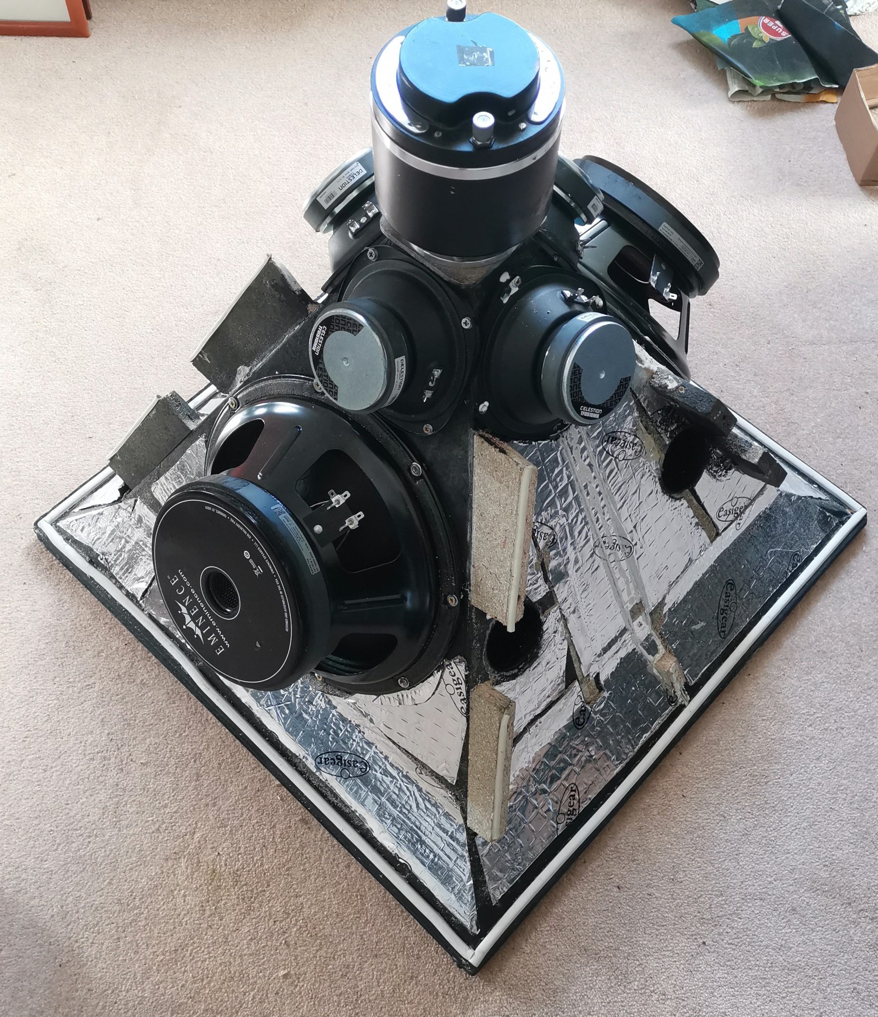

I reproduced the placement and sizings.
There is a passive setup in the real SH50s. Not sure what is X/O and what is notch filter, L-Pad etc. It's a work of art.
Your can also order a DSP version and you get the data required to implement the DSP, I believe.
Doing in DSP is easy peasey in comparison.

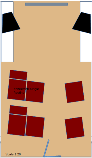

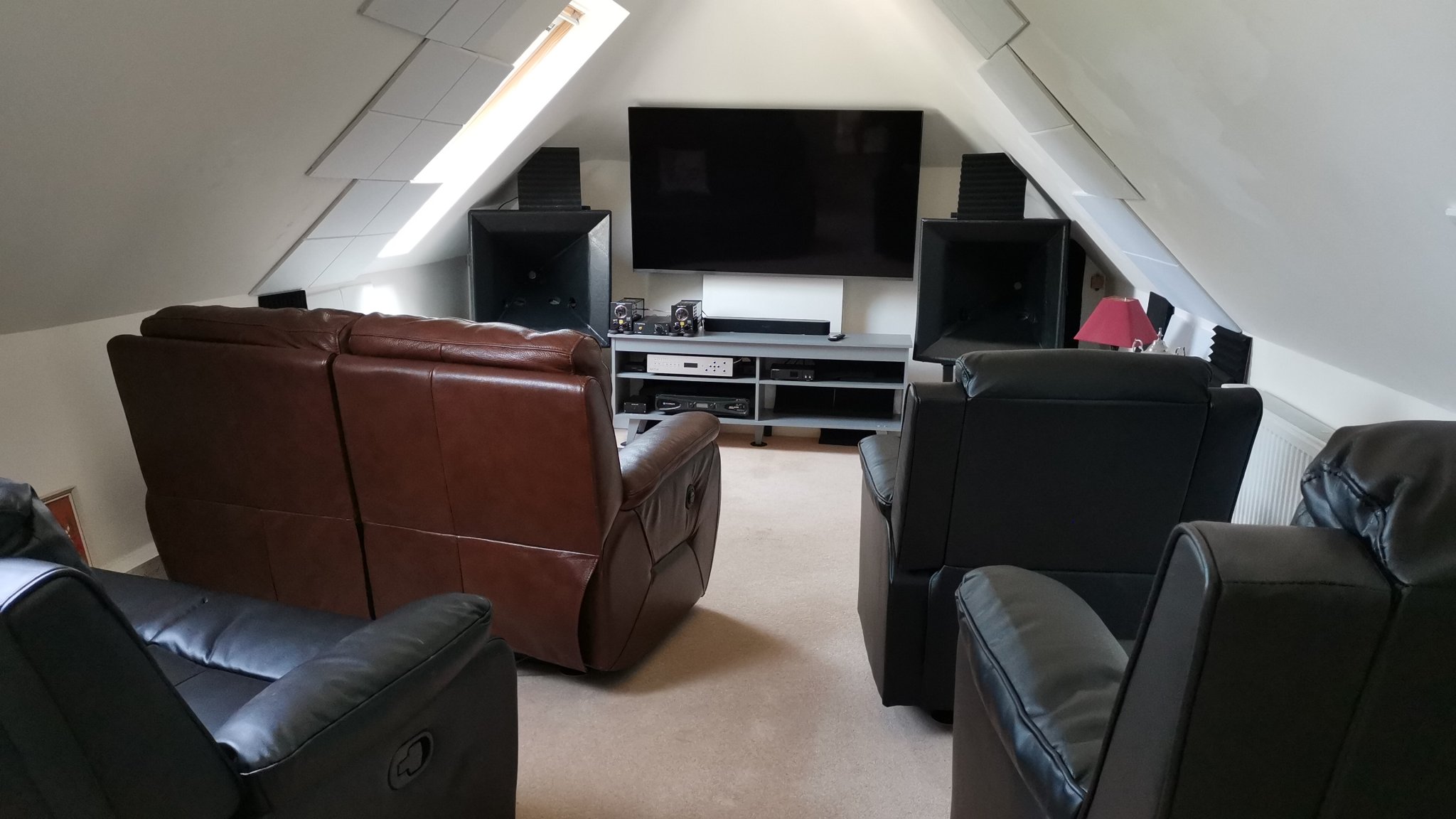

Recalling the schematic
Reality is finally catching up.
Got the 2nd reclining sofa in place now.
Screen is up and single hifi rack replaced by a low unit.
Room decluttered.
The screen looks quite small in the pic, but it's quite big in reality.
The front seats look nearer than they are too.
There's enough room for all to recline.
With the rear seats on 8" platforms, the view of the screen is unimpeded.
All seats see both horn inner sides, so you hear both pretty well.
It's fine for Cinema. Most action is the centre and the tapped horn subs😈
For hifi the front sofa moves out parallel to the side wall, as does the front recliner.
Can then either have the 2 seater sofa in the middle or full selfish single mode - rear sofa also to the left side wall and front recliner in the centre as near or far as you like.
We're having a great time watching movies and the whole family can enjoy the room.
Hifi wise it all sounds as good.
The SH50s move forward on aluminium channel rails nice and easy. Have then 3ft to the front wall.
I can also easily try different positions, 1ft, 2ft etc.
The sofas are on those Teflon slider feet pads, quite large ones.
They are great!
Makes reconfiguring the room a cinch.

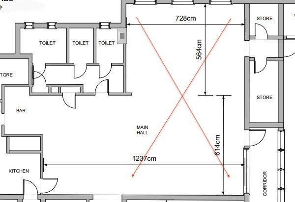

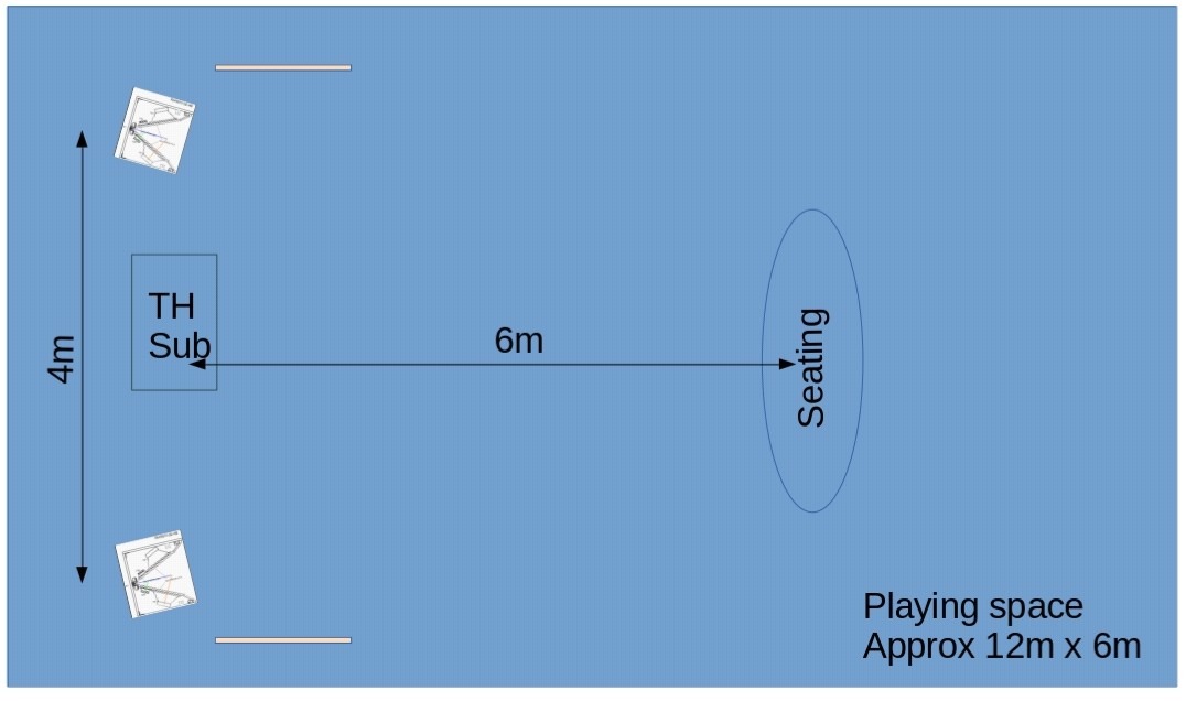

Come September I'm going to be taking the Danley SH50 alikes to a small / medium sized hall for a hifi event.
I'm quite excited about it..
I need some advice on where / what.
The room size is
About 12m (+ bar) X 6m plus the north wing of 5m X 7m.
I would estimate the height of 4 or maybe 4.5m with a nice curved roof.
Not sure which positioning is best?
I can't take my tall narrow tapped horns, so was thinking to make a big Lab12 sub 60" X 38" X 14" or so, to do below 60Hz odd.
I intend to raise the SH50s up about 1.5m but could perhaps go higher?
We don't need ear splitting PA volumes.
It's a hifi gathering.
90bB at the back should do it.
There won't be that many people there, maybe 50 or so (estimate).
Questions
Will a single sub be enough?
Is 1.5m up high enough?
Which positioning in the room would be best? I might not have control of that though..
What volume to aim for? 90-95dB in my mind as max.
Will one LF driver and 2 MF drivers be adequate per cab, out do I need to go full Danley and add to get 7 drivers?
(I knda want to do this anyway at some point 🙂)
I thought to get a cab down as is, and measure / listen in the garden, off the ground and see what i get at 10m distance.
So many questions, it's all new to me..

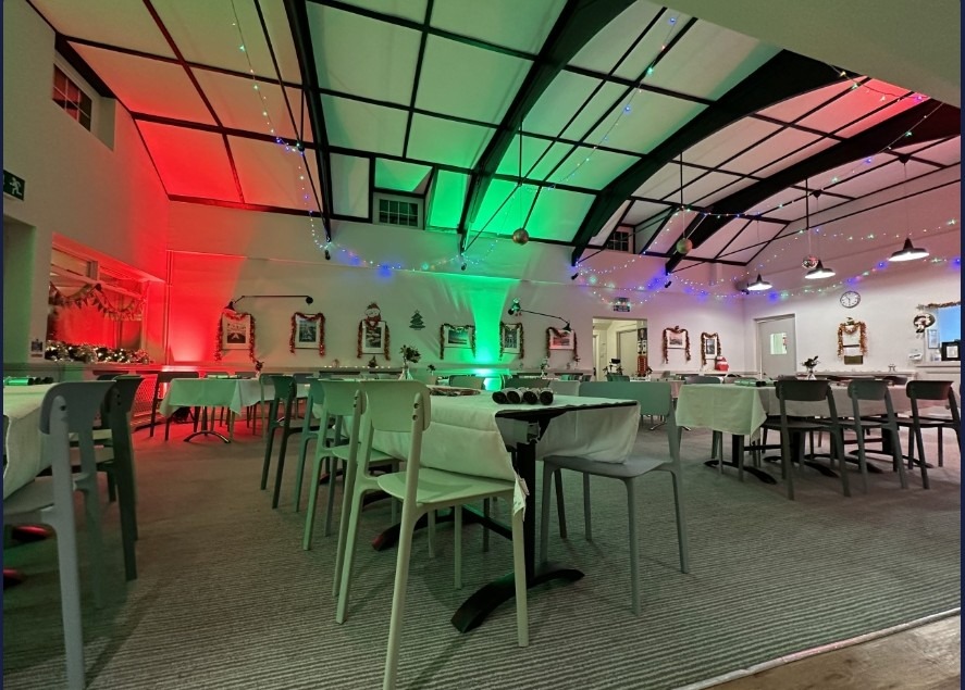

I did take a 5 way, 45 degree conical, front loaded horn system to a similarly large room 12 years ago.
But Synergies are a bit less efficient.

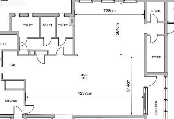

The room size is
Questions
Perhaps, but a single sub will leave significant areas of the room without good low bass coverage in the "antinodes" of the room modes.Will a single sub be enough?
If everyone will be standing, then maybe a little bit higher. If everyone will be sitting, then aim for ITU-R-BS-775 height of 1.2 m (~47 inches) to the centerline of the horn:Is 1.5m up high enough?
Across the 728cm dimension would be my suggestion, since they will image quite far apart. The issue will be how far apart you spread them, since they only cover about 50 degrees horizontal/vertical, and a hole in the middle may become an issue. Since you haven't talked about nearfield acoustic wall treatments, simply pulling them away from the side walls by about 2m will suffice, but the downside of this is loss of bass below ~120 Hz.Which positioning in the room would be best? I might not have control of that though..
Depends on the music played and the distance the listeners will be to them. A 90-95 dB (max) figure might be a little low in the peaks if you are playing very dynamic music. However, if you are talking about average SPL, then I'd say that will be sufficient, if a little high.What volume to aim for? 90-95dB in my mind as max.
You've got plenty of efficiency for those two drivers to cover at or below 105 dB/1m, so don't sweat it. More midrange driver penetrations in the horn leaves you with less good polar coverage consistency in a very audible region (1-2 kHz).Will one LF driver and 2 MF drivers be adequate per cab, out do I need to go full Danley and add to get 7 drivers?
Good. Anything to increase the volume of the covered space over your listening room will provide additional insights of the sound coverage and quality in a larger venue.I thought to get a cab down as is, and measure / listen in the garden, off the ground and see what i get at 10m distance.
Chris

A "nice curved roof" may be a "horrible parabolic reflector". The direction of the curve makes a difference..About 12m (+ bar) X 6m plus the north wing of 5m X 7m.
Roof issues aside, I'd opt for the upper left speaker positions to avoid bar chatter and toilet in/out.Not sure which positioning is best?
Speakers next to the side walls reduces side wall reflections (and frequency response "comb filtering") but
with only 50x50 coverage, will leave a "hole in the middle", the wider the speakers, the further back the front seats should be placed.
Standard PA advice: Rig the cabinets high, point them at the last seats.I intend to raise the SH50s up about 1.5m but could perhaps go higher?
I'd suggest elevating the bottom of the cabinet above head height, axis angled down to head height seated position in the back of the listening area to reduce the inverse distance level variance.
Outdoors, the -6dB for each doubling of difference from one to 10 meters is 20dB.
Same ratio as 1/100 watts..
Indoors, the direct sound drops at the same level, but the ratio of reflected sound increases, so SPL does not decrease uniformly, especially below the "Schroeder Frequency".
Every position should have a clear view of the HF driver, or they will be hearing more reflected than direct sound.
Moving the front seats back a few meters reduces the inverse distance variance considerably in this size room.

I found a pic of the hall.
I assume this is taken from the end / area that is the proposed speaker positioning, if I read the cues right.
Looks like that area has a much lower flat ceiling, plus it isn't carpeted as the area under slightly curved roof.
The tables will be gone and the seating re-arranged.
Fun and games.
Fun and games.
Taking some inspiration from a few pics on the internet like this
This shows how high they mounted the SH50s (with standing in mind).
I'm enjoying planning.
Something like this.
(Dims are approx)
I have no idea where to place the TH sub though.
I can have a MF / HF frequency absorbing panel each side approx 4' X 3' in size, at speaker height. Can be nearer than in the schematic.
Also found these rather cool reveal drawings - could be useful to have printed out on the info stand - so folk can see what the innards are like.
Might open some eyes!
(Dims are approx)
I'm still toying with at least a 2nd LF per cab 🙂

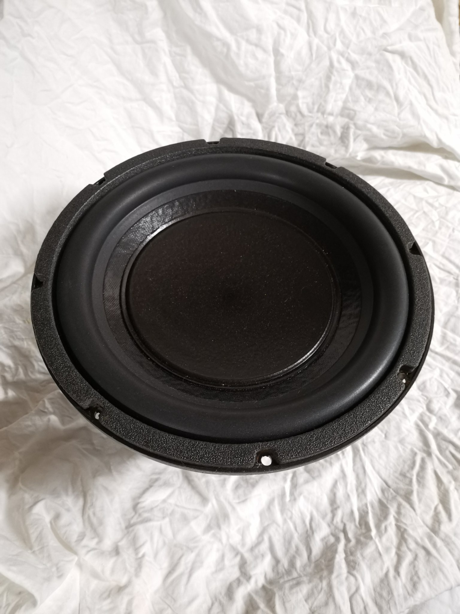

I found two very nice used Eminence Kappa 12As, couldn't resist, so I will put them in.

Exactly the picture I was looking for, note how the down angle is pointed at the back seats, and the mains are a bit above head height. People in front will be in the -6dB coverage range, further back will be on axis, making up for the distance loss in level. Get it right, and coverage can be within +/-3dB for most of the venue.This shows how high they mounted the SH50s
Centered between the mains is OK, but put the sub (and the mains) against the back wall (rather than as you depicted it) to avoid a deep boundary reflection cancellation, AKA "Speaker Boundary Interference Response". Depending on the depth of the TH, it may work better with the mouth, rather than the back of the cabinet against the wall.I have no idea where to place the TH sub though.
http://tripp.com.au/sbir.htm

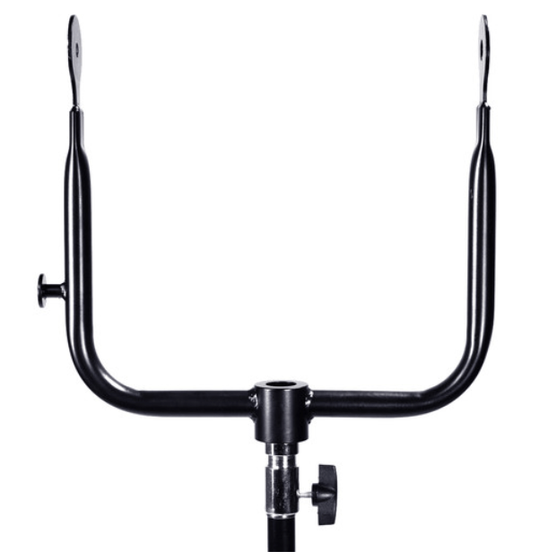

Global Truss crank tripod lifts work well for elevating heavy speakers such as yours.
You'll want to install rigging bolt receivers at the center of gravity of the speakers so you can tilt them using a yoke:
Rigging is not to be taken lightly, no one has ever been killed by poor sound, but too many have been by bad rigging.

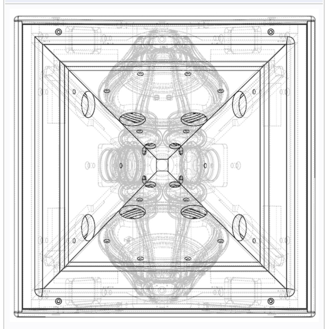

The 'full on' project is progressing.
Here is the Christmas tree DIY SH50 (full complement of 7 drivers).
All went pretty smoothly.
Trial fitting
This lot weighs 37.5kgs.
The rear chamber weighs 20kgs.
The best bit with this format is it obviates the need to to halve the rear chamber volume.
This simplified things.
It also massed up the cabs!
I took the opportunity to use the 6 bolt securing method - ala Danley.
Long bolts through the rear and into the horn section secured by threaded nuts.
This is a much more superior way of locking the two halves together.
I also have a screw in each corner just to pull the rear onto the sealing gasket.
Initial impressions are good.
Just plonked down with no DSP filter changes, the tonal balance is still fine.
Turned up the bass but also the mids have apparently taken on a new authority, but the delicate stuff is really nice too.
I was a bit worried the extra MF taps might mess the HF up somehow - need not have worried.
Perhaps it's all in my head🙂
Sure looks the part with 4 LF taps and 4 ports!
Of all my DIY creations I really love these MEH horn speakers.
They do do much right and so little wrong!
