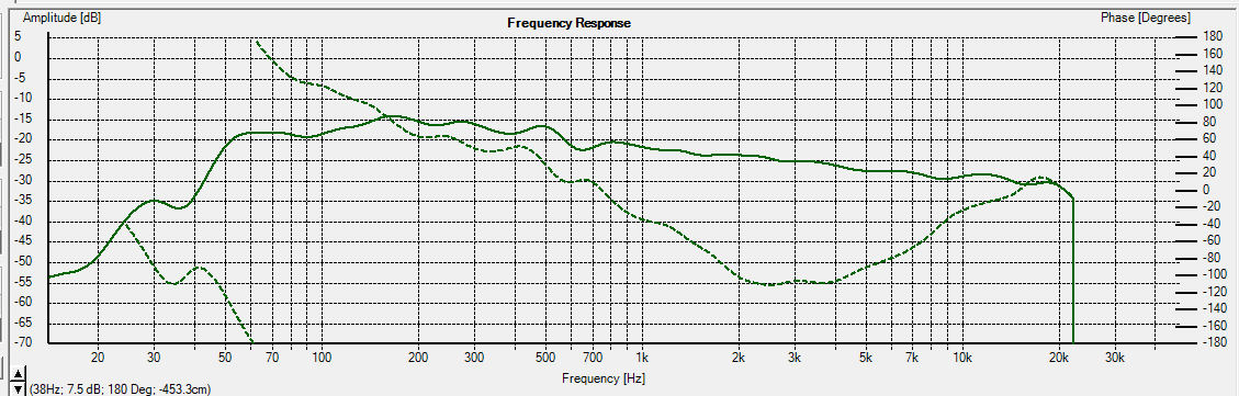

When setting up my crossovers on my MEH's I found the EQ window in REW was really useful. You can plot a (4th order) target curve and then setup your 1st order slopes / parametric EQ's to match it.
This is my measured BMS4550 response, with the EQ filters I use.
That is how I end up with the acoustic slopes - I tried REW and Open Sound Meter getting very similar results. A combination of PEQ and various textbook crossovers to match a target curve. Maybe it is correct, since it sounds pretty good, but I keep getting weird impulse and step responses, so I think I am still missing something - I need to think about it more. Eventually, one day it will snap in🙂

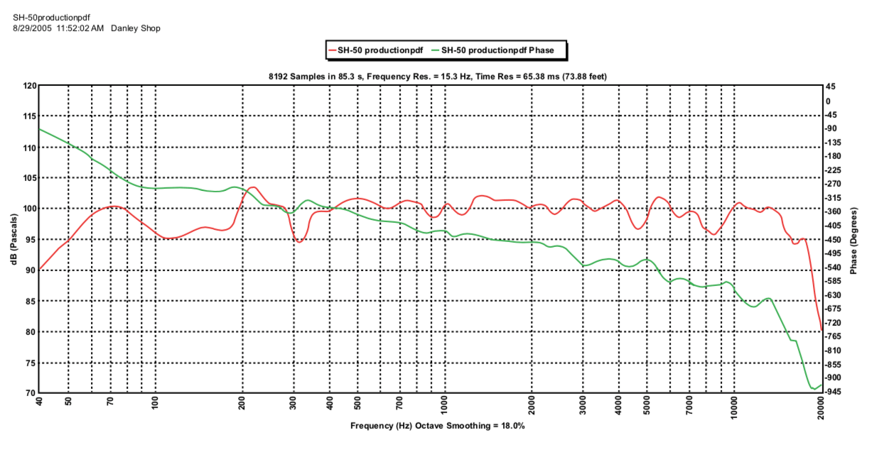

Over the range of 50Hz to 18kHz, the DSL SH-50 has smooth phase response, but over 600 degrees of phase shift.
As Mark mentioned, definitely not 1st order slopes, acoustically or electrically.
Art

My experience with my SH-50 indicates only first order electrical slopes (i.e., not fourth order) as evidenced by the induced phase shifts of the electrical filters through crossovers, combined with the natural acoustic rolloffs combine to achieve something more like ~10 dB/octave total slope--which is nothing like 24 dB/octave that you would get with a 4th order crossing. There are considerable frequency overlaps between drivers in their transition bands.
The crossings even include the rise in response of the woofers and midrange between their first and second notch frequencies--which was a big surprise to me when I measured it. The crossover design actually looks more like a phase link design with a very narrow midrange passband of just over an octave, but with considerable attention paid to the phase responses across the transition bands.
I think if others measured an SH-50 directly (like me) to see the effects of the separate acoustic responses without cross electric filters and then with the electrical filters in place, they would be talking about other subjects than higher order electrical filters. The reason why one uses higher order filters in multiway loudspeakers is basically not present, so worrying about minimizing the width of the crossover interference bands is not relevant in an MEH which experiences "unity summation aperture" of its multiple drivers. This is the point the Danley wrote at length about in both relevant patents: US6411718 Unity patent and especially in US 8284976 Synergy patent.

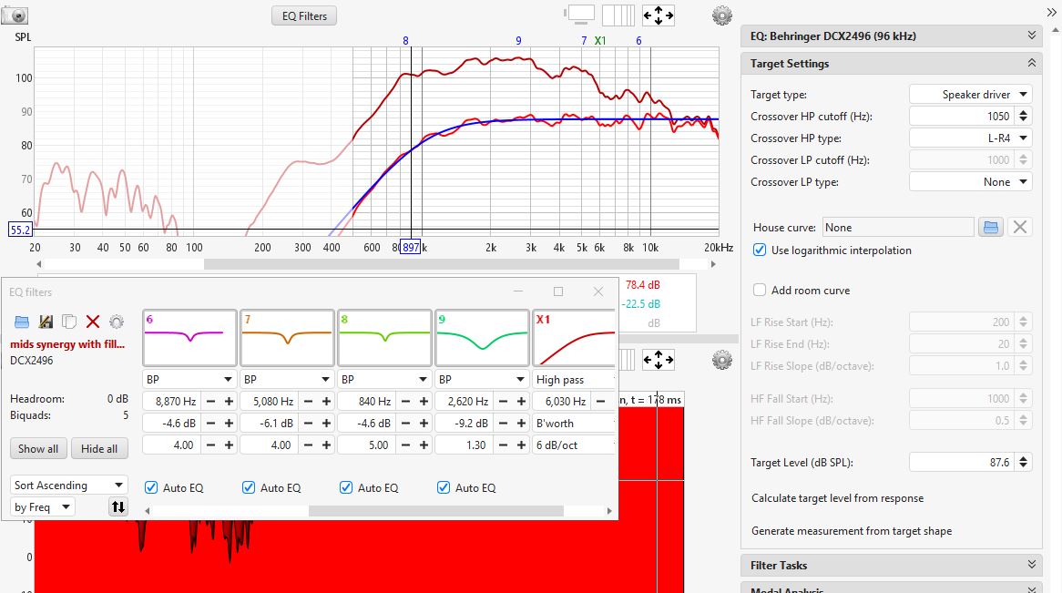

Try removing the low-pass crossover filters while retaining the first order high-pass filters you have present, then trim off the low-frequency response of the higher frequency drivers in each case via PEQs until flat amplitude response is achieved across the crossover transition bands. This will ensure that the drivers are within 45 degrees of time alignment in their crossover bands.I will try a higher X/O freq on the HF next.
Also, if you have enough remaining output channel PEQs (biquads), add attenuating PEQs above the first notch frequencies of the woofers and midranges to attenuate their rise in response above the first notch frequencies. I found that I had to add attenuating PEQs above both the first notch and second notch frequencies.

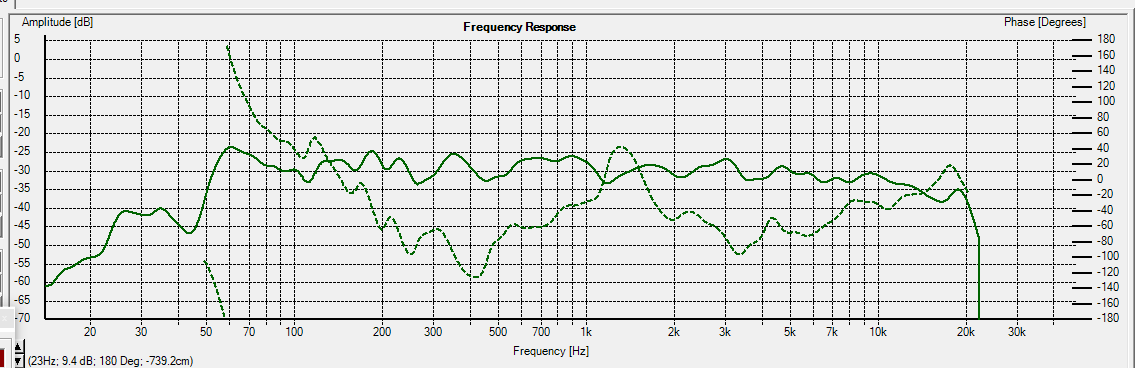

I'll have a look at my mids measurements later, I'm sure they have a natural 4th order slope, or close to it.
If you look at the image I posted in post #21 regarding crossing my 4550 CD you will see a 1st order highpass at 6k , with some PEQ's to get a 4th order acoustic roll off at xo. This kind of agrees with your 'use a 1st order highpass and some PEQ' suggestion in post 32.
Rob.
edit : my mids have approx 6th order acoustic slope at their low end (250hz and below), with approx 3rd order slope above 1k. Add a 1st order electrical low pass at 1k to get a 4th order acoustic slope. I use PEQ on the low end to turn the 6th order slope into a 4th order slope, crossing closer to 350Hz. So my mid to tweeter slopes are both 4th order acoustic slopes, using 1st order electrical xo's to get them.
Thanks for the explanations and clarifications, very much appreciated.Try removing the low-pass crossover filters while retaining the first order high-pass filters you have present, then trim off the low-frequency response of the higher frequency drivers in each case via PEQs until flat amplitude response is achieved across the crossover transition bands. This will ensure that the drivers are within 45 degrees of time alignment in their crossover bands.
Chris
All low pass off.
Worked away on PEQs (not sure Najda has a limit, I'm only at 45% processor load set on 96KHz).
Some small changes had a quite big effect on that line esp the steep rise at the very high frequencies.
No matter what I do, the dip bottoming out at 3KHz is stubbornly persistent.
Didn't have time for a go at the LF rise this evening.
Seeing changed PEQ settings and the subtle effect they have on phase is new to me.
The overall sound esp, HF is now much more refined. Giving the other side a run for its money!

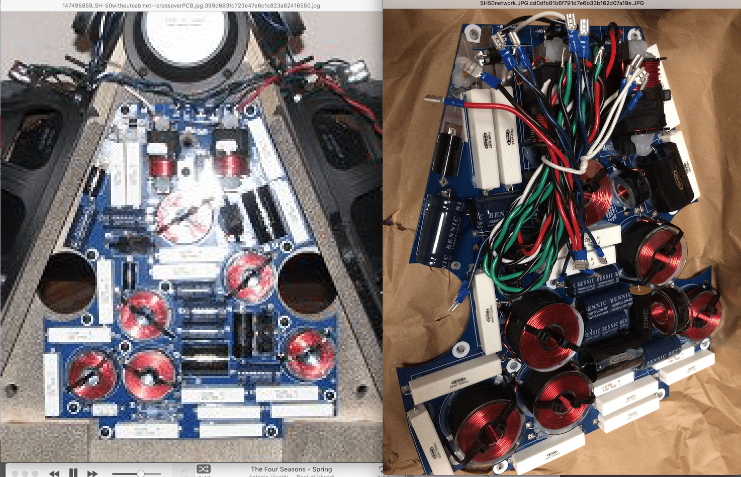

With at least 10 inductors and 9 capacitors in the SH-50 passive crossover, there is a lot to dissect.That's my take too on the SH-50 too, without having one to dissect.
Looks like something a bit less than 2nd order acoustic is achieved with each of the two xovers in play. Nice.
Hefty.
With the SH-50 being a three-way, it has its fair share of irregularities in amplitude (SPL) response that are mostly compensated for with a series of notch filters in its balancing network (intended for full-space acoustical loading). I believe that's mostly what you're looking at.
Chris
