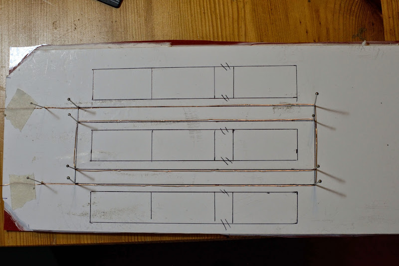

It's Voodoo time
Time to test the pin idea:
Placing the pins where the wire shall change direction:
Wound one turn:
The wire is not fresh from the roll, so it is hard to get a straight line.
Some other angles:
Applying the first pieces of 74 film:
Turned out (sorry) that the piece of wire I tested only lasted one and a half turn, the coil is supposed to end and the top left pin.
Taped it all and removed the pins:
For the real deal I must be more careful to get the wire in the correct position.
I don't know if the 74 film is the most suitable tape to use. Maybe some resin or glue would be better.

Full scale VC measurements
The lower VC is inserted in a cut-out of the foam, so that VC is ideally one mm high on its travel on the membrane between the magnet systems.
But the foam became flexible with the cut outs, so that method is ruled out.
This VC has four turns and a resistance of 3,99 ohm and an inductance of circa 50 uH.
The upper VC is a horizontal, one mm wide VC. Is is taped down with the 3M 74 film that bonded really well after a couple of hours.
Being horizontal the force from the VC on the foam will be better distributed and the Xmax is 0,75/2 mm more than for the vertical VC.
Although a vertical VC would be preferable as it should even out force field in-linearities.
This VC has three turns and a resistance of 2,99 ohm and an inductance of circa 33 uH.
So it's one ohm a turn, which is according to calculations.
But I don't know about the inductance, are the values within the expected range?
The VC is placed on the membrane which is illustrated below as the long horizontal line.
The view is from above, so upwards in the picture is forwards in reality.
The arrows visualizes the membrane's movement in the gap.

You could use adhesive 3mm alu and isolate the crossing "wires".
Then I lose 2,5 mm of Xmax.Maybe using both sides of the foam: front and back.
I was thinking you could use alu foil on both sides to get thinner membrane and avoid cutting in the foam .Might be possibly to avoid crossing alu foil using both sides.
Hope you understand my idea.It is difficult to explain in Words and even worse in a foring
languge.
Bernt

Oops, that sounded a little harsh.I understood your suggestions perfectly but I have actually dismissed them earlier based on the reasons I stated in post #95.
![ashamed :ashamed: :ashamed:](https://files.diyaudio.com/forums/images/smilies/ashamed.gif)
I meant that I have considered such solutions earlier, your suggestions are of course brilliant as always so just keep 'em coming.
