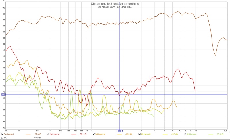

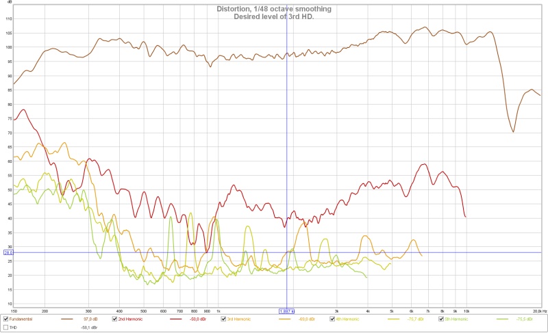

What is your max k2 and k3 target? What would you be satisfied with?
I don't think that -60 dBr for the 2nd HD
attachment.php
and -70 dBr for the higher orders are unreasonable goals.
attachment.php
But want I really want are "smooth" distortion levels without any humps.

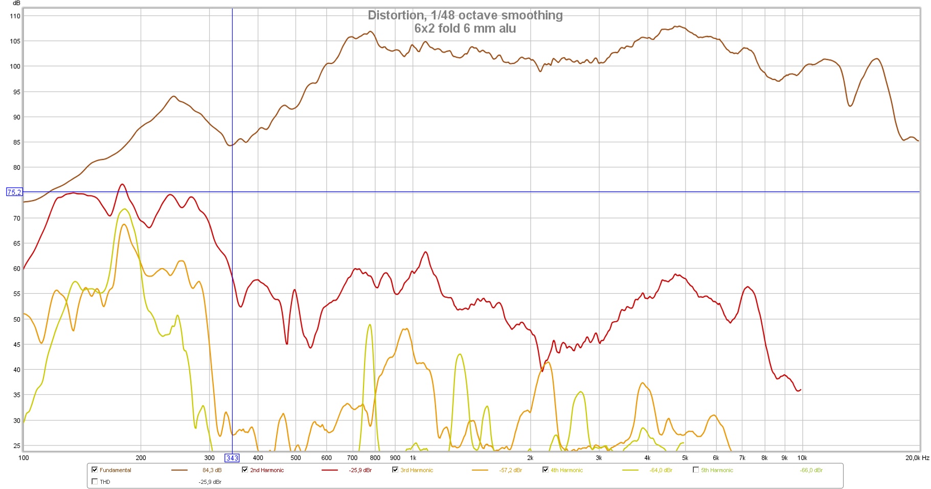

Next try is a 6x2 mm pocket with 6 mm aluminium stripes.
But that was also a lost cause; worse LF, worse HF - a bumpier SPL than ever.
attachment.php

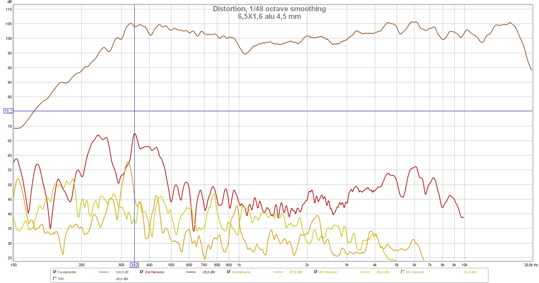

When comparing with the old 6,5x1,6 with 4,5 aluminium,
attachment.php
the 2 mm wide pocket is not the way to go.
So I just have to try to make a better 6,5x1,5 membrane and work to get the LF and HF 2nd harmonic distortion down a bit.

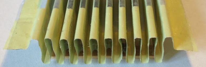

Some more DC tests shows that it is only the outermost pockets that visible moves even at a high current for the "all alu" membrane (6x2 mm, alu 6 mm).
Looking at the membrane it is obvious that it is only the outermost pockets that have bare mylar (half a pocket after/before the initial/ending horizontal section) and that is where the large signal movement is.
This is the end of a 10x2 membrane with "al alu":
attachment.php
For high current that is. The innermost pockets are of course also moving, but they have a stiffer suspension; only the folds'.
So it is then not a surprise that a "all alu" membrane have the above response curve. The outermost pockets have a totally different compliance.
