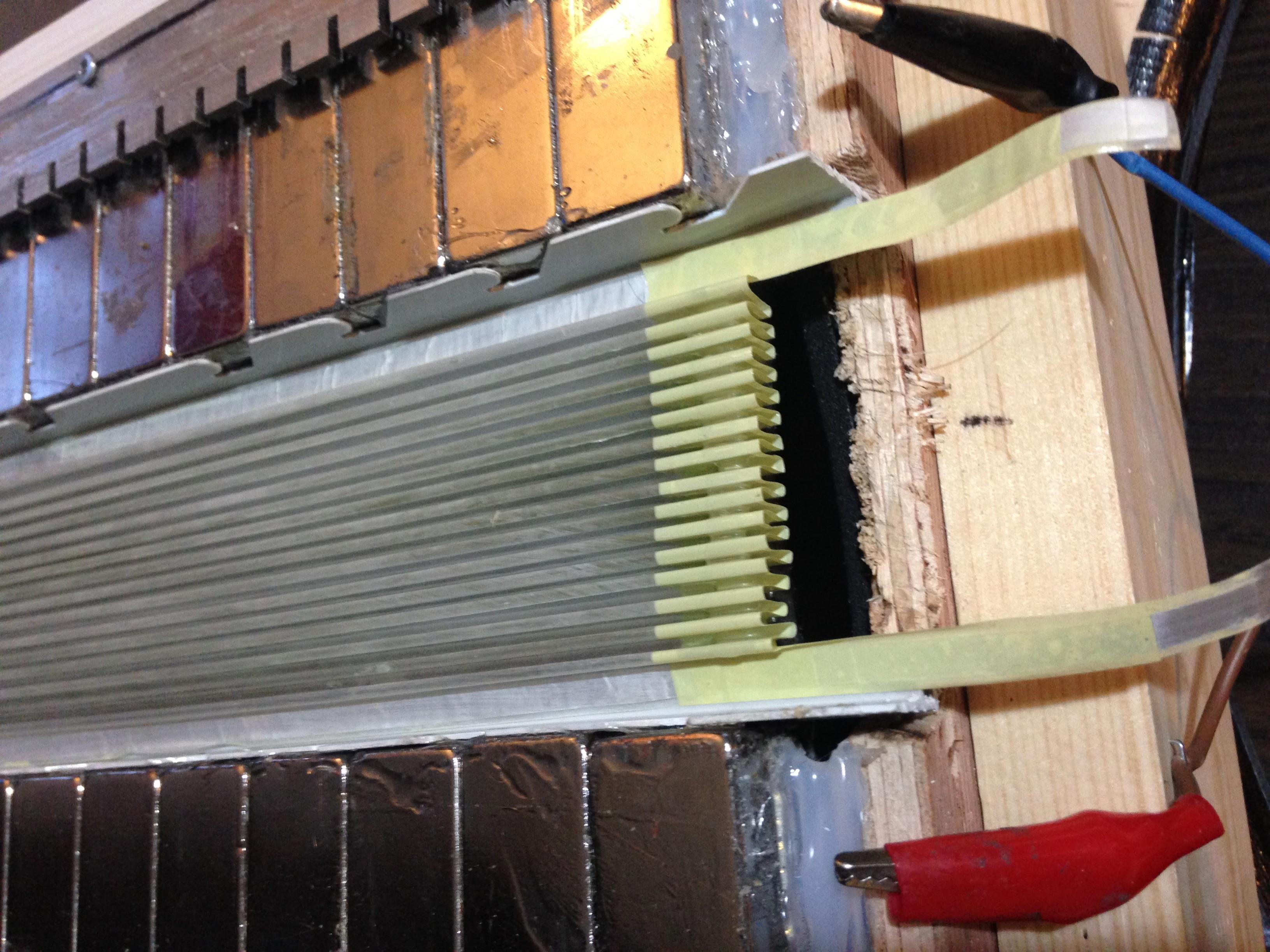

Back to the old membrane design (6,5 mm deep and 1,6 mm wide pockets with 4,5 wide aluminium stripes) then but this time with a slightly modified folding tool that resulted a higher quality membrane with more even spaced folds and aluminium strips.

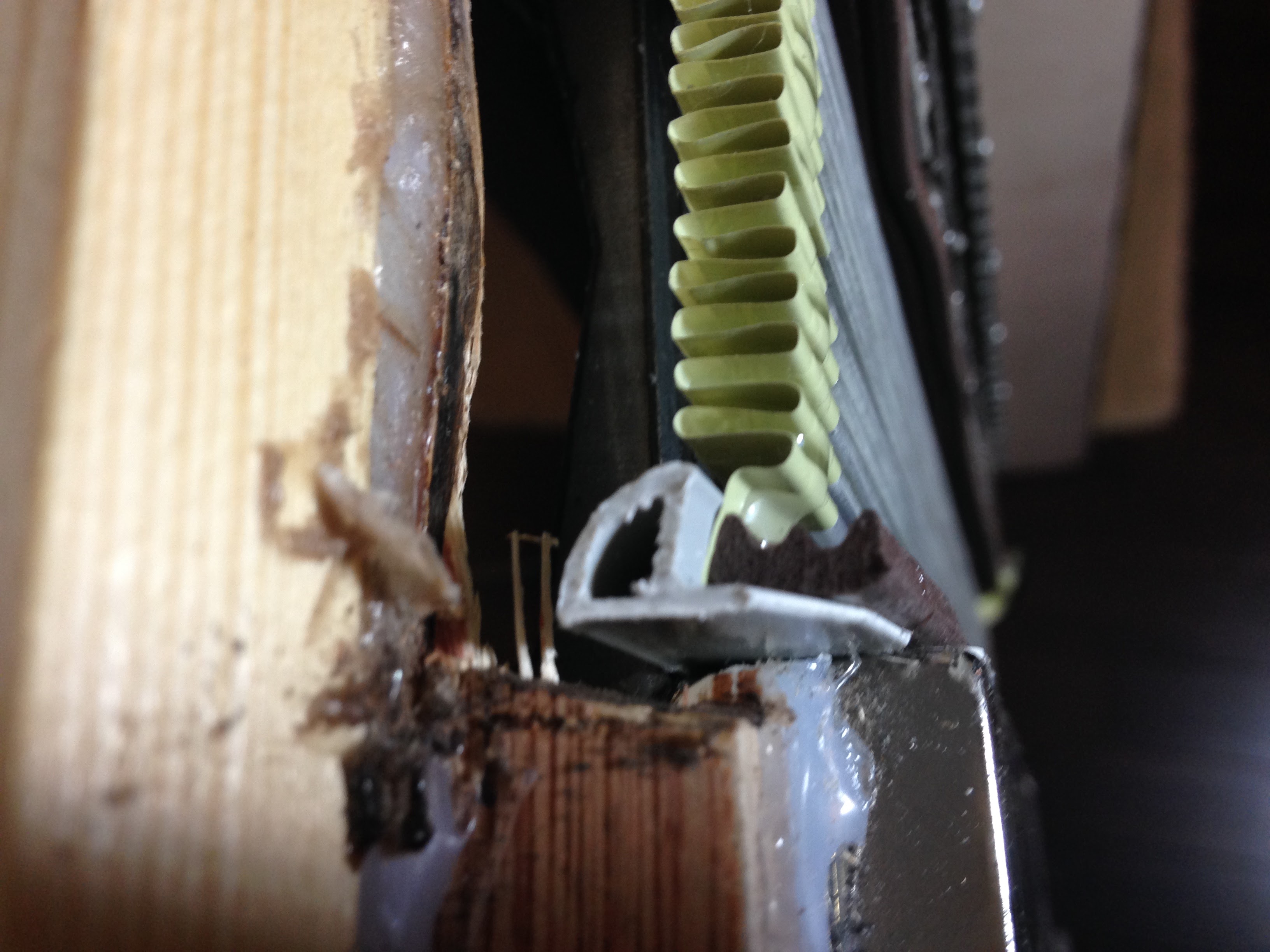

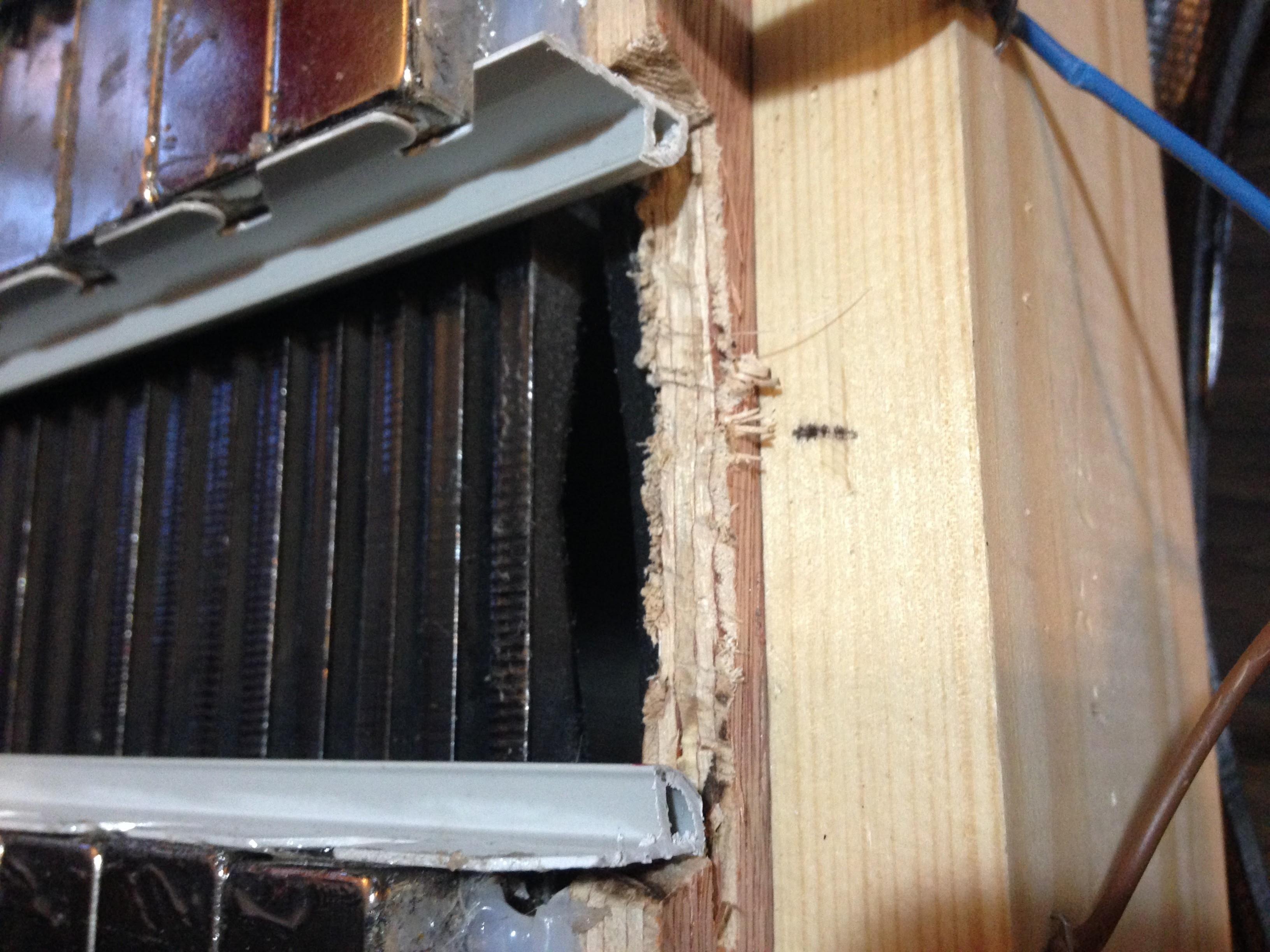

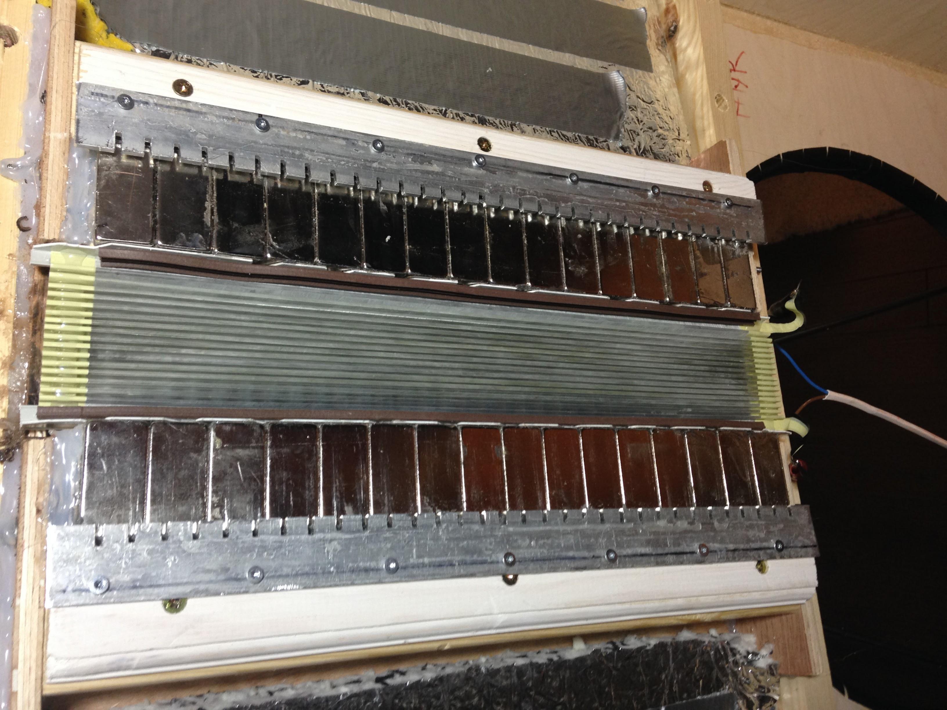

I'm trying to reduce the LF distortion. One idea is then to remove the membrane frame altogether. So I glued a plastic quarter-round base shoe to the magnets directly:
attachment.php
Then I glued the membrane in place, still no frame:
attachment.php
Put some sealing strip on the back, just to disturb any standing wave build up:
attachment.php
attachment.php

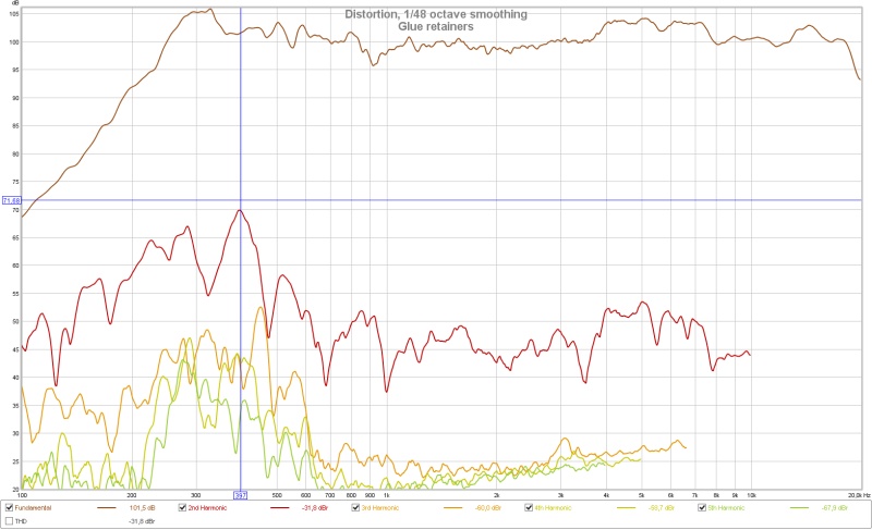

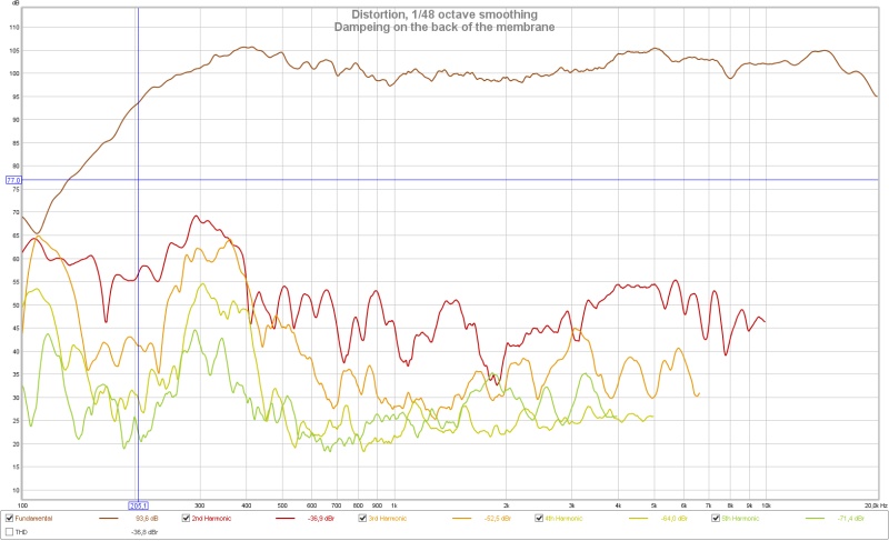

Apart from the high 2nd HD, this was a nice surprise:
attachment.php
Then I realized, there are no back pole pieces yet! Hmm...
So what about the 2nd HD. Just trying to set a tone where the distortion is high and then use REW's RTA or simply just listen lead this first mitigation:

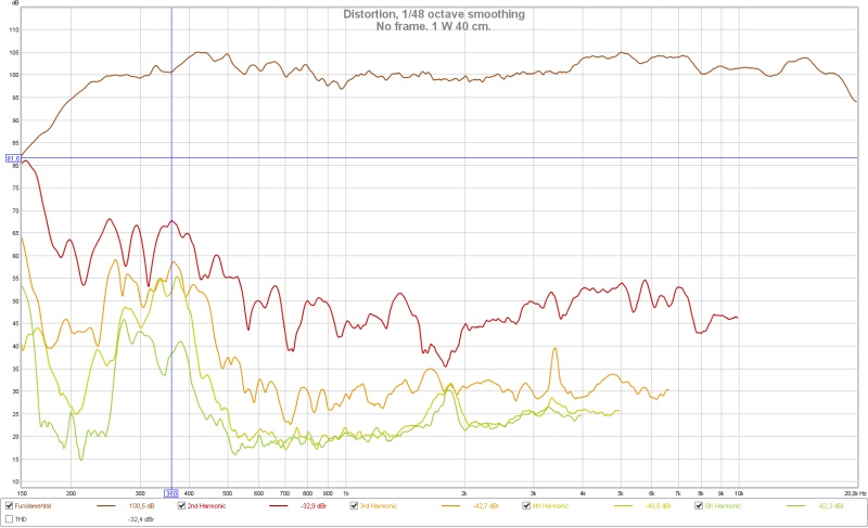

attachment.php
With this result, look at the distortion components below 300 Hz:
attachment.php

the distortion is shifting ? up.
i do the same usually nail the distortion and use the rta and fidl untill you see something happen.
btw you chose 6.5 mm because of the high roll of ?
Are the end of the membranes supported in any way or hanging in freely? you glued the sides into the motor but also the shorts sides ?
Did you stiffen the ends of the membrane with an extra tape ?
No, that's a mirage; the scales are different. What is happening is that the 2nd HD went down by 15 dB below 300 Hz.
Yes, it is a good method.
The membranes are suspended by a strand of Loctite Hybrib Glue on each side of the membrane's top and bottom.
The strand also keeps the pockets intact.
Just by the strand mentioned above.

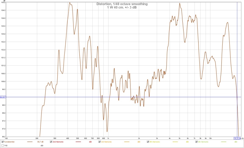

>500Hz = SOTA for 3:rd overtone. Congrats!
Yes, I was kind of surprised by the low 3rd HD levels.
The big susprise was the even SPL, the "acoustic" bevel is necessary in the gap (that is, the quarter-round base shoe) to avoid standing waves notches.
Within +/- 3 dB from 240 Hz to 18 kHz calls for no EQ!
attachment.php
Even if SOTA is acheived for the 3rd HD, the hunt continues for even lower 2nd HD.

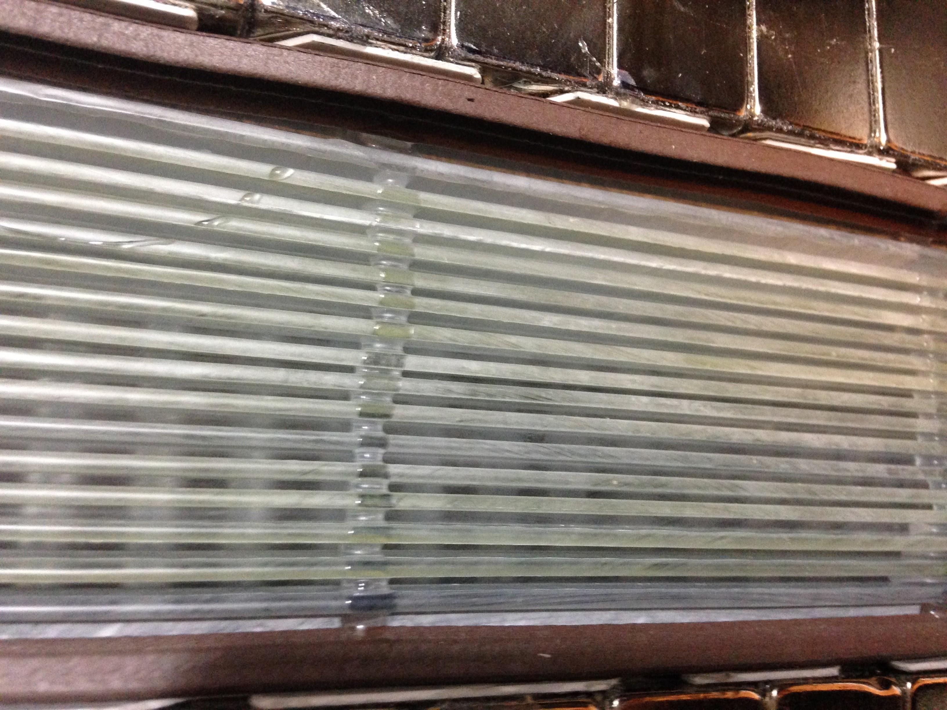

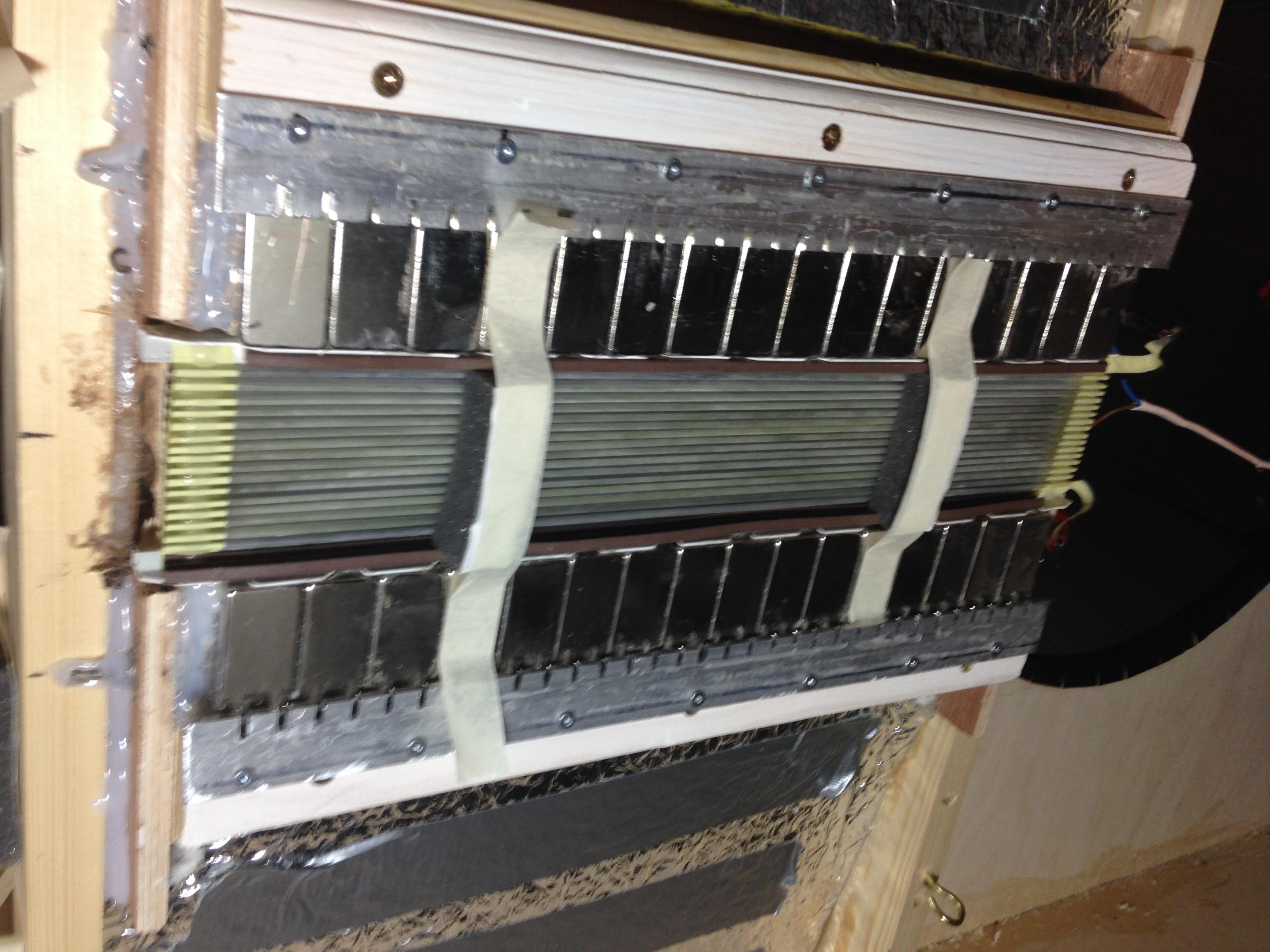

To make the mitigation above more permanent I put glue strands every eight centimeters. Only on the back of the membrane:
attachment.php

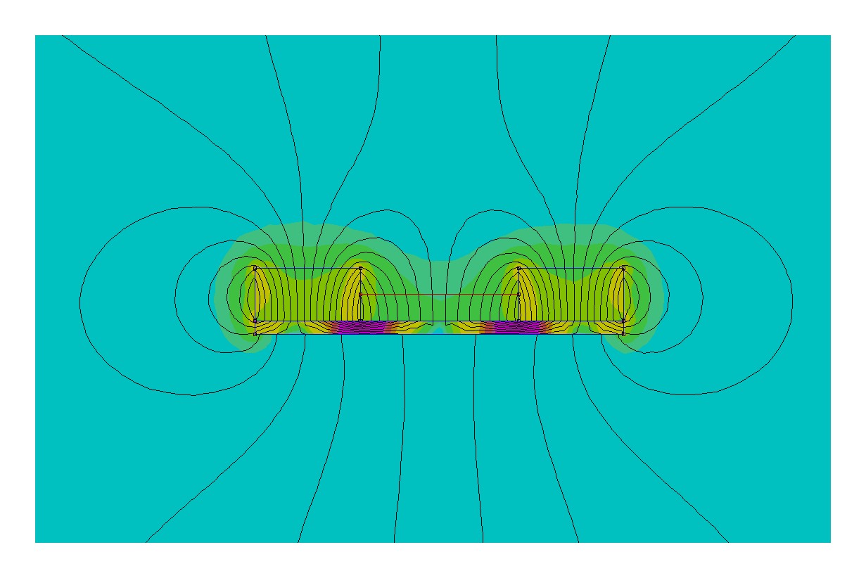

Still no back pole pieces, perhaps they aren't needed?
(Then båndsei was right all along :Ouch:)
I have been opposed to use retainers, but I don't think that they did any harm to the SPL. It is a little jumpier, but I reckon that there are other explanations for that:
attachment.php
Now the level of the 2nd HD follows the SPL up to 400 Hz.

no EQ ? so you dont have the rise in frequency as i had ? mine had a rise above 4khz up to 18khz

did you lose SPL without the back pole pieces?
its kind of weird that works since i imagine an amt as multiple ribbons behind each other , a normal ribbon will wiggle and act weird if you leave out one stack of magnets, left or right.
if you did not lose much , that would eb great. i mean distortion is already extreme low compared to anything else. it would also make it possible to make even deeper pleats since in one of you top shot pictures you can see you have sooooo much space left behind the back of the membrane till the edge of the magnets. the membrane is really using only 1/3 of you magnet sort off. i mean there is still a allot of magnetic field that is not put to use.
also not having to cut of fabricate a rear would save costs allot, wich you could invest in extending.... hmmmm fullrange damn this is al interesting stuff and so many parameters , its mind boggling to be honest
