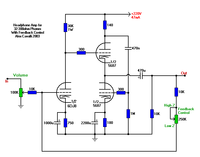

The HD650 are 300 ohms. Not sure which spec is driveability, but the can in question is http://www.sennheiser.com/sennheiser/icm_eng.nsf/root/09969#. I'm hoping not to use OPT...
OK, I did a little more searching.
What if I had a switch to ssitch between the RCAs and puttingthe preamp signal to another gain stage of say 5687, single triode or push-pull like the attached schematic. Any views/inputs on this?

12B4A Cathode Follower (CF)
I read with interests the concept of 12B4A liine stage using LM317 ccs at the cathode.
I want to build a two-stage line stage having the output stage of using 12B4A as cathode follower. My preliminary idea of this cf stage is:
(a) Shunt regulated B+ of 175 volt to the plate of 12B4A;
(b) LM317 current regulated using 48 ohm resistor (25ma) connected between its cathode and ground with 220uf (+.1uf) bypass cap;
(c) the grid tied to ground with 1M ohm resistor.
Does this work? Is this so simple?
I don't know how to figure out the reistance of the LM317 ccs and the grid voltage here. Do I need to put another resistor between the LM317 ccs (317 with 48 ohm reisstor) and ground in order to bias the 12B4A correctly.
Any help and suggestion is appreciated. Thanks.

"...using 12B4A as cathode follower."
Cathode followers are generally considered to be worse sounding than an anode follower. This is because they have 100% degenerative feedback which tends to rob the sound of air, punch and life in general. It might be better to use a very low resistance triode instead, as an anode follower. This will achieve most of the benefits of a cathode follower without the feedback.

Hi Shoog,
Thanks for your reply. I am currently using single WE437a (almost the lowest resistance triode that I can find with a suitable amplification factor) WOT (lundahl) line stage with Allen Wright's SuperReg (shunt type) p.s. I want to try another approach (tube if possible). As I am using horn speaker system of double 15" woofers per side, I need a line stage (preferably tube one) with as low output impedence as possible to drive them to outstanding dynamics and speed. Besides, the line stage has to drive 25' long cable too.
As far as I know, the output impedence of a cf is gm*u/(1+u), so the 12B4a as a cf can deliver a 130 ohm output output impedance, which is really good to me.
Though there are many sayings that the cf is not good, I have listened to a few good line amp. using cf as output stage that are sounding good. I also hope that the LM317 ccs can improve the 12B4a cf.
So I will try. I hope it can work. Thanks.
If you are familiar with Allan Wrights Super Regs and are experienced enough to try something a little bit more complex, why not go for the SLCF. This has all the benefits of a CF, but takes out the feedback element. I have built a buffer based on this and also am currently using a line amp with a PCC88 front end and a SLCF back end. This gives gain and super low output impedence.
Shoog

Hi Shoog,
Thank you for your advice again. I am interested in Allen's SLCF too, but I find it a little bit more complex. I would like to comment that the ECC88 or WE417a is irreasonably expensive.
I consider that the output stage using 12B4A with LM317 ccs at cathode as a CF is simple enough. If it works properly, I may connect its output to a high quality 4:1 output transformer (without DC) via. a 4uf capacitor. This will further lower the impedance by a factor of 1/16. This is similar to a parafeed line stage but this time the output is taken from the cathode instead of the plate. This is what I am thinking and what I want to try. Please correct me if I am wrong.
Thanks.
Sounds like a good overall plan to me. I'am certain that the result will be excellent. Going the parafeed path adds another cap to the signal path though.
The SLCF isn't that difficult to implement, and with experimentation could be applied to any triode.
Shoog
