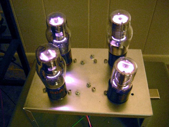

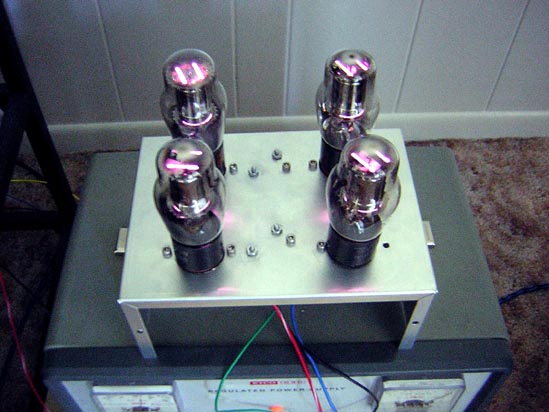

Tonight has been an interesting night... you might want to shelve that regulator idea Dave until you hear the gas regulators in my 12B4.....
Initial impressions are that the soundstage is much wider and much deeper than it was with the Thel regulator board. This may be more due to there now being a seperate regulator for each channel and I suspect similar results might be obtained with two Thel regulator boards. The bottom end also seems to be much improved and better defined than it was. There is definately alot more low level detail to be heard now than there was, even in the background in loud passages. So far the gas regulators seem the better route to go but there is more listening to do and at least another comparison of the Thel board to be done... possibly hooking up both boards we have here.
Tommrrow I gotta raid B.D.'s place to find 4 0D3's in the same bottle!
The photo is just for Choky!

hmmm gotta admit that ghostly purple glow is cool
and the circuit is much simpler
