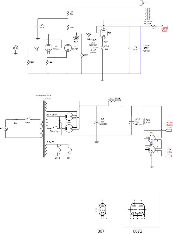

There is a strike voltage i the OD3 specs, how would we take ito consideration this attribute in the design of the PSU?
Choky, can you share the reason why 400V to get margin for 300V B+. For 400V, I guess I will need a transformer voltage of about 350-0-350?

pengboon said:There is a strike voltage i the OD3 specs, how would we take ito consideration this attribute in the design of the PSU?
study schmtc and imagine case when mains voltage is 10% down
yes-you need higher voltage than 280Vac

You mean the voltage at the plate of 0D3 must be 160V x 2 = 320V for it to ignite right? So even if mains voltage down 10%, it will still have sufficient voltage to work?
hi pengboon,
the VR150/0D3 has max voltage of 185V, strike voltage of 160V and operating voltage of 150V. Max of 40mA, min of 5mA to maintain regulation.
you will need two of these stacked, with individual small cap across each as choky said.
Here's how they're wired for my Gordon Rankin 807 amp before (but this one is VR105+VR150)

OK, understood. I can use only 2 VR150s for both channels right, not necessary to have 4 VR150s?
You need 2 VR-150's for each channel. That also makes it dual mono from the regulators to the output and that is also better.
