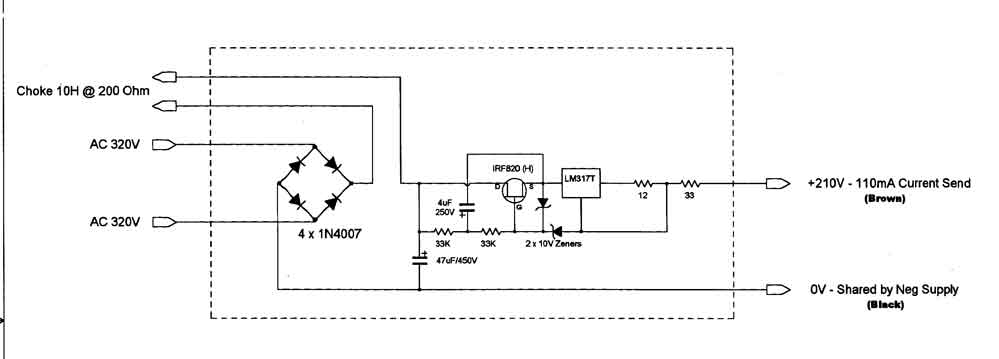

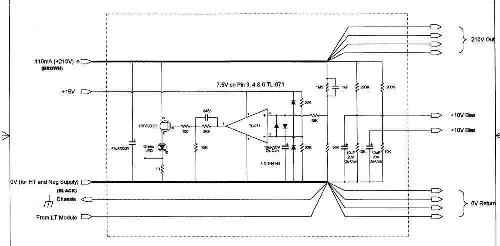

I have info about superreg tnx to description from one guy who have the book ;
so-I don't have book and I don't have Superreg,but-according to those descriptions,seems to me that Mr.Wright already gave more than enough informations on his site (pages) and in various articles,at least one in Sound Practices.....
these pics are from his site (pages) -I save them ages ago....dunno if they are still there-because I didn't checked....maybe Mr.Rassmusen knows better..... 😉
part with 317 is CCS
part with OP is shunt reg
even if I know something more about real superreg,I will not tell you nothing more ,except that this version certainly was Superreg of his time....
just one thing-voltage reference (15V/2) on OP input is critical.......you know better than relay on 15 V supply for that 😉 even if you use crappy Oscon......
and-you already know where to place few trimmers to make thingie little more adjustable 😉

Well, I have built up the Wright Wregulator but only half of it is working. The second half has 0 output. How much bias does the second stage IRF820 require? I get about 60 to 120 mv at pin 5 of the LF351 and it varies up and down as would be normal.... I'm not sure if I have a bad LF351 or a bad IRF820, or something else... have been all over the breadboard and its all wired correctly.....
Thanks!
Mark
Thanks!
