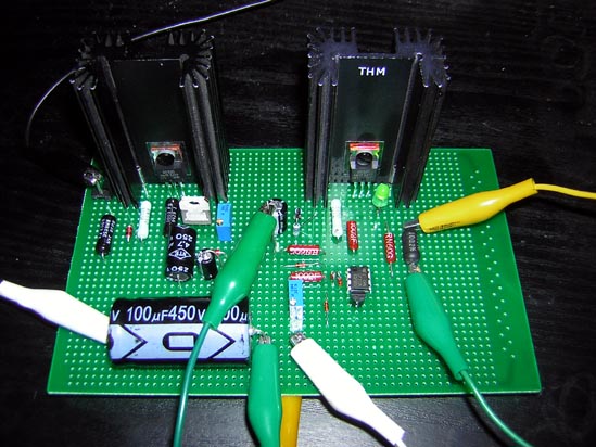

Mark A. Gulbrandsen said:Above I should have said the second half is not sinking anything at all.... No LED!
replace IRF 820 from shunt part in CCS part-just to check its burned or not;
you can use even TL07x (08x) as substitute,for testing ;I dunno for stability versus LF.... but for test it will be OK
hehe- orientation of pins for irf-same as in your's Aleph's output stage,biasing too........
did you checked what you get on inputs of OP?
Well, I changed the LF351 and the output of it varies from .68 to .230 volts now. I even fed voltage directly from my bench supply bypassing the CSS part into the shunt section alone and its still dead... Will change the 820 and report back in a while...

you didn't swapped plus and minus OP input?
plus goes on voltage ref (pin 2)
minus on voltage sens divider (pin 3)
what voltage you have on pin2?
what voltage you can set on pin3?
somewhere there is catch22 😉
at least to my knowledge,max voltage you need to achieve at output of OP is ....hehe....full throttle .....Uled + voltage for open mosfet....~ 3 +4 V.....coincidently-almost same as voltage reference.......
Here are the voltages...
Pin 1 n/c
2 7.09
3. 6.38 to 7.58 depending on pot setting
4. Gnd
5. .68 to .210 Seems too low to me...
6. N/C
7.15.00
8. N/C
Pin 2 is obviously seeing the 7 volts + refrence. Seems like the comparator is not functioning correctly. I even disconnected the drive out(pin 5) to see if it would climb at all. I've changed the IC once already! Also it is definately wired correctly.. been over it a dozen times

I think I just found the problem. I have the output tied to pin 5 as per the Cook Book diagram but the IC spec sheet says pin 6 is the output. Will try it and be right back.........

Hey Geek......I wonder if I just found your problem too??? Mr Wright has some Wrong things in his Cookbook on the Wregulator diagram thats for sure! He DID have the output pin listed as pin 5 but it is indeed pin 6 on the chip. He also has the pass devices drawn wrong. I believe the arrow on the MOSFETs is supposed to go the other direction! I had to change the IC and shunt device and LED again as I believe hooking the drive output up to pin 5 cdamaged the 351. When I moved it to pin 6 it powered up for a flash of the LED and then quit, the shunt device had shorted.
As you can see the LED is now lit up and all things are happy!
For 50 ma draw I think the drive voltage on pin 6 was about 11.5 volts or there abouts. The sink got a bit warmish at 50 ma. When I actually hook it all up I will post all of the correct votage readngs.

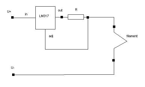

Hi Choky, I tried using the CCS on heaters for my 5687WB headphone amp. It has 14V winding which is bridge-rectified. I had set the 317CCS to ~0.45A using a 2.8R. I do see the slow rise in voltage at turn on, but it rises to over 13V too... so I quickly shut off the mains... did I do something wrong here?
evidently you do something wrong
drawing of exact CCS schematic?
like this:
edit:
5687 is like ECC or 12A*7 series-with 6,3V (12V6) as main value,and current is of secondary importance,so you'll see that tubes from various factories have various working currents at same voltage.
don't worry if you are somewhere in range of 12V6 ; just trim (decrease) 2E8 resistor to have exact 12V6

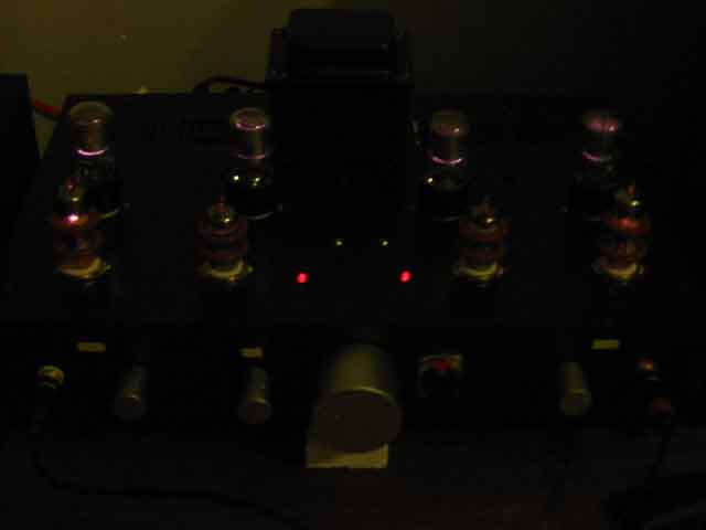

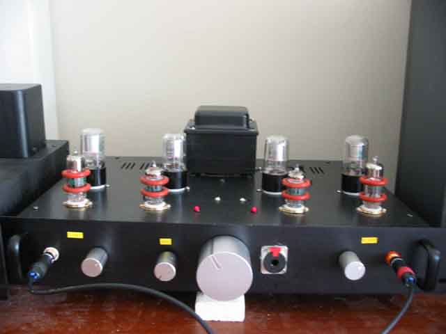

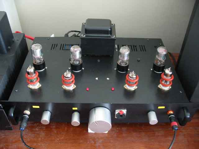

Finally managed to get some picts of my 12B4 preamp. Note that it has a pair of 5687s in a White Cathode Follower with adjustable feedback (for different impedance cans) configuration for my headphones. 🙂
Looks great Pengboon! Ialso like the light at night effect that mine gives off.
