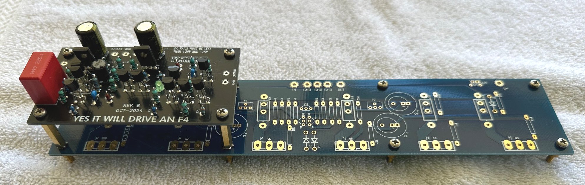

DOUBLE DECKER / PIGGY BACK MOUNTING OPTION
This circuit board is 50mm X 90mm; its mounting holes are 40mm X 80mm. Which is a perfect match to the left hand (or right hand) set of four mounting holes on the F4 PCB: 40mm X 80mm. Using spacers, you can mount it directly atop an existing F4 PCB, in Piggy Back (Double Decker) fashion. Please see the attached photographs.
An F4 amplifier channel board (blue PCB) has a Yes It Can Drive An F4 (black PCB) mounted directly above. The spacers in this picture are 20mm tall (M3 female, hex body, M3 male) but Amazon also sells 25mm tall spacers if you prefer longer. The male ends of the spacers replace the M3 screws which secure the F4 amp channel to its heatsink.
Of course, builders are free to mount their Yes It Can Drive An F4 boards wherever they wish, in whatever orientation they like; there's certainly no requirement to use the piggy back mounting scheme.

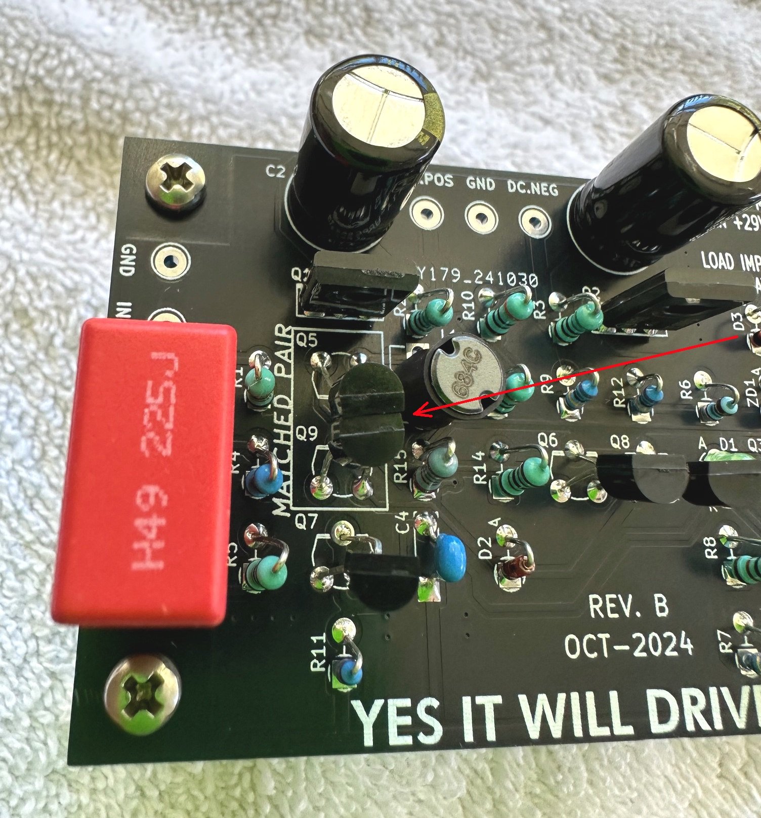

YOU CAN ZIP-TIE Q5 AND Q9 FOR BEST THERMAL CONTACT
I've arranged the PCB footprints of the matched pair Q5-Q9, so you can zip tie them together (face to face) before stuffing and soldering. Personally, I solder all six legs and then cut off the zip tie, before I scrub the board with 99% isopropyl alcohol to remove flux and grunge. See the attached photo with a thin red arrowhead that points to the matched pair of transistors.
After I'm all finished with IPA and other solvents, then and only then do I apply a dab of heatsink thermal grease between Q5 and Q9. Finally I zip tie them back together again. This time: forever.

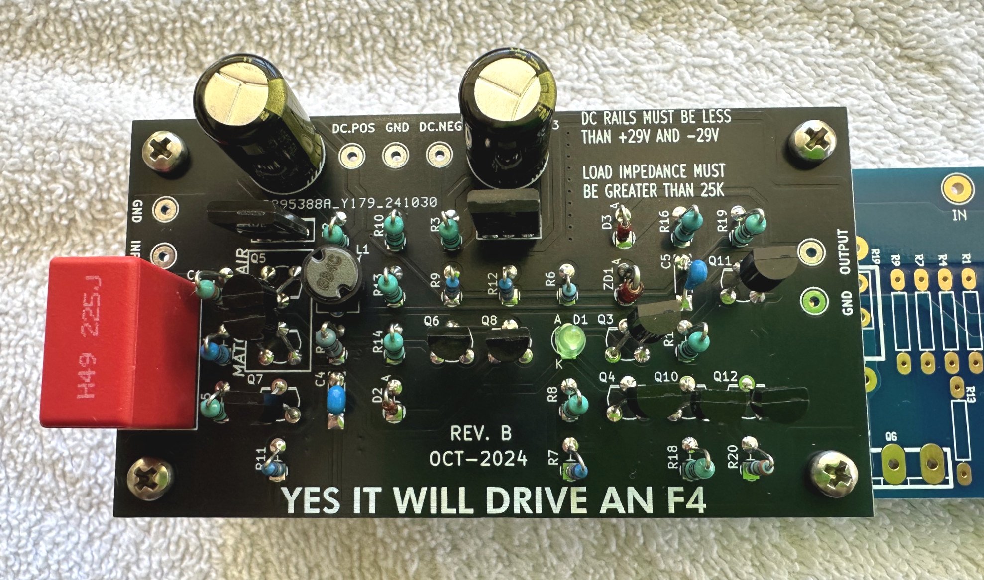

The main goals of this board are (i) to use and to exploit tightly matched BJTs, thanks to the BJT Simple Matcher from BAF 2024; (ii) to provide high gain and wide output swing -- 20V (peak) -- without any shenanigans or funny business on the power supplies. Just use the same ±23V rails as the amp channel, and be able to swing > ±20V on the output.
Goal (i) is met by choosing Q5 and Q9 in the circuit, to be a pair of tightly matched BC546C devices. The schematic asks for matching within plus or minus 0.3 mV; but in the real world you'd just test 30 or 50 NPNs and then select the two pairs with best matching (one pair for the Left channel, one for the Right). If you can't quite get 0.3 millivolt matching, it's not the end of the earth. And if you can get better than 0.3 mV matching, how lovely for you.
Notice that there is only one capacitor in the signal path: input coupler C1, a high quality polypropylene film capacitor by Wurth. C1 blocks any DC offset that may be present on the input ("J6") from polluting the circuit and its output.
The circuit is designed to drive an F4, which includes a pair of AC coupling capacitors between the F4 input buffer and the (large) F4 push-pull output stage. Therefore I have omitted a coupling capacitor at the output of Yes It Can Drive An F4; one is already installed, on the F4 amp-channel PCB. If anyone plans to use Yes It Can Drive An F4 in a completely different application, without an F4 amp-channel, they ought to think very hard about whether or not to AC couple the YICDAF4 output.

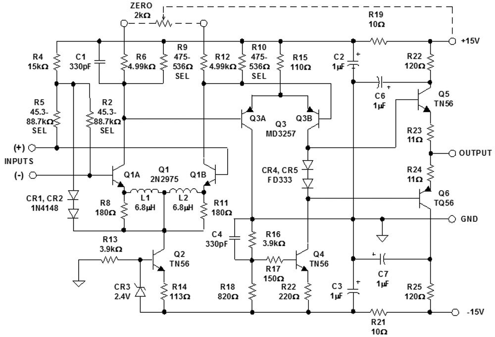

Now let's consider the effect of the inductor L1 in the "tail" region of the Long Tailed Pair, Q5-Q9. This turns out to be quite an old idea; according to Scott Wurcer here on the DIYA Forums, Richard Burwen of Analog Devices used it in 1966(!) on the hybrid discrete opamp "ADI121", shown in the attachments below. Later, Deane Jensen was able to take out a patent (US 4,287,479) on the same circuit. I've snipped out "Figure 3" of Jensen's patent and attached it below.
At very low frequencies, the inductor acts like a short circuit, so the emitter degeneration resistors R10,R13 are removed from the circuit at low frequencies. This has two benefits: (i) the noise contributed by R10 and R13 is eliminated at low frequencies; and (ii) the effective transconductance of the long tailed pair stage is greatly increased. In this circuit, gm rises from 2.4 millisiemens to 52 millisiemens -- a growth of 20X (26 dB). There is 26 dB more gain available at low frequencies, thanks to the inductor. That's 26 dB more negative feedback for distortion reduction. And, oh by the way, the Gain-Bandwidth Product increases by this same factor of 20X at low frequencies. It rises from 14 MHz to 280 MHz. Cowabunga.
I encourage expert readers to derive expressions for "f1" and "f2" (the pole frequency and the zero frequency introduced by inductor L1). I think you'll be pleasantly surprised at how high these break frequencies actually are. I think you'll be delighted at how much extra gain / distortion reduction is made available at 20 kilohertz. All for the cost of a single inductor.
