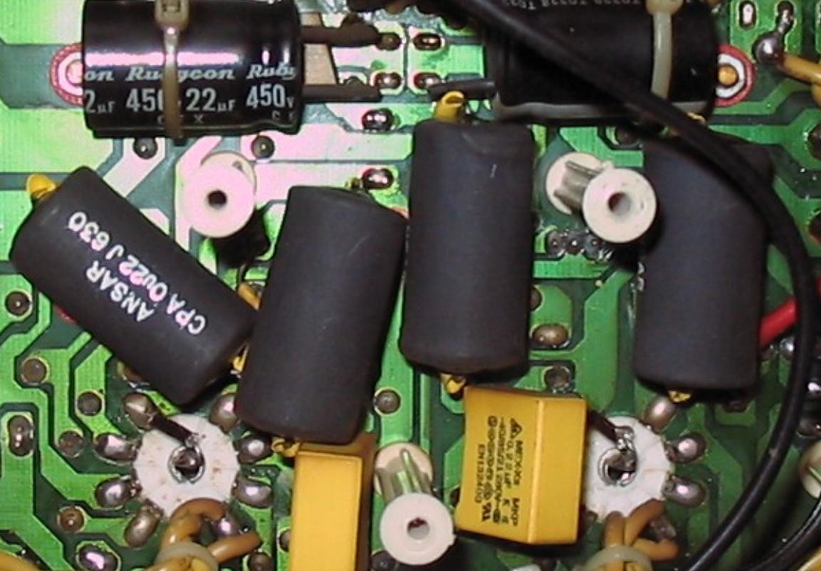

Got the ClarityCap ESA's fitted, but have a low hum on the right channel. Any ideas ?
But ClarityCap use a thicker gauge wire so I had to drill out the holes 🙄
Yikes! I couldn't do that, the caps look far too big but worth it I suppose if you get any improvement. Are the outsides covered with conductive foil? Just wondering if one of the sleeves on the right channel capacitors may be touching a heater wire and inducing hum into the signal. A wild guess I know but it would more likely be the 220nF. If the outsides are conductive, I would have thought a good idea would be to have a connection available to the outer covering so it could be grounded and act as a screen similar to the capacitors used in the Quad amplifiers. I get the impression that those are very much sought after.

Physically large caps can pick up more hum and noise than smaller ones of the same value, because they have larger stray capacitance to nearby objects such as AC wiring and radio transmitters.Got the ClarityCap ESA's fitted, but have a low hum on the right channel. Any ideas ?
I see, pity about that, replaced caps on amps before in tighter places than this without any problems. Have moved them a bit only to make it worse 😡
Any suggestions ?
I have put back the original 0.22ufs and the left hum is still there.... now what??

Have replaced all the left channel caps and both 0.22ufs and still have that left channel hum. So not the new caps then. Something else must be wrong...
Pull the phase splitter out - is the hum still there? You need to try some simple things that can enable you to zero in on where the problem lays. Will have a look to see if I have any stock photo that show what's on these pads bu the shots are normally from far away to take in the whole board.

lol - the inner most two small ones are the phase splitters. the one to the left (V2) is the left hand and the next one V3 is the right hand channel. Let the amp cool before pulling them, not just because the valve is still hot but the crackle will pull your cones out, well probably not but it will be uncomfortable. 🙂
Check your bias voltages are around 0.35V. I assume you have tried the valve swap over technique but it's always a good thing to check the bias is ok first. Excess current through the valve will produce hum but normally you see other fireworks at this stage or at least cherry red anode plates.
Ok, think I get your drift: Remove the two inner front valves then turn the amp on ? Not doing anything until I get a confirmation ! 🙁
