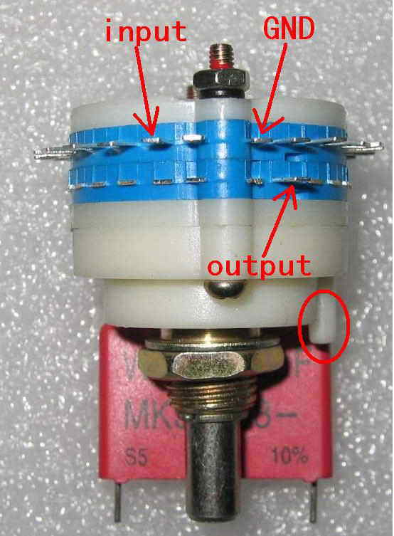

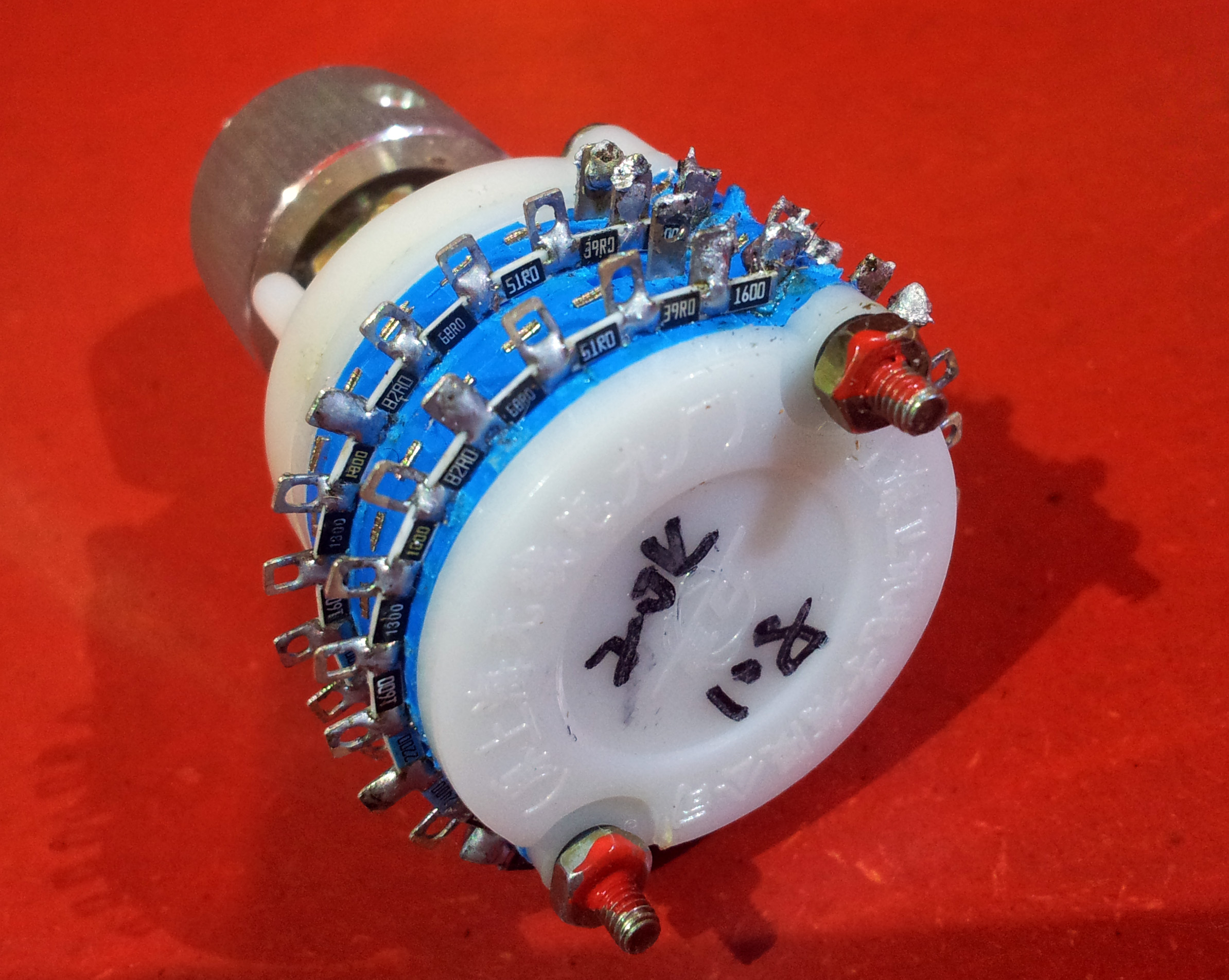

Hello chaps, I replaced the vol pot with a stepped one from China off of ebay, made sure it was the required 20k. But I get little control at the quiet end with a sharp cut off. Makes late night listening rather tricky.
Is 20k actually correct ? The amp's tech sheet says so, but maybe an error ?
What you are showing is an attenuator without any resistors populated. So without knowing what resistors you soldered in, it is tough to know. Perhaps I am wrong on this, but usually a stepped attenuator is populated on the outside.
Can you provide a link to this item from where you bought it?
You need a logarithmic taper, not a linear and this will give you the control you need at the low end.

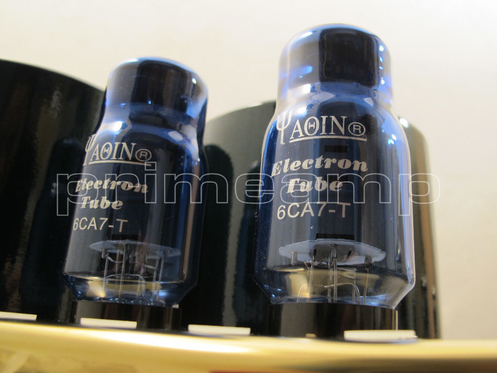

Hello, I am unable to find the actual one I bought on ebay and this was the nearest looking ! I My one does have minute pinhead size resisters soldered between the contacts. Here is a photo from the original ebay ad, though a mono pot

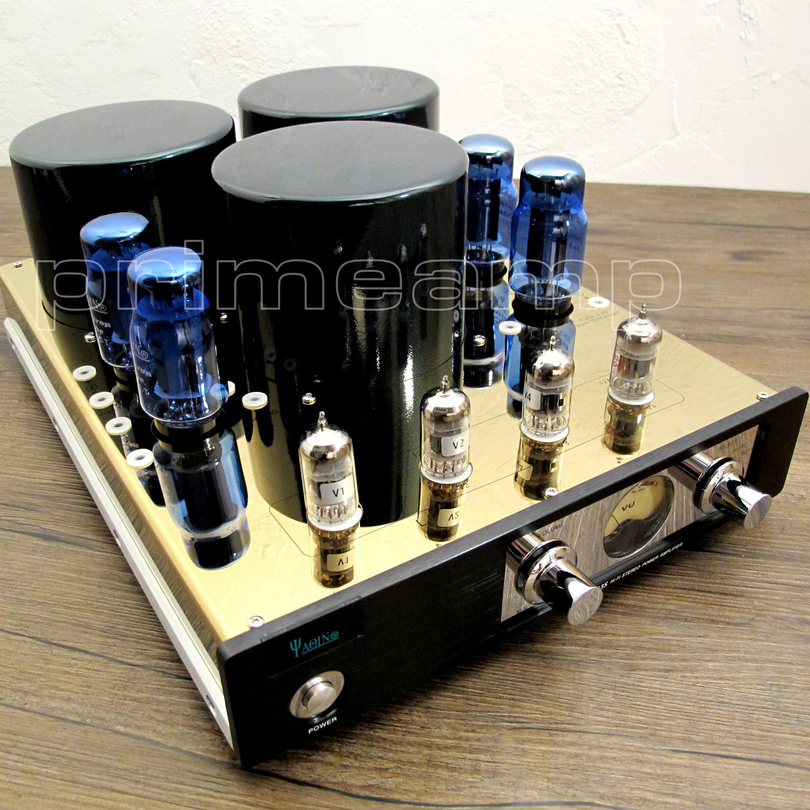

That's the 13s, some differences to the 10L. Some suppliers ofter the choice of EL34 or the 6CA7 for a little extra, those seem to be the 6CA7's.
which are well likes. Colour is just for show, no other change over standard Shuguang tubes.
The 13s is a nice amp, yaqin now make a number of EL34/6CA8 based amps, :- 10L mk3, 10T, 13s, 20L, 30L. Please note sometimes different numbers are used in some Country's for the same amp!
