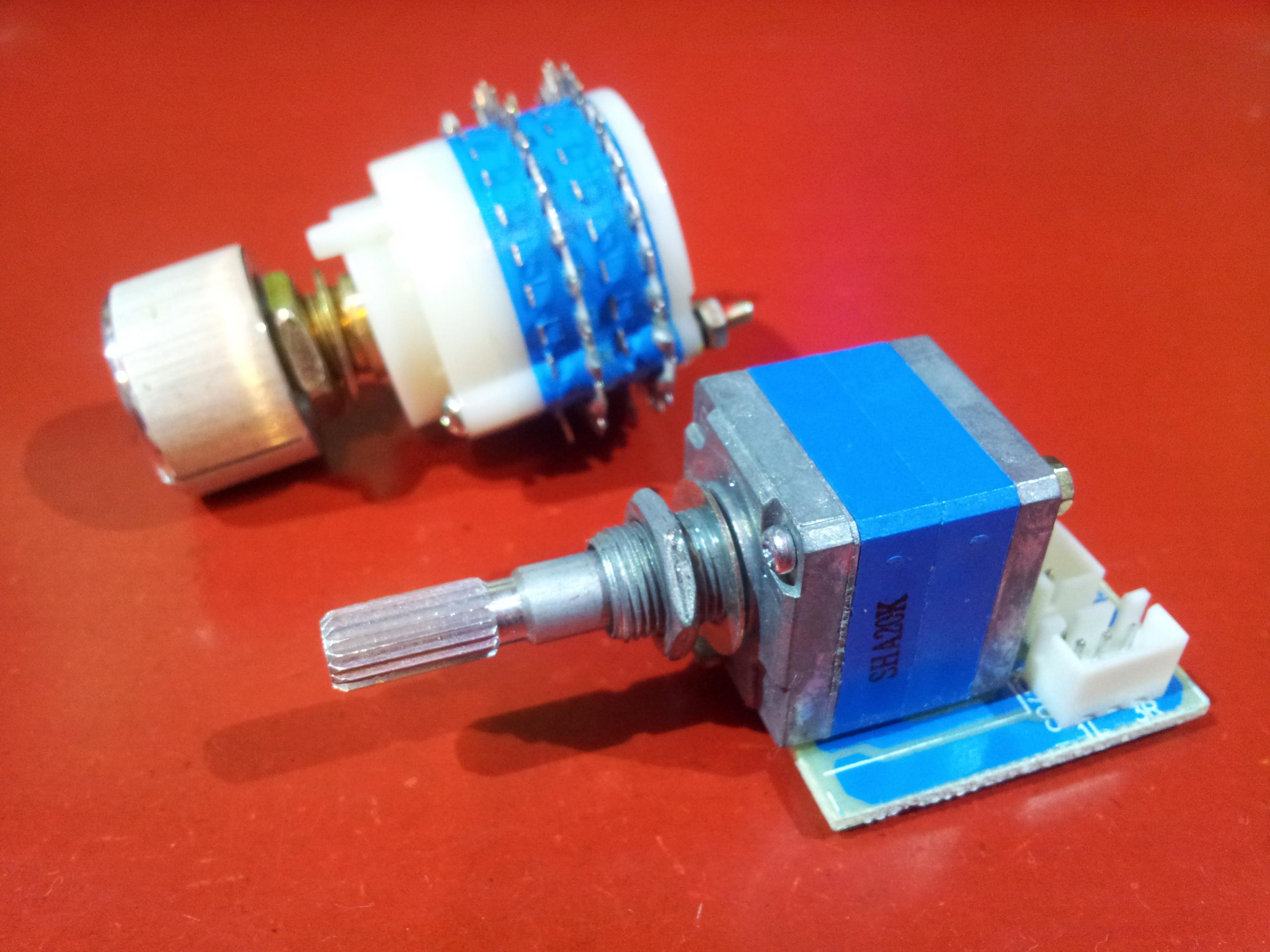

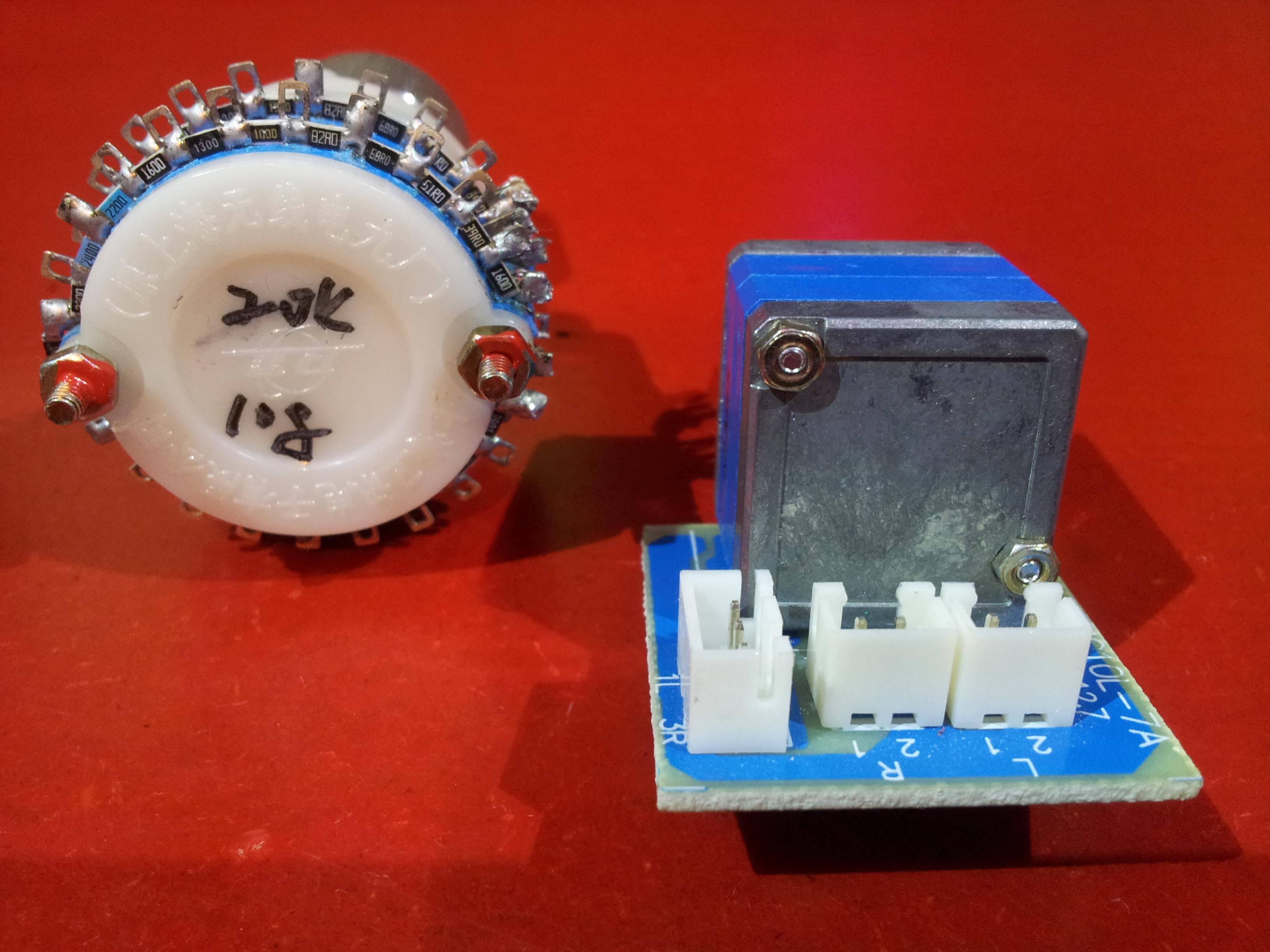

I'm considering changing the volume pot for the Goldpoint stepped attenuator.
I have never done a mod like this before. Would there be a distinct sonic benefit in doing so?

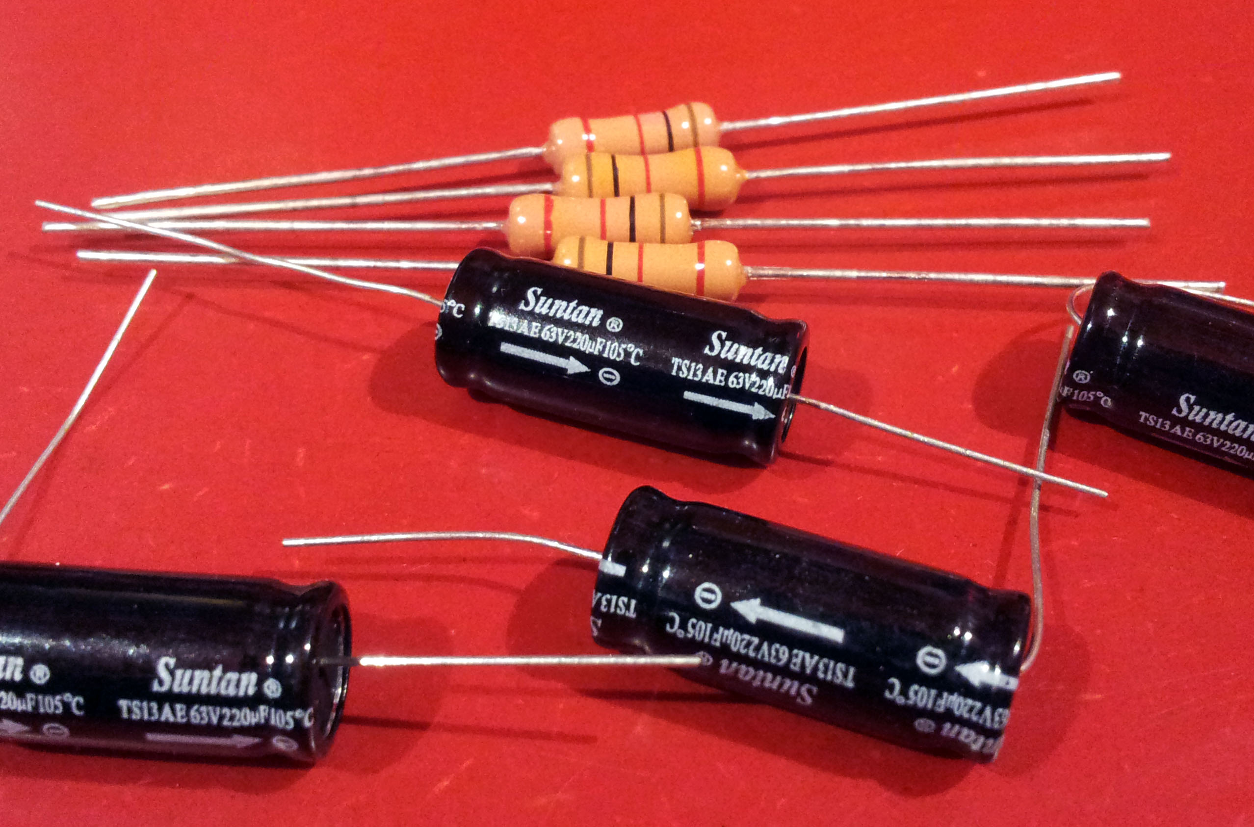

Thanks I shall get some, also it seems some have done a cathode resistor bypass with 220 uF / 63 volts electrolytic capacitors mod that Les cam up with. Did you do that too ?

Anyone, Are these a good choice for cathode resistor bypass ?
Electrolytic Capacitors 63v 220uf 105'C C101 4pcs | eBay
I am using a standard 100v 220uF electrolytic on the bypass. I'm not sure the brand matters much there.

The electrolytics are polar. Do they have a positive and negative side? If not I'm pretty sure the arrow points towards the negative side. The cover of the amp shows where the positive and negative points are that you'll be soldering to. The negative sides are the two inside points and the outside points are the positive side. Does that make sense? I'm not sure about the resistors, I just installed them with the stripes facing the same way as the originals.
