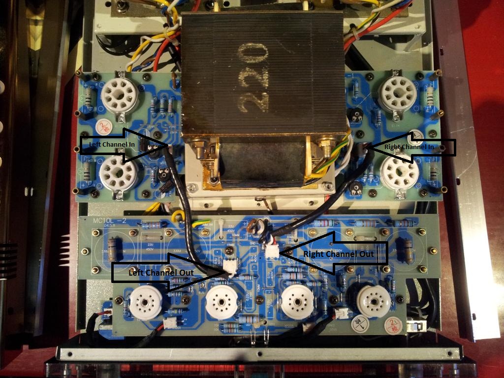

Thanx Data, can you confirm before I place the order that I need:
x4 (0.1uF) and
x2 (0.22uF) ?
Clarity Cap ESA 0.1uf/630v measure 27mm x 20mm, so will fit fine, keep the orientation of the caps so that the signal travels in the same direction as the print on the cap/s.
Don't worry about the other two .22uf caps.

Ok thanks, guess the ones I will be removing will have directional writing for me to follow the direction
You will be able to see the way they need to go by looking at the circuit before and after each cap.
Each output end will lead to the interconnecting wires from the pre amp PCB to the power PCB.
Ahhh really lol. I am self confessed blind to this then, unless there are directional arrows or something ?
These are the connecting leads from the pre amp PCB to the power PCB, just follow the PCB traces from the caps to these as they leave the pre amp PCB.
That should show you the direction they need to be.
Barbie, Isn't that one on the right the other way round?
Or am I looking at the traces wrong....

Thanks that's useful to know, will make sure the writing on the caps ends in the direction of those wire connectors. Many thanks 🙂

Yes and I was just about to mention this to you, wow, I would have put that one the wrong way.....
I'm not sure how much worse it would sound if you did get them around the wrong way, It's just that they are said to sound better with the foil end of the cap at the output, this is normally indicated by the direction of the writing, in the end that the writing starts, and out the foil end where the writing ends.
As I understand it anyway, unless i have it *** about.
