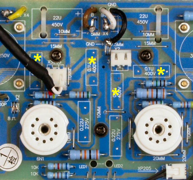

Finally getting round to upgrading the caps. Took a look inside and I could not find them, never mind replace them ! Les says they are C104 + C105.
- Can someone point them out to me on a photo pls ?
and
- Recommend suitable caps pls. Make and value would be helpful 😛

You can't go wrong! It's the blue 100nF (0.1uF) capacitors that go to the positions shown on the attached photo. Leave the 220nF (0.22uF) as they are in situ.
Les
Thanks Les, those blue things did catch my eye but couldn't read any values on them.
So I need 4x 100nf.
Do the 220nf's have no affect on the sound ?

The Ansar's are rather too basic an upgrade to make much of a difference I imagine.
How about these ? :
ClarityCap ESA range of capacitors home page
or Mundorf or Jensen but don't know which range to choose from.
Me too rolled the x4 front valves which took the glare away that the stock tubes had.
Soon as I lifted that lid that big 220 hit home hard !
I tend to agree with you about the caps even though the description of them made it look worthwhile trying. I did not want to go too high like 470nF as sometimes it can have a negative effect and cause problems, so I was being a bit cautious and decided to just double them. It was more of an experiment really, if there was a Bass improvement it was very subtle. The wrapping on your mains tranny looks a little discoloured in the centre so it must be getting quite hot, just keep an eye on it. I have measured my MC10-L across the audio bandwidth and found it very flat, there are no peaks or troughs at the lower end, which is what I would expect the amp to do. If more Bass is required it could be the speakers, their placement or the need to fit an EQ ahead of the amp. I find this a particular problem with phono amp stages, the ones I have made hug the RIAA curve but folks want more Bass! That is not the job of the phono amp, for my latest design using op-amps, I added a small EQ stage within the buffer and it made a tremendous difference.
I will order some of those ClarityCaps ESA for starters. Shall I do a direct replacement on values ? Also they do them in different voltages 250 and 630Vdc ?
