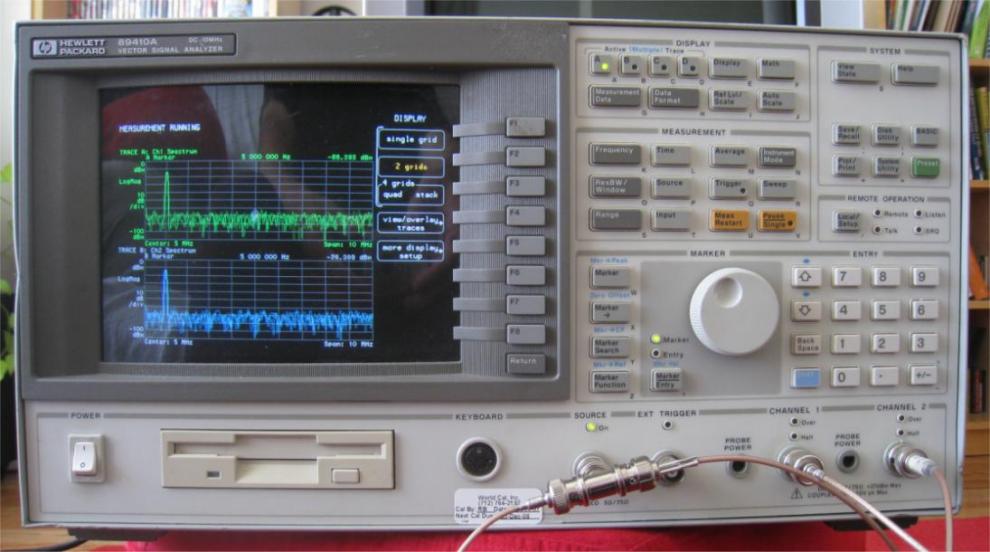

Re: Re: Re: Re: Damping Factor
janneman said:
Lucky you! This is one great piece of equipment. Looking forward to your findings.
Hehe 😉

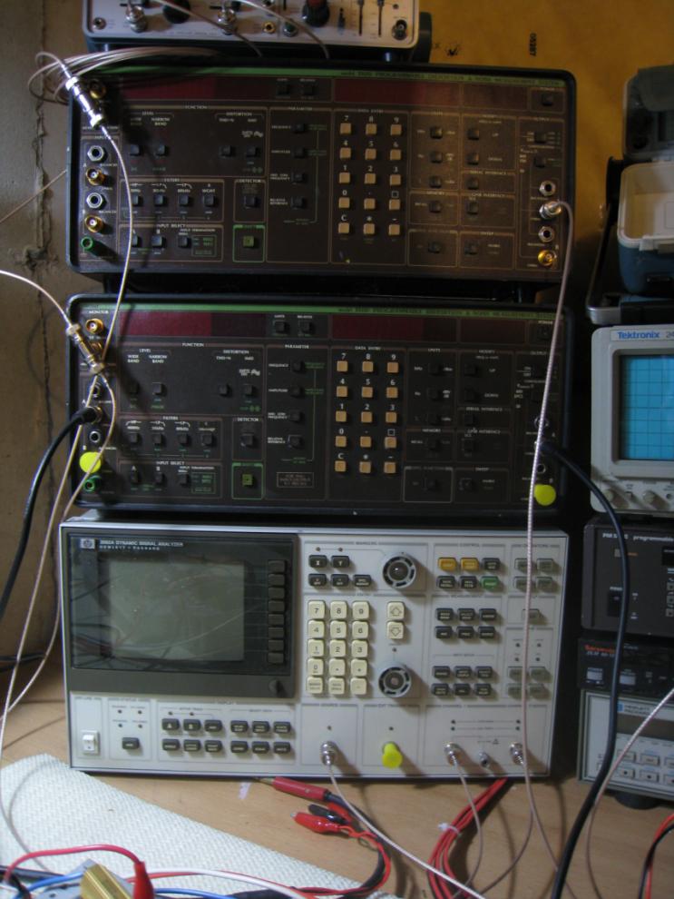

Bob,
I did not create a thing; this is how the 19+20KHz test signal is generated by the Amber 5500 IMD extension/option board. This option allows reading the IMD values straight on the instrument's digital display (and through the GPIB interface).
Honestly, I haven't looked closely on how this AM and carrier supression is accomplished in the option board. I have the schematics and I'll take a closer look ASAP (I could also post the schematic for the perusal of the telecom savvy engineers around). What I know for sure is that I am feeding the spectrum analyzer with the Amber 500 "Measured Function" signal, which specially designed for spectral analysis.
I have compared the Amber 5500 IMD measurement results with the classic approach you mentioned (I have actually two Amber instruments - see attached picture - and I used them to generate high purity 19KHz and 20KHz signals, mixing them either straight into 50ohm or in a AD797 opamp) and I got in either case no statistically different IMD results. Actually I prefer the 50ohm mixing, because extracting the AD797 noise and distortion contribution is a very time consuming process which, unfortunately, I was unable to find a way to automatize. I would need a very low noise programmable switching matrix, which is expensive (at least from Agilent or Keithley that I know about).
