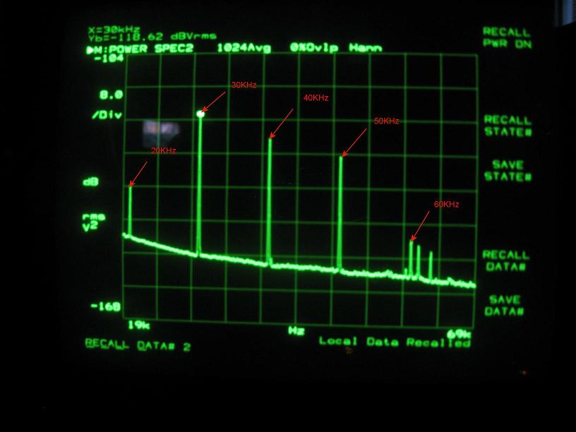

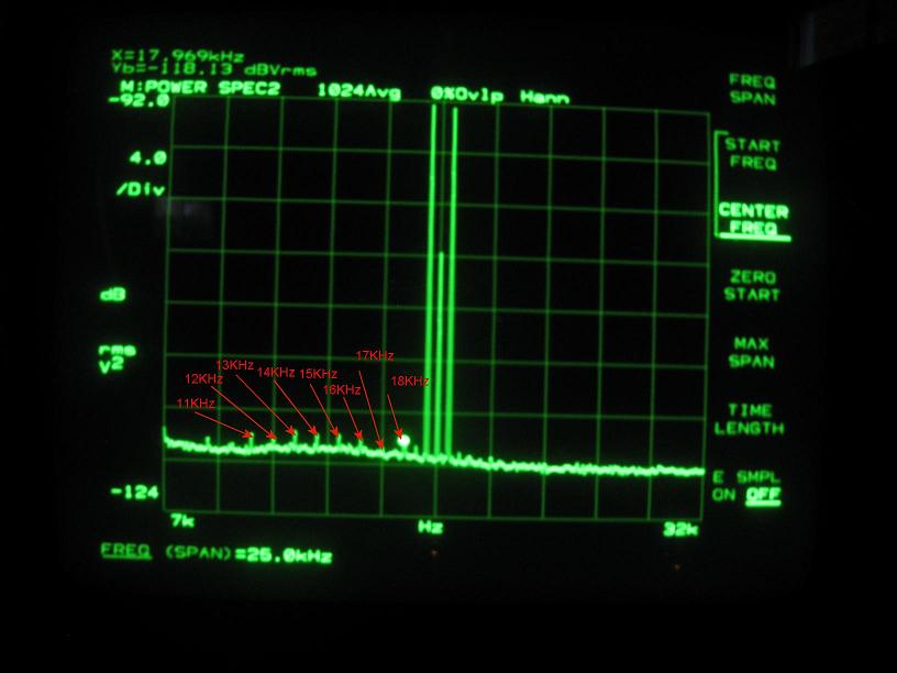

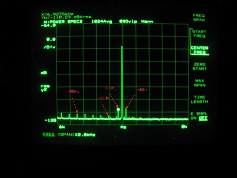

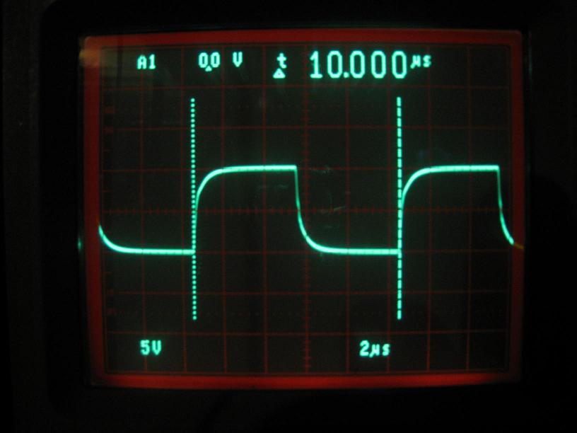

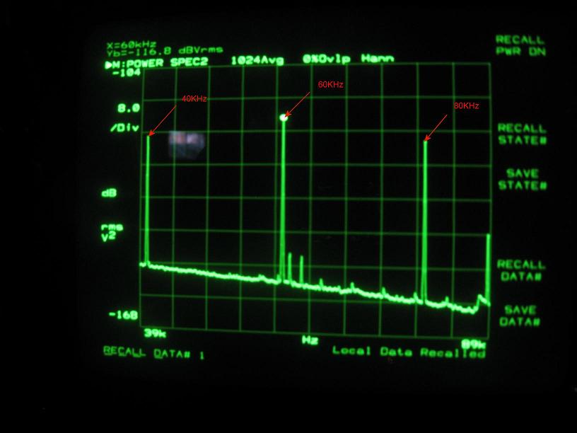

Ok guys, may I jump into this hot debate and post something about YAP?
I'm busy finishing the YAP measurements and here's the distortion final results.
1. 20KHz spectrum (full power 200W into 4ohm). THD20 is somewhere between 1 and 2ppm.
2. 10KHz spectrum (full power 200W into 4ohm). THD10 is again somewhere between 1 and 2ppm, slightly lower than at 20KHz.
3. IMD CCIF 19+20KHz. Again, it's between 1 and 2ppm. Fundamentals are attenuated by the Amber instrument (I got lately the IMD extension).
4. IMD SMPTE 60Hz+7KHz
5. The pulse response at 100KHz. As mentined before, the rise and fall times are defined exclusively by the input filter.
