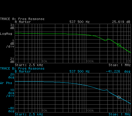

Plot
The whole YAP closed loop frequency and phase responses. Market is at the 3dB point.
The measured 3dB bandwidth at full power (200W into 4ohm) is 537KHz and the phase shift at the 3dB point is 41 degrees. In the audio band, the phase shift is very small. Unfortunately, the resistive power load that I am using is not made out of anti-inductive resistors (as much as I was able to look after, such resistors are very expensive), so probably the phase measurement is a little off.
The bump, both in amplitude and phase at around 300KHz, is a little strange and needs more analysis. Could it be related to the Zoebel and/or the output inductor? Food for thought for when I'll be back...

You think such measurements should be done in a reactive speaker load? If so, which speaker model would you suggest to use?
andy_c said:
Maybe there is some kind of resonance that interacts with the output inductor-resistor combo. I'm assuming this is not at the feedback point, but at the other side of the output inductor?
Yes it's at the output, after Zoebel and coil. I think it's a resonance between the output coil and the Zoebel cap, strongly dampened (the bump is around 1dB) but I have to confirm this.
The 3dB corner is set by the input filter.
