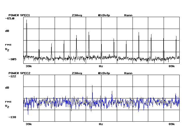

Top trace is some junk, bottom trace is the residual daylight noise floor, before any significant averaging.

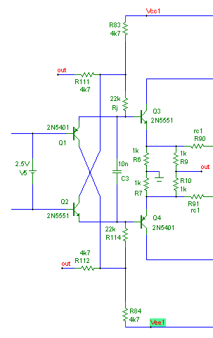

Earlier in this thread there was some discussion of diamond buffer vs. conventional EF drivers for the MOSFET OPS. You mentioned you saw higher crossover distortion with the conventional drivers. I was thinking about this earlier, and it dawned on me that for the Toshiba MOSFETS with conventional drivers, the bias spreader voltage will be about 4.4V (2 * 1.6 + 2 * 0.6), assuming 1.6V for each MOSFET and 0.6V for each BJT driver. For the diamond buffer, this voltage will be about 2.0V (2 * 1.6 - 2 * 0.6).
Since the tempco of the bias spreader is proportional to its voltage, this says the bias spreader tempco for the conventional driver case will be about 2.2x the tempco for the diamond buffer case. Could it be that the MOSFET bias for the conventional buffer case was overcompensated for temperature?
andy_c said:Hi Ovidiu,
Andy,
You may have here something, let me think about (and do some calculations). I'm not sure if I used the same bias spreader for the EF experiments. Anyway, I concluded about these Toshiba devices as having an unusually low (5-6mV/C) tempco.

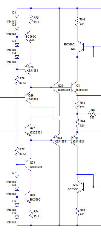

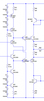

I came up with the circuit in the attachment below for the input stage. The funky arrangement with Q20 and Q24 was to isolate the input devices from the "violence" that was occurring with Q3 and Q4 under high slewing conditions. When I hooked up the collectors of Q26 and Q27 to the emitters of Q3 and Q4, the sim bombed under high slew rate conditions.
I also ended up with a current gain of 6x in the CFB stage. The input stage is biased at 5 mA, while the VAS is biased at 30 mA. This was due to a requirement of sourcing/sinking lots of current to the drivers under high slew rate conditions (10+10 output devices at 200 V/us), giving +/- 60mA peak base current to the driver BJTs.
Under sine wave conditions, the input current of the circuit is very low. But under high slew conditions with a square wave, the peak input current is still high at +/- 15 mA or so.
andy_c said:I came up with the circuit in the attachment below for the input stage. The funky arrangement with Q20 and Q24 was to isolate the input devices from the "violence" that was occurring with Q3 and Q4 under high slewing conditions. When I hooked up the collectors of Q26 and Q27 to the emitters of Q3 and Q4, the sim bombed under high slew rate conditions.
Q20 and Q24 seems to be a good idea. I've seen this kind of configuration in some bipolar linear IC designs. It also helps Q3 and Q4 to dissipate less power.
For the rest, I'm not sure I follow. Are you using 10 pairs of output devices? In the current incarnation, YAP uses 3 and 10mA in the driver seems to be an overkill (bot simulated and measured, under pulse conditions). Certainly, 30mA looks like a lot of current here...
You also seem to push 6-7mA through Q26 and Q27. Isn't this to much? Something like 1mA will allow using BC550/BC560 all along except for Q3 and Q4.

Hi Andy,
Adding Q26 and Q27 is a good thing, as it also removes the nonlinear capacitive load from the previous stage, i.e. less distortion. BUT the rest (I'm sorry to say so) is a waste of silicon. If you give the OPS some gain (e.g. 6dB, see below by means of R6,7,9,10) you can make the circuit much simpler. No need for cascoded current sources, just a few resistors!
Edmond.
Well, I'm looking at +/- 90V rails, so that ends up being lots of current through the feedback loop at max output power. It seems like increasing R6, R7, R9 and R10 to keep that current down would then constrain the input stage bias current to be pretty low.
Edit: Scratch that 🙂 - maybe a small resistor could be put in between emitters to up the bias current?
I see what you're saying, though. That's a cool way of bootstrapping using only resistors.
andy_c said:Well, I'm looking at +/- 90V rails, so that ends up being lots of current through the feedback loop at max output power. It seems like increasing R6, R7, R9 and R10 to keep that current down would then constrain the input stage bias current to be pretty low.
Hi Andy,
Sure, at +/- 90V rails at lot of power is dissipated in the resistors, but my example was based on a +/- 50V rails. So, please, ignore the actual resistor values, as my schematic was only intended as an example of how to simplify that thing.
As for 'maybe a small resistor could be put in between emitters to up the bias current', I'm not sure where exactly. Please post a schematic.
Edmond.

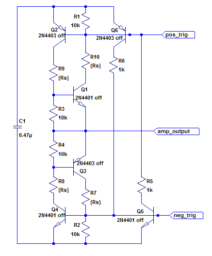

Hi Andy,
I used a scheme something like this several years back in the MOSFET power amplifiers that I employed in my Athena powered speakers with active crossovers (some description on my website). I'm not sure I'm following the problem you saw with power dissipation in the FB resistor.
In my circuit, I have what I called "flying catch diodes" going from both sides of the bias spreader to the amplifier output node. The anode of one such diode goes to the negative end of the spreader, the cathode of the other goes to the positive end of the spreader. The flying catch diodes are thus normally reverse-biased by about half the spreader voltage. They move with the signal, thus the term "flying". There are also permutations that I refer to as flying Baker clamps.
In a fault situation, the flying catch diodes prevent either end of the spreader from getting more than 1 Vbe from the output node. This implicitly limits the relative forward voltage driving the output transistors "on", providing a natural current-limiting action. With IR VMOSFET output devices, this ends up limiting the gate on voltage to something in the neighborhood of twice the threshold voltage (e.g., on the order of 8 volts), depending on details that can be manipulated. This action conveniently limits the peak fault current.
I then have a short circuit protection circuit (which can be a Triac) that simply shorts out the spreader. This, combined with the action of the flying catch diodes, shuts everything down. The scheme assumes that the VAS stage is current-limited, so that it cannot try to drive the load through the catch diodes by more than 20 mA or so. Once the short circuit protection latching action takes place, the power must be cycled to reset the whole thing.
This scheme can also be applied to MOSFETs with lower threshold voltages with some modification. Ditto in regard to controlling the current limiting point with output stages using emitter resistors (including bipolars, although I've never applied it to bipolars).
I've never seen a problem where this caused a high voltage to cause a lot of dissipation in the FB resistor, but maybe I just got lucky.
Bob
Bob
Hi Bob,
What I had in mind is something like the circuit below. pos_trig would be connected to the collector of an NPN that senses the N-channel output current. neg_trig would perform a similar function for the P-channel side using a PNP. amp_output is just that. Q5 and Q6 serve as an ORing function to turn both latches ON even if only one half of the output stage is sensed as having high current. C1 is the bypass cap of the spreader. The resistors labeled {Rs} are for limiting the peak current in Q1-Q4 due to the rapid discharge of C1 when the latches are triggered.
If I understand correctly what Ovidiu was saying, the high current in the feedback resistor in the fault condition stems from the output stage of YAP being a unity gain CFB amp. Schematic is here. When the output stage is switched OFF, the output voltage is constrained to close to 0 Volts, while the input voltage is pretty much unconstrained due to the feedback trying to correct for the voltage error. The input stage is capable of putting out high current into R52, thus the possibility of high currents in the fault condition. Please correct me if I'm wrong on this.
Bob Cordell said:[snip]
Bob
