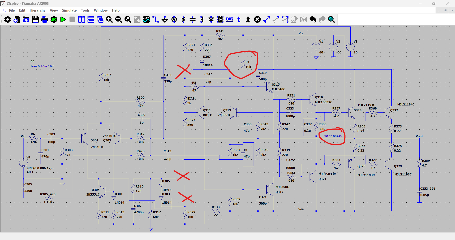

Gosh dang it. I just tested one of my 2sc3280 and it did not pass 6 way test. I just testeds these last week. I will order a few 2sc500 replacements from Digi. If there is a better suggestion for a replacement let me know. By the way it was Q327 and while I am at i will replace Q323 even though it passed. Makes me wonder what made it go bad. Sigh its depressing for sure😒

The whole output stage, drivers and outputs should just follow the voltage that appears on Q311. The emitter and collector volts of Q311 should always be fairly similar and the main amp output follows that.
Output transistors usually fail short and failure of the 2SC's would just apply positive rail voltage to the output.
Yes there is but it is complex because the amplifier has to be looked at as one whole loop.
The high negative voltage at the output should be turning Q303 in the input pair on harder and your readings suggest that is happening. Q303 turned on in turn switches Q305 on harder and that pulls the collector of Q301 toward the negative rail.
Your readings suggest that is happening with Q301 collector more negative than Q301 collector. That is the take away point of all that.
Q301 collector is therefore turning OFF Q308 by pulling the base voltage down. With Q308 OFF the output stage should all swing to a high positive voltage.
Try removing Q308 and see if the output goes positive.

Leave Q309 out and now remove Q307 as well. Does the output now go positive?
If it does not we also remove Q341 and we now take a 10k or something close to that and connect it between collector and base of Q315.
That forces the output stage into conduction and the voltage on the 0.22 ohm's must rise to the positive rail value. That should prove if the upper half of the output stage is OK or not.

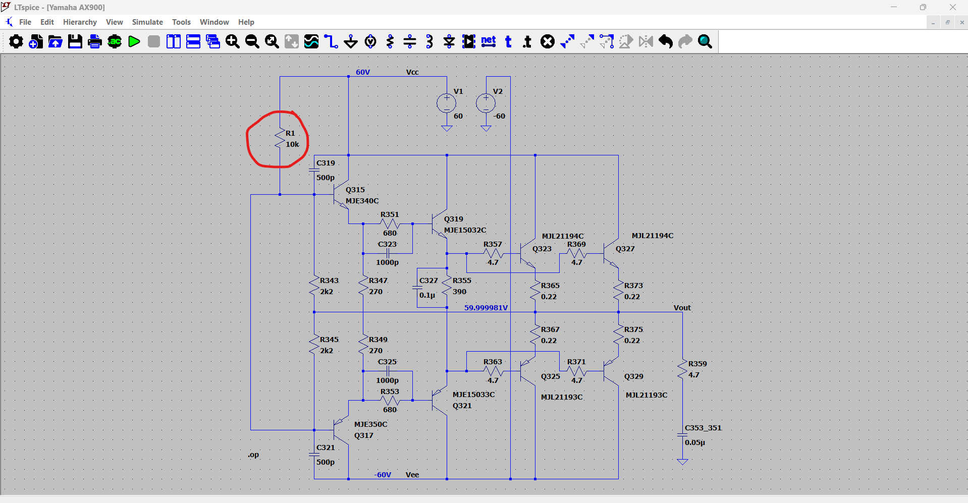

First thing of note is the bulb should be dim.
Leave it all as it is now but add a link across Collector and Emitter of Q311 which is the bias generator. That forces zero bias. If the bulb is still bright there has to be an undiscovered issue with the driver and output stage.
So this is what you have now. The output stage should just go to + positive rail value. I haven't added a link here because it should not really need it. Add the link, force zero bias and if the bulb is bright there is an issue in the driver/output stage.

With the link added the circuit reduces to this, a standard emitter follower output stage. The output voltage should follow the voltage applied to the what is now the link. If we applied +9v to the link we should see +9 (approx) at the output, Apply -27 and we should see -27 come out.

OK, I applied the jumper to the emitter and collector of Q311. I totally understand the theory. I am getting some understanding on the theory of operation and I will continue to study it.
This is what I got. Still bright light. The bias did go to Zero just as you anticipated. The voltage at the .22 ohm resistors is -8.30 vdc. The voltage at the cvollector of Q311 is -6.88vdc.

So we have an issue with the driver/ouput stage??
