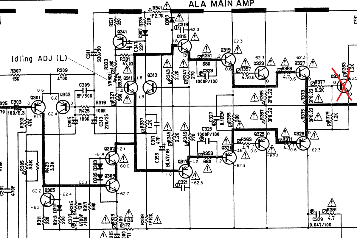

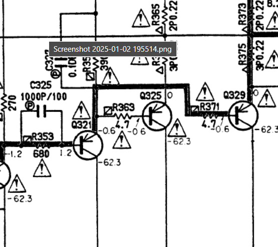

OK, lets work with that. And this is measuring from the emitter of Q321 as I outlined above.One leg of R363 reads -360mv and the rest read 0 vdc.
And:The base of Q325 reads -360mv and the rest read 0vdc.
There is 28vdc present on the .22ohm resistors
Look at the circuit. If you have 28 volts present on both legs of the 0.22 ohm then you should have 28 volts on the emitter of Q325. Do you agree? The emitter goes to the 0.22 ohm and yet you say 'the rest' are zero.
If you had 28 volts on just one leg of the 0.22 ohm and nothing on the other leg then the 0.22 ohm would be open circuit.
Does that make sense?
I really feel is getting outside your comfort zone tbh 🙂
I agree with you. Looking at the circuit as you said if 28vdc is present at the .22 ohm resistors then there has to be 28vdc on the emitter of 325. I reasoned that the 28vdc is a result of an open resistor. Sure enought 2 of the .22 ohm resistors were open. I replaced them and now we have alot different voltages at 321 and 325. Although that is apparently working to a certain degree but the relay does not engage. The relay however clicks after I power off in a 10 second span
I get 1.8vdc across Q311.
Using the junction of .22ohm resistors as a reference the following are present.

I figured out why the relay was clicking. We had left Q331 out part of the protection circuit. I reconnected it and no more clicking after powering off
All those new readings show you now have a DC offset fault. Q319 collector at 100 volts implies all the other points are at what would be -50 volts if measured from ground.
With 0.22 ohms replaced we have to switch where we measure from and see what is going on with the offset. So using ground as the meter reference this time just check that the DC offset (voltage at the 0.22 ohm junction) is in fact now sat at -50 volts.
I suspect you have multiple issues with this amp which is why it might seem difficult to fix.

100mv offset is fine at this point. The rails will alter with a bulb and if the bias current alters in the good channel to that rail variation is likely normal
I've no quick way to diagnose the high negative offset as it could be caused by many things.
I think you are going to have to do as I suggested earlier and list all the transistor voltages just like you have done above. Also make sure the 16 volt supply is on one end of R307. I know it seems a lot of work but it might show something. The action of the feedback loop means there should be a massive error somewhere as the loop tries to correct the offset and tries to turn on the upper NPN section.
Do I use the the .22 ohm resistors as my reference point. And there is 16vdc on one side of R307

Sorry I missed your message, using resistors as a reference, I can go theu them again if you like
It has to be from ground really and its all the transistors so that is 16 of them. That's why I said it might seem like a lot of work but without seeing them set out its impossible to see what is going on.
