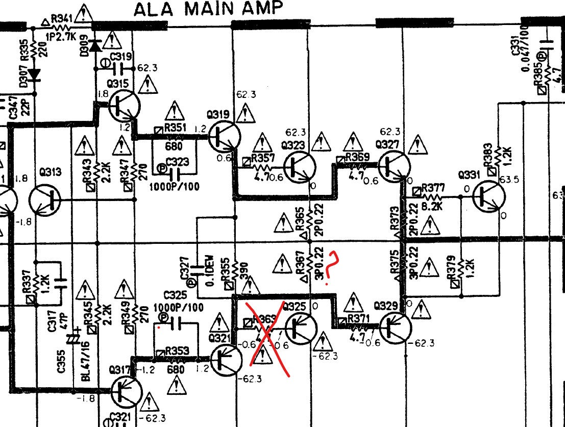

Pulling R363 should turn off Q325 and that should give no volts across R367. Do you see... so that points to Q325 having an issue assuming all the component reference numbers are correct.
If you pull the base resistor to an output transistor it should be off at all times and no current should be in the 0.22 ohm to that transistor.
This stands out. Check check check... here's why.R367 137mv
So we have R369 and R363 pulled.
and yet we have:
R367 137mv
8.82VDC to base of Q325 with chassis ground as a reference point. 61mv emitter to collector. R367 138mv confirmed.
With R363 lifted it should be non conducting and no voltage across the 0.22 ohm (R367). In other words the transistor seems to be conducting when it should be off. 137mv across 0.22 ohm is over 0.6 amp.
61mv 'emitter to collector'. If you 61mv across the transistor then it looks duff to me.
So based on the evidence either the transistor is duff or there is another undetected conductive path somewhere.

Replaced Q325. .2 across .22 ohm (367) and R375. Bulb goes very dim to the point where it looks off
Hmm 🙂
We just don't seem to be homing in on any of these problems at all.
0.2 volts across 0.22 ohms... take a step back and think what that tells us.
When you turn the bias up on an amp with a DBT the bulb starts to brighten. I think you have seen that happen in the past. Even a couple of hundred milliamps of current in the output stage lights the bulb. 0.2 volts across 0.22 ohms is close to 1 amp. I=V/R which is 0.2/0.22 = 0.91 amps. That is huge in the scheme of things. The bulb should be quite brightly lit at that.

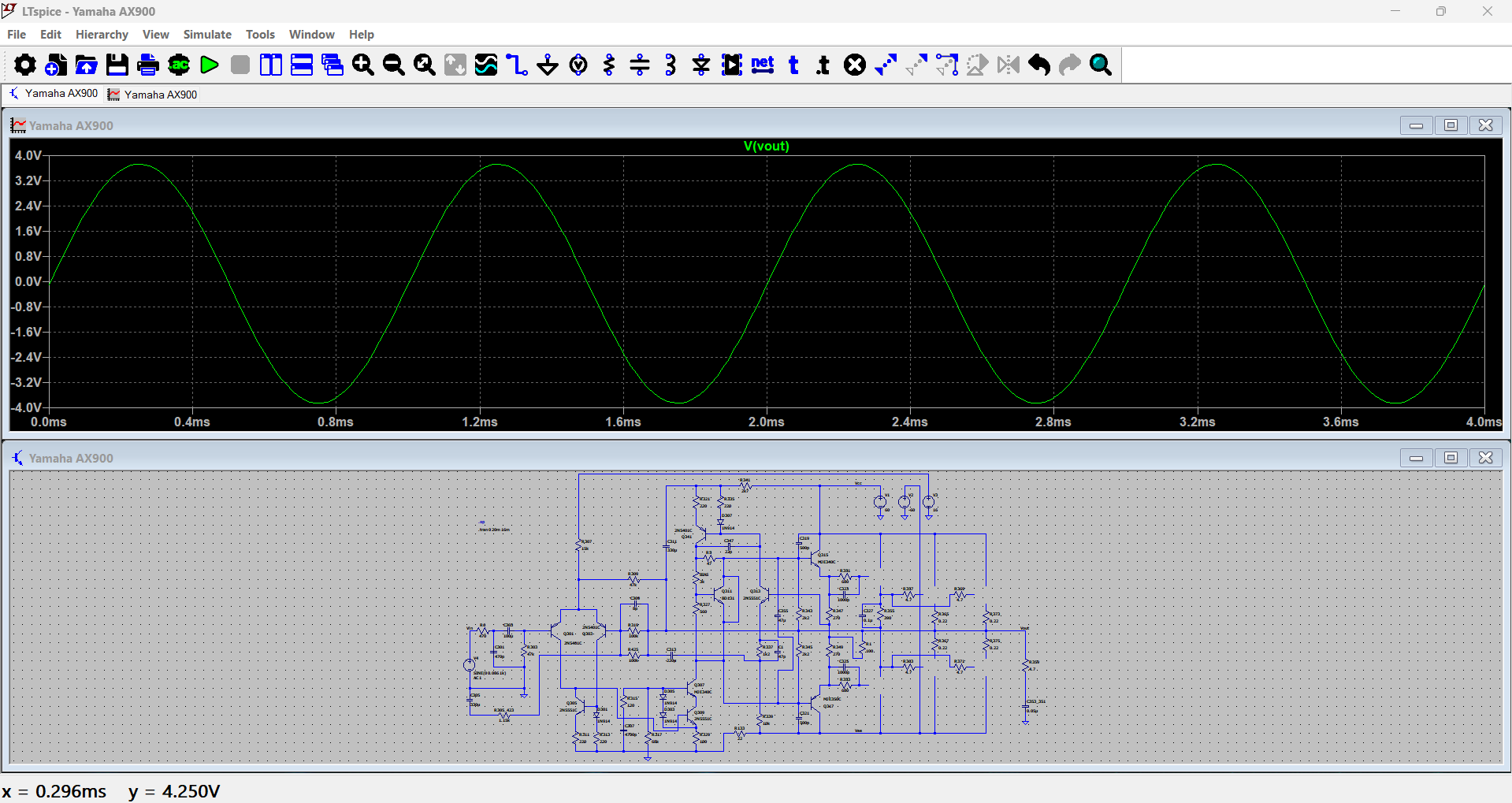

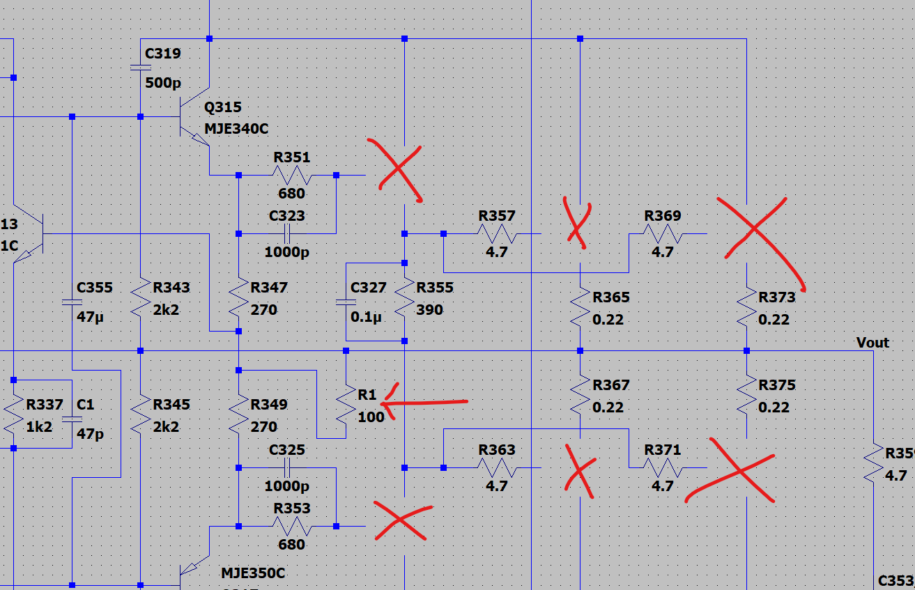

There is one unconventional step you could try but its at your own risk. Depending what faults there are a resistor might burn.
If you remove the outputs and drivers and then add say a 100 ohm resistor as shown here the amp (a working amp) should run with correct voltages. You must not connect a load with it like this. Keep the vbe multiplier linked out as well.
If it shows a DC offset fault then that should be fixable with it in this state.
That’s not really “unconventional”, although with amps like this you have to add the resistor. The more conventional (but poorer performing) topology has R437 and 439 connected to the output, and R355 split and also connected to the output. You run off the predrivers to get the DC balance right, then off the drivers into a couple hundred ohm or few k ohm load. Once it passes that you install outputs.
