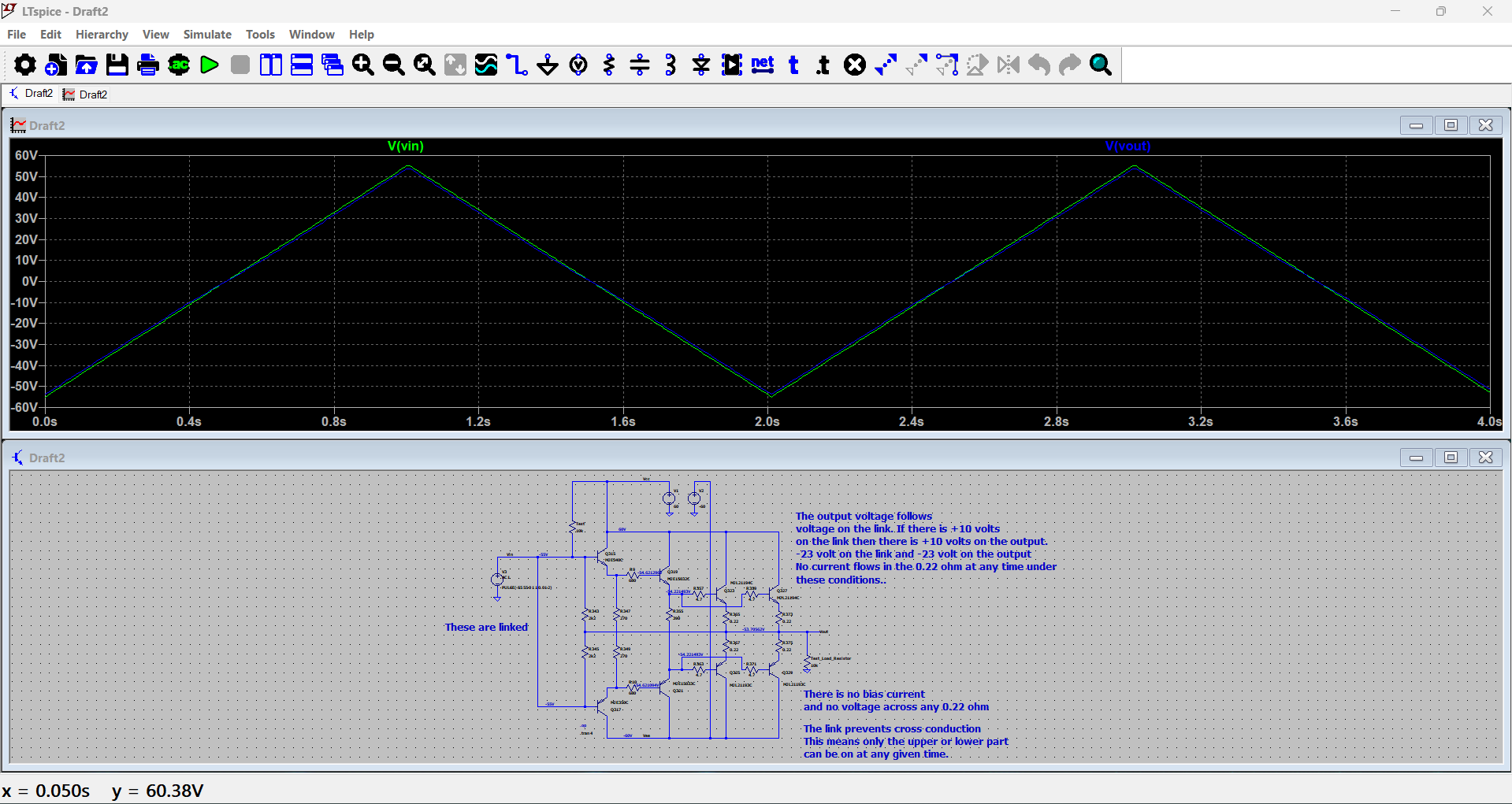

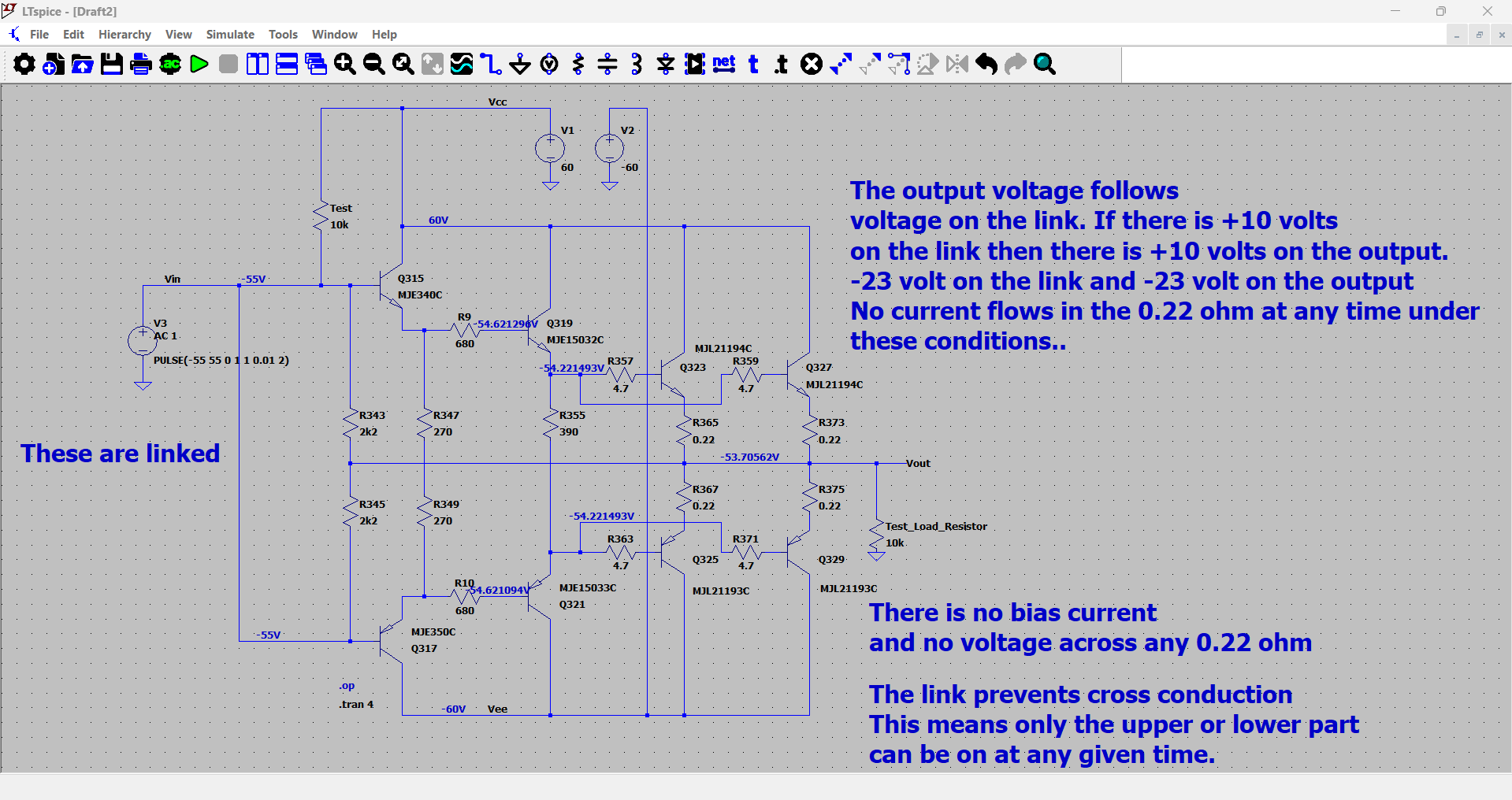

You have to understand how that stage works and find why it draws current. This is what you have. It is a text book emitter follower output stage. If the base of the drivers are linked then the output follows the input of that stage and no current flows in these transistors (unless there is a load on the output).
Look at the input voltage rise and fall from -55 to +55 volts. Now look at the output voltage. It is superimposed on the input because the two follow each other.

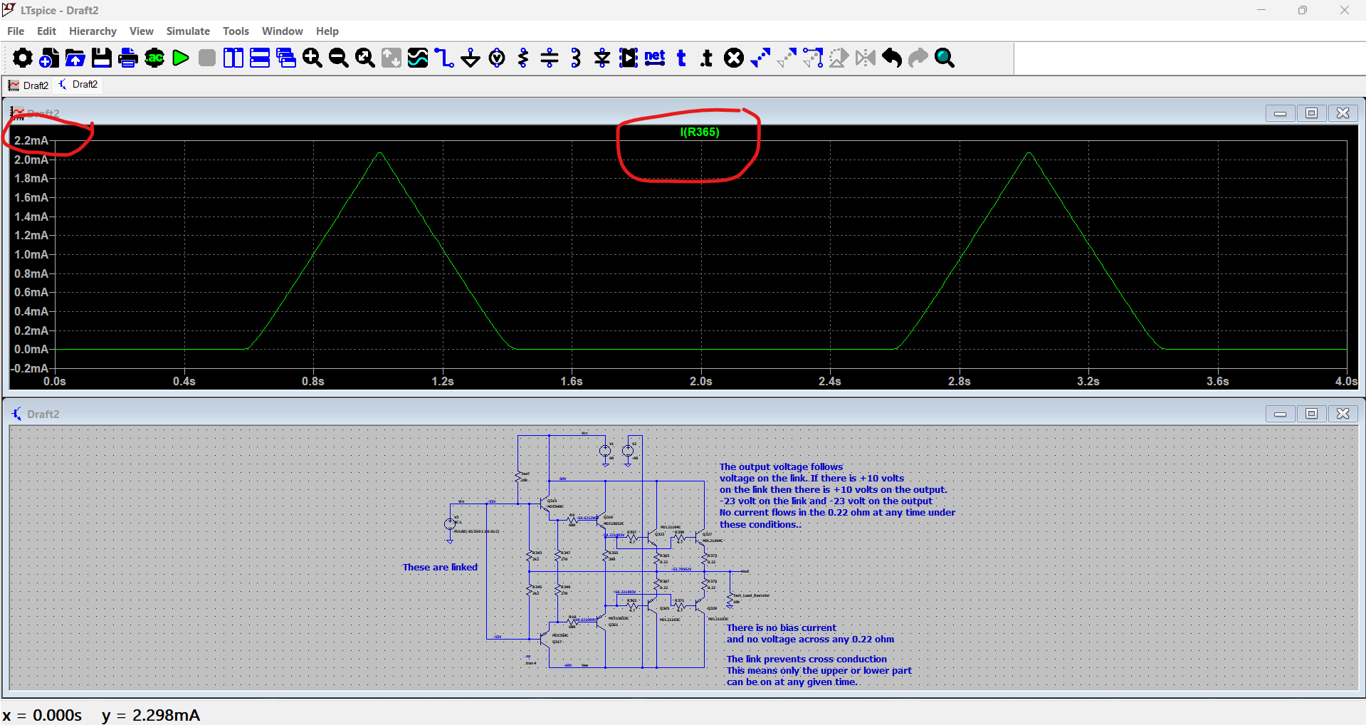

Now look at the current in any 0.22 ohm. Each one would look like this. Just a couple of milliamps here because of my test load resistor. Without that load there would be nothing to see.
The 10k resistor at the base of the drivers in your case simply applies rail voltage to the stage and the output should swing to that voltage. I added the voltage generator as a source to show how it behaves under any possible input voltage. There is no current flow anywhere... unless you have a fault or a short somewhere.

So in my case we have created a zero bias. The 10k resistor you had me install ensures that we have a positive voltage at the base which should result in positiver voltage on the emitters and the output.Since we do not have positive voltage on the emitters or the output and with current flowing thru the .22ohm resistors there has to be a short or a faulty device in the emitters follower output stage. I need to find where that fault is.

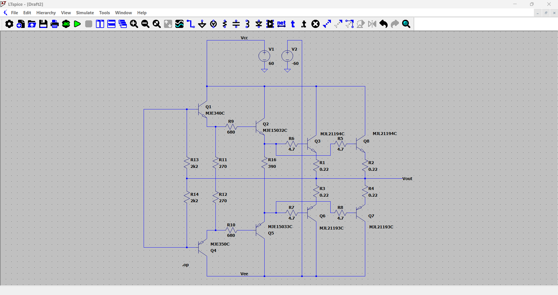

One thing you can do is isolate each 4.7 ohm base resistor. For each resistor you isolate the current in that corresponding transistor and its 0.22 ohm should fall to zero. If it doesn't the transistor is faulty or there is a short in its mounting.
If you do that and then find that R355 or R347 or R349 then overheat (and they should not) then its still a valid test because because it tells us there is a problem around the driver and pre driver transistors,

When you say isolate that means pull the other 4.7 ohm resistors except for the one I am working with?
It just means to remove one from the circuit such as pulling one of its lead out of the board. The transistor it feeds and the relevant 0.22 ohm should then pass zero current.
