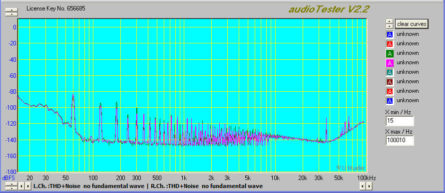

I'm calling the current Dackido setup "Configuration A".
This is a 207v B+, GZ34 tube rectifier, 6n23p-ev/5687 tubes, 10 ma/19mA, LCLCLC power supply as described previously.

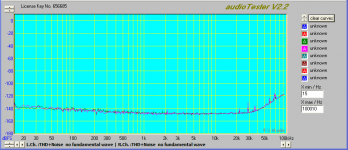

The following chart shows the noise spectra of the Aikido boards without any input, one color for each channel:

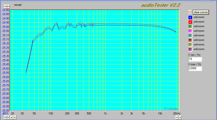

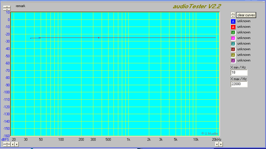

Next I did some frequency sweeps. I found a sweep tone WAV file and played it via the Squeezebox->Pace Car->PCM63 DAC->Aikido.
The AudioTester results appear to work fine above 50 hz or so. I'd like to see levels below that at some point. Here is one view of the frequency response:
AudioTester can also do a sweep on the Audiophile 192 output, but I wasn't able to get this working with SPDIF into the DAC. It's possible that the sweep tones I picked up on the Internet aren't completely accurate in the low frequencies.

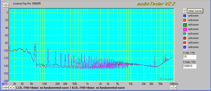

Here is another view, one color for each channel, zoomed in:
Thinking about it more, the reason the test tone is down ~25db is because the DAC is low gain, given the low I/V resistor value. The test tone is probably at 0 db. However, calibration is still an issue because even with loopback testing of the Audiophile card, I'm still under 0 db on test tones.

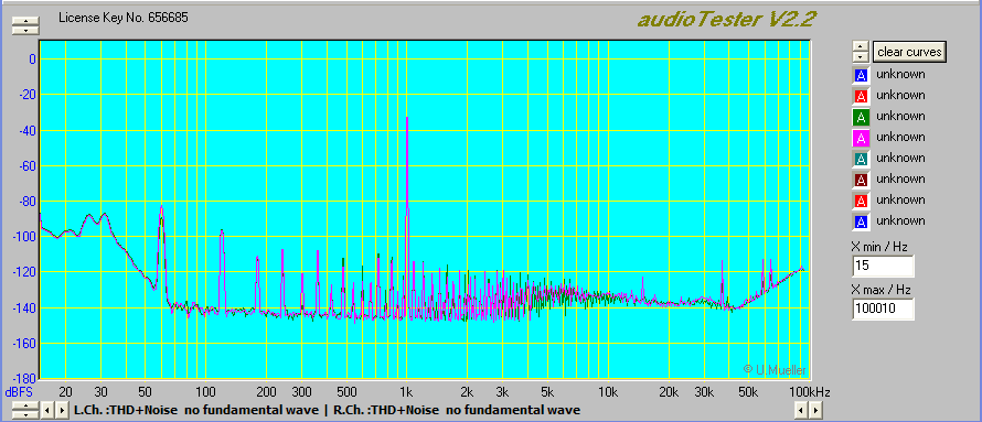

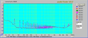

Here is the 0dB 1khz sine tone tested with an EMU0404 soundcard.
And this I took down -20 dB to get the peak at the same height
as yours. It looked like your peak was at -30dB? You seem to have a 60hz hum problem that is carried foward thru all the even and odd harmonics, 60-120-180-240, etc. The Aikido is supposed to have good PSRR so I think the problem is before the Aikido. Your IV resistor may be too low.

Regarding the 60 hz bump -- my next post was going to be entitled "Who you jiving with that harmonik debris? ", with apologies to Frank, but you beat me to it. 🙂

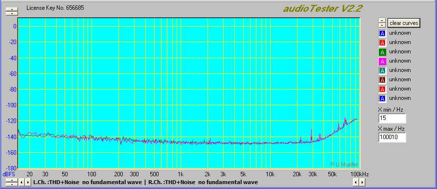

It isn't from the DAC, it's coming via the power supply, I believe. I posted a chart that shows the self-noise of the Aikido. That is without the DAC connected. Same 60hz bump and harmonik debris.
In fact, I'm more confident now after this testing that the I/V is working well since the noise levels are similar with and without DAC connected. Frequency response also looks fine. I do want to try the same testing with the Buffalo because the bass doesn't seem right -- it's possible the Sabre chip doesn't like the low I/V resistor, or there is too much noise not running differential I/V.
The Aikido is supposed to have good PSRR but how come changing the supply noise injection ratio via the pots had no effect that I could detect? Did I build it wrong? Or is the null very narrow? Or something else I haven't considered?

I actually think your THD is even lower than you measured. It looks like you might be running into the noise floor of your sound card. Either that or you are running at 96khz? Also the bass response looks suspect. It would be interesting to see a loopback test chart for reference.

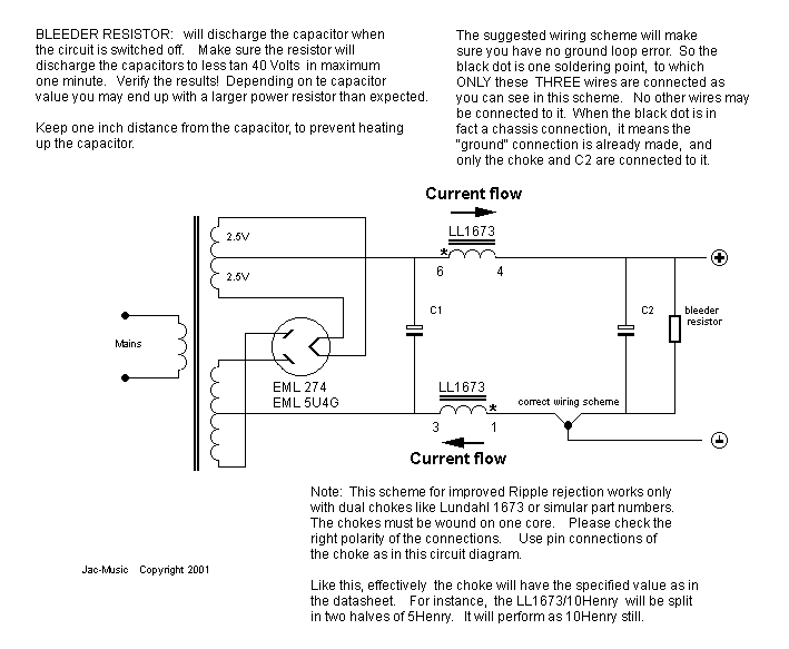

The Lundahl LL1673 20 Henry choke I am using has an interesting feature.
The choke is composed of two 10 Henry chokes. Currently I am running the chokes serially to get the 20 henries. The chokes can also be run in parallel, for large currents, at 5 henries.
But there also a third mode -- as a combination common mode choke, "for improved common mode rejection", and regular choke. One choke is used in the out current path and one in the return path. Ground is not applied until after the choke. Like in this picture from the Emission Labs site:
I'm going to try this mode and see how it goes. I'll measure ripple with my oscilliscope and compare to normal mode. I'll also rerun the spectrum analyzer.

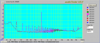

I finally did the CCS Grounded Cathode into Cathode Follower mod. I used a cascaded INX on the plate and just a single on the cathode. Basically Broskie's compound amplifier circuit. Sy recommends it in a few threads
The improvement on the measurements is amazing. THD+N went from 0.22% with the SRPP to 0.03%. Incredible for 40 year old tubes. All traces of power supply noise are gone, I can hear details in Joni Mitchell's voice I never knew were there.
Here is the 1khz FFT, 0dB's.
