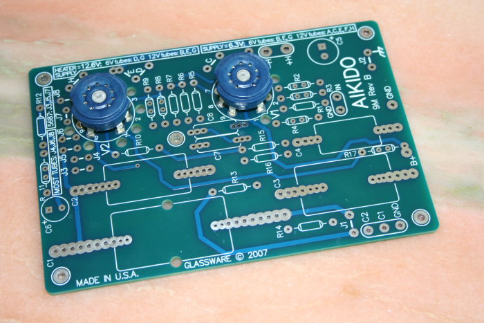

I’ll be using Broskie’s fabu boards. Attached is a picture with composite teflon sockets installed. I wanted to use teflon and was able to find some nice PCB mount ones at DiyHifi Supply:

Here is a question for you. I am looking at the Aikido manual now and there is a cap C3 on my mono board (C5 on stereo board) that is B+ to ground.
What is the purpose of this cap? Bypass of larger power supply final capacitor? Or does it serve another purpose?

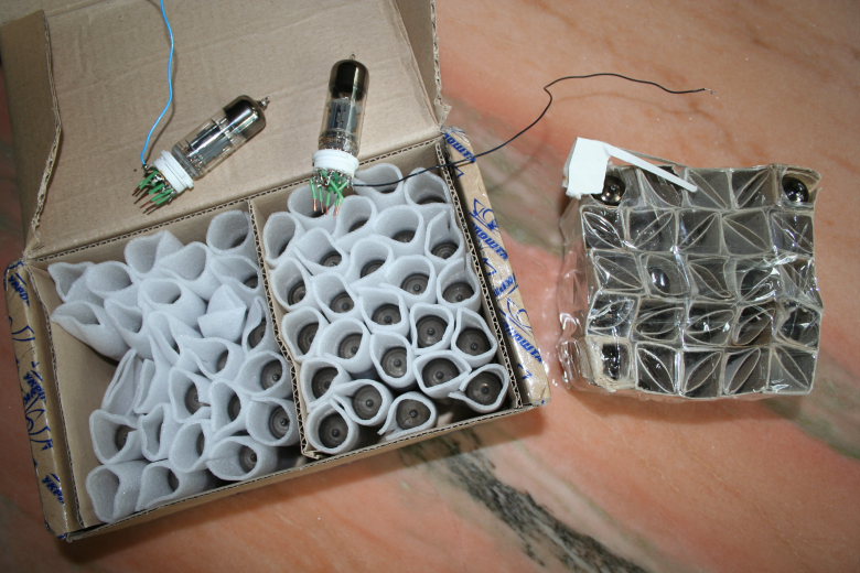

I'm definitely going to try 5687s in the second position, as I like them and have a good variety of them.
I'll also try 6n6ps in the second position. I acquired 75 of them a few years ago in a Ukrainian drug deal gone wrong. I hope they sound good in the Aikido as they are a lot cheaper than Tung-Sol square getter 5687s. See the picture below. The weird tube/socket thingees are 6n6p to 5687 adapters I tried with my tube amp. I may not use the adapters with the Aikido as Broskie provides a lot of configurability and I can add jumpers to the board to switch the heater layout.
People seem to like the 6CG7 in the first position so I'll try a few of those. If anyone has a recommendation for a particular 6CG7 (or 6FQ7) I'd appreciate hearing it.
I've got some 6DJ8/6922/6n23ps so I'll try those in both positions.
My system doesn't need much gain in the DAC stage so 6n1ps probably won't work well. I'll try them anyway since I have some.
I don't know nothin' about the 12**7 valves.
I'm going to install jumpers on the boards so I can clip in different cathode resistors.

Hi Cappy,
your heater current requirement with the tubes listed (6CG7 and 6N6P) will be in the vicinity of 2.8A... Is the Tentlabs module up to that or will you be using two of them?
I'm asking because I once had a look at the Tentlabs also...and the one listed on the Tentlabs site now is only capable of 1.5A max.

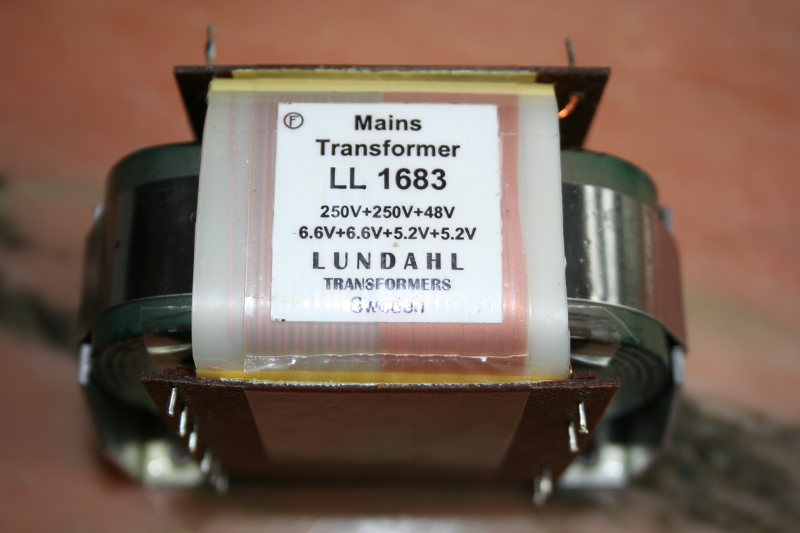

I'll be using a Lundahl LL1683 Power Transformer which will give about 260vac out, given that my voltage is 120vac. With a choke loaded LCLC or LCRC (if the LCLC doesn't sound good) I can get a 210-215 vdc B+. With a CLC or CLCRC I can get 300 vdc B+. I'll probably try both. Does anyone have opinions on the sweet spot B+ for 6CG7 and 5687/6n6p? Steve, it sounds like you found success at 300vdc for 6CG7/6CG7.
Soon I will post my PSUD generated LCLC power supply ideas for a "design review" in this thread.
