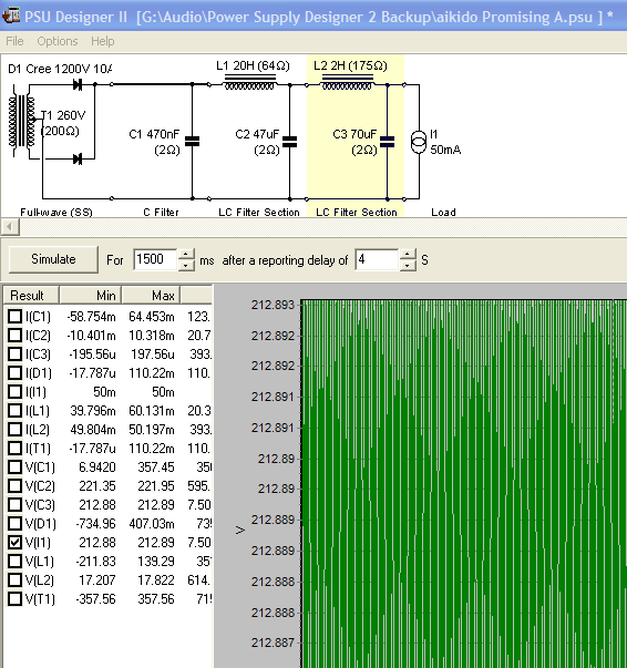

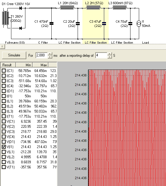

Here is another screen shot of the same power supply. It is a static view. Note the B+ is about 213v and the ripple on I1 is 7.50 mV.
I'll discuss the techniques I'm using to analyze this LCLC supply shortly. I would be quite interested if anyone has other PSU II analysis techniques for looking at the acceptability of a supply. I'm also looking for feedback by more skilled power supply practioners on the goodness of my design for use in the Aikido.

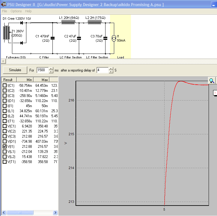

I ran across this post by John Swenson on AA a few months ago:
http://db.audioasylum.com/cgi/m.mpl?forum=tubediy&n=98112&highlight=psud+John+Swenson&r=&session=
It made a lot of sense to me. I had only messed with one power supply previously, the B+ supply in my modified Lite DAC 50, a PCM63 based DAC. I had tuned this power supply by ear. I went back and measured the 10% step response like John suggests and damn if it didn't have the quick move up and the slight overshoot, then the quick damping.

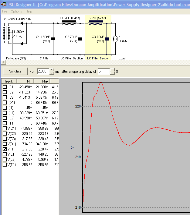

So the above PSUD II charts I posted show an impulse after a 10% step move in current. Basically I am trying to get 1) a non-ringing step response that has 2) a decently quick impulse move, and that is 3) not overdamped or underdamped -- overshoots but damps down quick, and 4) has low ripple.
An overdamped power supply might have a lot of resistance and capacitance in it. The impulse curve has no overshoot and the more damped the slower the move is. These power supplies can sound dull and boring, from my limited experience working with my DAC anyway.
It takes a fair amount of dicking around to come up with a non-ringing LCLC supply (and there may still be impedance or other problems with the supply, more on that in the next post). It is easy to create something nasty like this:

In my last post I mentioned possible impedance issues with the proposed LCLC supply.
The problem as I understand it is the supply output impedance will vary with frequency, where a better situation is more of a "brick wall" low impedance. But that is just theoretical for me until I play around with different power supplies.
My next step is to attempt to simulate the LCLC supply in a Spice program and see what the output impedance looks like. I'm going to build the proposed LCLC supply in any case and see how it sounds.

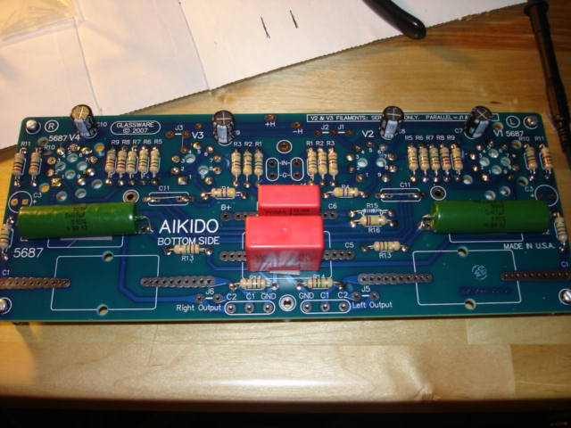

I just started an Aikido build
Hi, I'm new here, this is my first post. I just started an Aikido 5687 headphone amp using 6CG7's and 5687's so this is a very interesting & timely thread. I haven't decided on my power supply yet or my attenuator, so thanks for the good ideas. I'm planning another one with 6H30pi's and 6CG7's. Here's what I have so far. tt

Welcome to the thread. Your Aikido is looking good so far. What type of resistors are those? And what are those exotic green caps?
If you haven't purchased a power transformer yet, and plan to try a choke input power supply, this transformer might be a good fit:

Most of my parts have now arrived so I am going to start building this week. I have a design for an LCLCLC power supply that adds a choke, has the same capacitors, and costs just $25.00 more, but lowers the ripple by an order of magnitude over the LCLC version I posted previously. The impulse response is almost as good. I'll upload the images tomorrow. As usual, any design feedback would be appreciated.

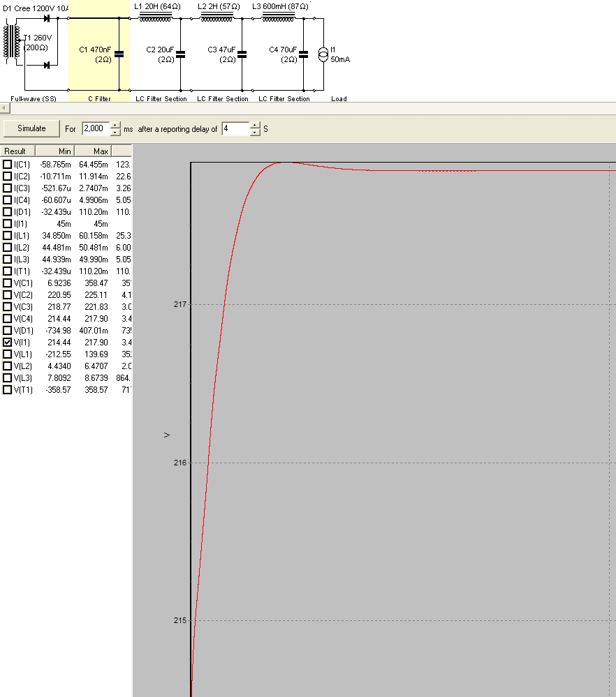

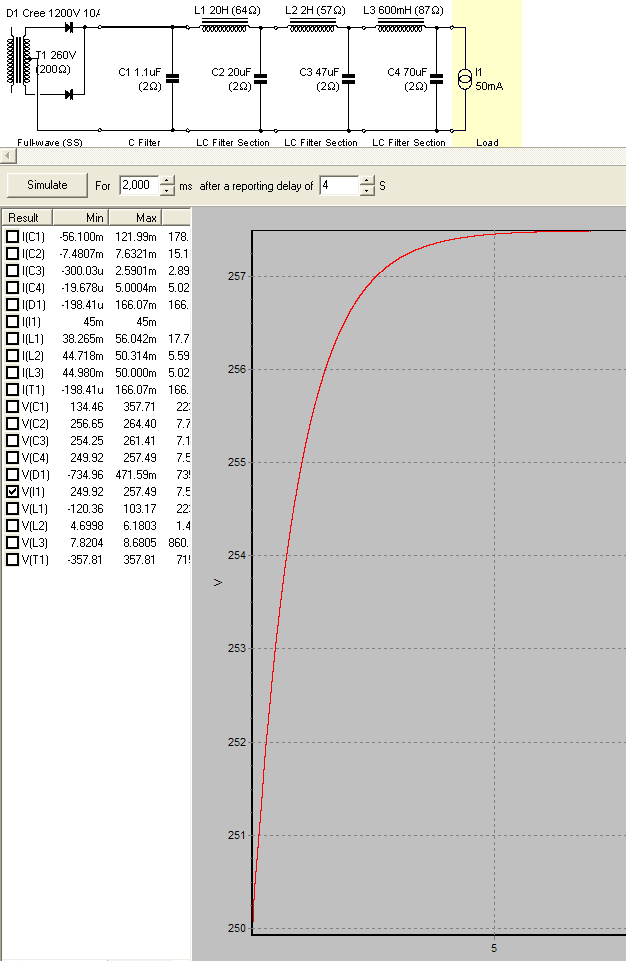

This simulation shows the same LCLCLC supply with the higher voltage Angela transformer. This might be more copacetic with the 6cg7.
I'm guessing at the Angela transformer secondary resistance, so a different value might move the B+ plus or minus 5 or 10 volts.
Both the Lundahl and the Angela have the desirable center taps. Notice I threw in a tube rectifier which drops more voltage than the Crees, but I'm still at about 265 volts B+. I intend to test power supplies with both Schottky and tube rectification.

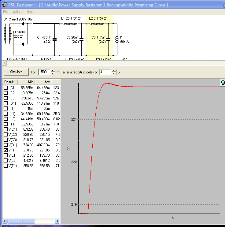

Here is another way to increase the B+ to 250 volts or thereabouts -- increase the first small "transitional" cap. By changing it slightly from 0.47 uf to just 1.1 uF I increase the B+ 35 volts, to 250 volts. Increasing it to 2 uF ups the B+ all the way to 280 volts, which is kind of interesting.
Well, that seems like a good way to tune the output B+ voltage for a given power transformer. But is there a catch? Well, maybe, since the impulse response goes to hell. Ripple gets even better though. Does it matter in practice if the change in current is slow? No idea at this point, so I'll try it. If anyone has insights I'd like to hear them. Here is the slow impulse simulation with the 1.1 uF first cap:

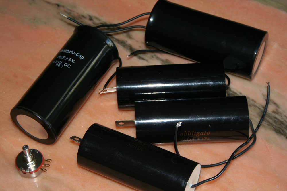

The BOM for the power supply currently is:
Lundahl LL1683 power transformer or
Angela Instruments Universal power transformer
Lundahl LL1673 20H choke
Hammond 157R 2H choke
Hammond 153N 0.6H choke
Diy HiFi Supply Obbligato 47 uF Film (500v) and 70 uF (630v) film/Oil caps
470 nF Auricap (since I have some -- don't know how they sound -- I've heard this small cap is important so I may try others)
20 uF cap composite of smaller Solen and Obbligatos I have lying around.
No electrolytics will be used in the power supply.
I think the Obbligatos are excellent in power supplies, based on a bunch of them being in my Lux 300b amp. I also have a 70uF Obbligato in the B+ of my SRPP stage. I'd have more in there, but I could only cram one in the chassis -- they are big. The picture shows the 47uF film power supply caps and the 70uF film/oils.
The potentiometer in the picture is a PEC 100k pot, which will replace the R15 resistor that adjusts the voltage divider that controls power supply noise to the top and bottom triode's grids. It allows on-the-fly adjustment for lowest noise with different tubes.
