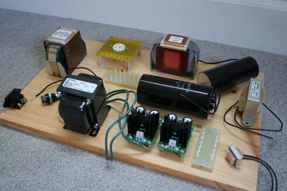

Here is a picture of the power supply prototype with parts laid out on the board. Swapping between the Lundahl and Angela power transformers will give possible 260, 320, and 380 volts AC input. This seems like a good range as a test bed for various vacuum tube output stages I might want to try. For the Aikido, it will allow voltages from 200 to 300+ volts:

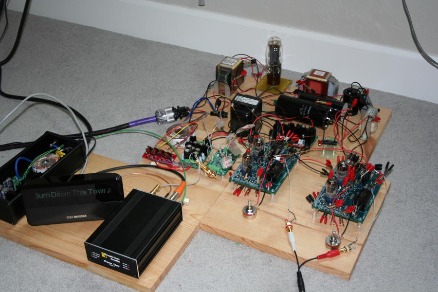

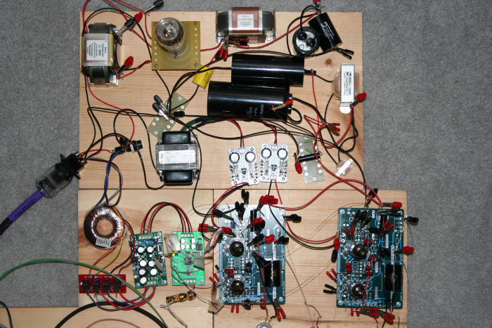

I got the project up and running today with the Twisted Pear Buffalo DAC. There have been only a few issues so far. A visual inspection of the running supply noted no obvious resonances that caused the board or parts to shake uncontrollably, such as occurred with the first Tacoma Narrows Bridge in 1940.
Here Be Alligator (clips):
The B+ power supply came up perfectly the first time. The first issue was with the heater supplies -- I couldn't run more than 1.2 amps on each heater supply without making the voltage stay pegged at 5.6 volts - it could go no higher. So I swapped out the 6CG7s for position 1 and put in some 6n23p-evs. This got the voltage up to my target 6.2 volts. By the way, one nice feature of the Tentlabs IDHT supplies is the ability to dial in whatever voltage is desired. Position 2 is currently running Tung Sol 5687s. The filament transformer is putting out 6.95 volts under load, probably not enough for the TentLabs supplies at 1.5 amps. I'll get a 10v filament supply shortly and use some drop resistors. That way I can play with 6cg7s and 6n1ps in position 1. Later I will use the transformer for my next project in the fall, which is a 10y output stage using the same "semi-universal" power supply.
Second, getting the cathode resistor values to get Broskie's suggested 10 mA on 6n23ps and 20 ma on 5687s took a bit of tweaking. Currently the B+ is 210 volts. The resistors are placed in parallel to get appropriate values, a mix of Shinkoh tantalums and Rikens on position 1, Shinkohs and IRCs on position 2. I can tell I'm going to need more resistor values since I'll be playing with a lot of different tube types and B+ voltages.
Third, dealing with the plethora of alligator clips on the Aikido is a bit hectic. So far so good, though.
I am running right now throught $59.95 Cambridge Audio computer speakers but I can tell it is going to sound ***NICE***. Currently Rosanne is singing sweetly but throatily about her Dad. The next step is to move everything into the listening room.
Those pots are not volume controls, they are there to tweak the power supply noise to get the lowest PSRR.
The output of the Buffalo is going through Mill resistors for passive I/V, and then on directly into the Aikido position 1 grid. The grid stopper in combination with the Miller capacitance of the tube is providing a mild -6 db low pass RC filter. There is no other post-DAC analog filter at this point. The DC offset of the ESS Sabre didn't seem to change the bias point of the 6n23ps.

I was able to move the project into the main listening room. The 205v 6n23p-ev/5687 10mA/20mA Dackido is sure sounding good.
Thanks for the link. Those Hashimotos are cool, kind of a Yves St. Laurent look compared to the Jame's Versace. 🙂
For choke input and 6cg7s at 250-300v the PT-160 or PT-220 might work better.
At this point I see no need to add a discrete analog post-dac filter as the Aikido's "implicit" one seems to be working well.
I mentioned that it is a slow rolloff -6 db filter in an earlier post. Thinking about the filtering in the shower this morning, I realized it was actually steeper. The Aikido has two stages, so I believe it is really a two pole RCRC filter. This is a nice "feature" of the Aikido for a DAC output stage.
The Buffalo has smooth but resolved and extended highs. No 3-5k glare. Violins have bite but are not boorish. Buffalo basically does boffo upper midrange/treble.
I attribute this not only the the Sabre chip, but also to the Buffalo's fine layout, parts choices, and power supply. The power supply is an amazing bargain for a dual CLRC supply.
