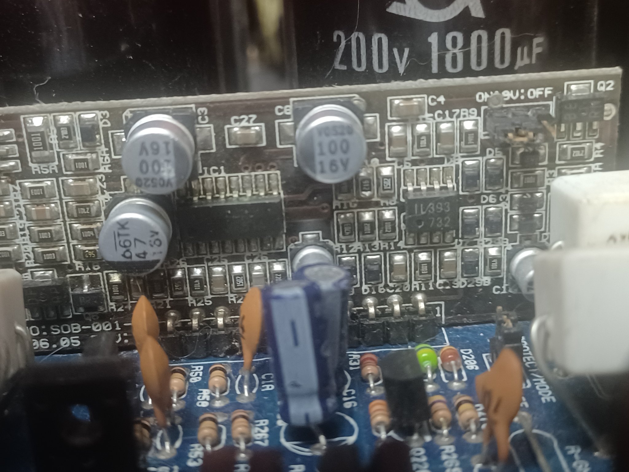

XXV Sampson power up issues

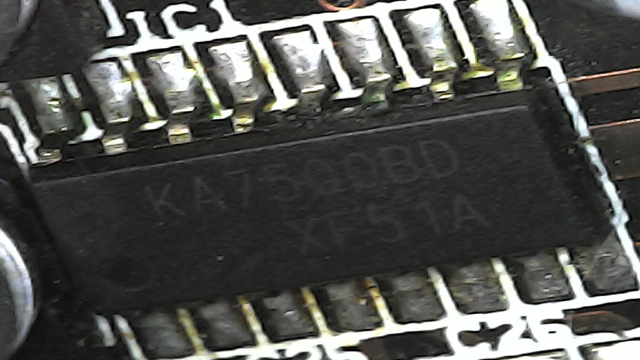

understood, yes it does. Do the PS drivers get their voltage/signal from the driver IC on the driver board? The IC that's labelled KA7500BD? Digikey says the part is obsolete but the TL494 is a good replacement and I have some on hand if needed
do you think I should replace that KA7500B or what ways can I test it?

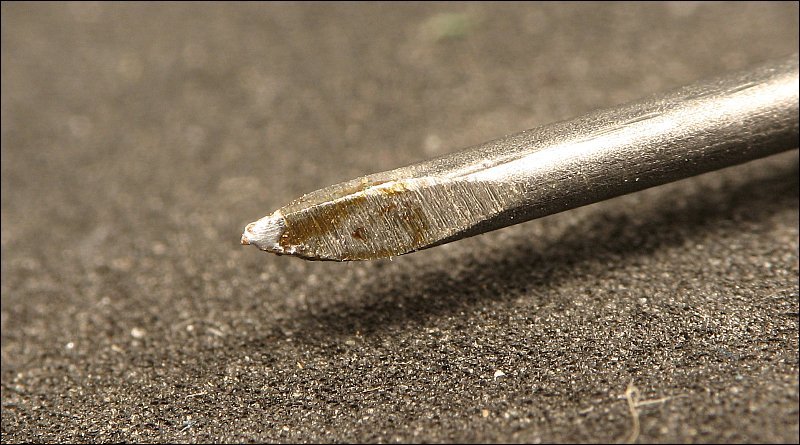

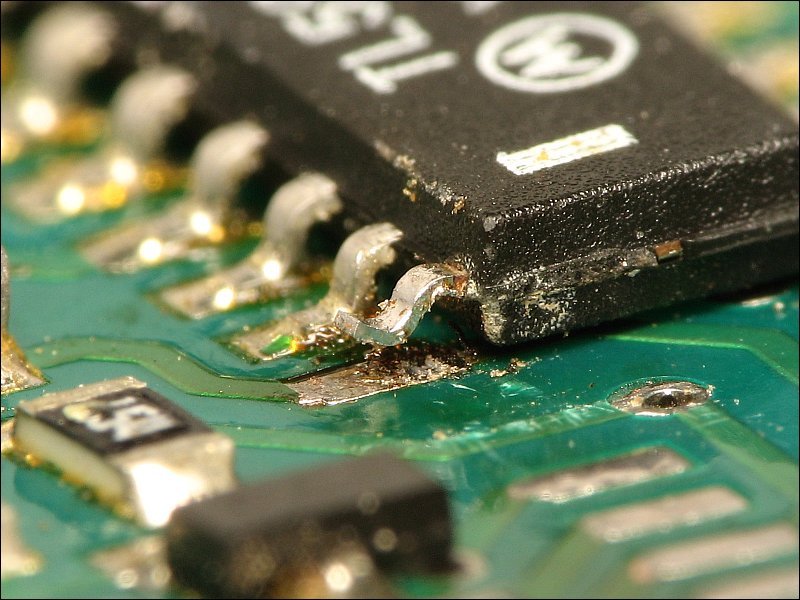

You can do it. Since it had been many years since I had to do this, I made sure that it could be done with a center terminal today and it works. When doing this, I use a tiny jewelers screwdriver ground as shown below. The screwdriver I used was 1mm/0.04" in diameter. Try it on a junk board if you have one laying around.
