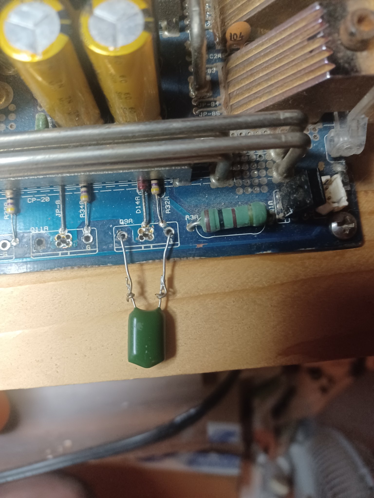

i recently replaced all KTA1072/KTC3228 driver transistors(3 banks of 8). There are no supply, output or rail Fets on the board. I apply power to the amp, the output relays click on. I have a Hantek HT6022BE PC based scope, DS201, and DS203. I'm trying to get the amp back to working order after being dropped to my floor pan during an install. It slipped from my nephews grip and fell about 2-3 inches. Still installed it and didn't power up. I just tested the PS drivers

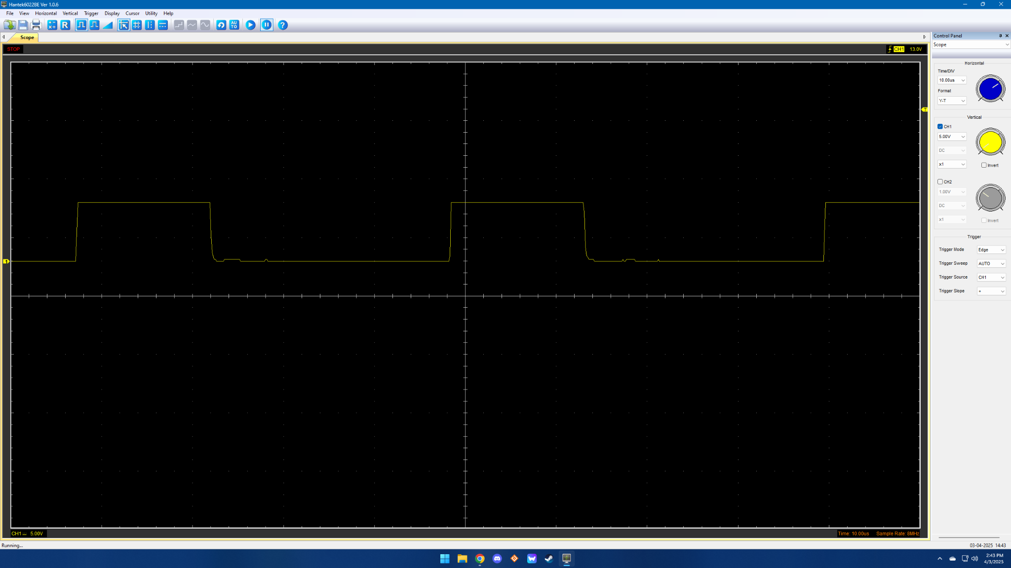

Connect it across the gate and source terminals and while it's connected, check the gate signal .Confirm that all are the same.

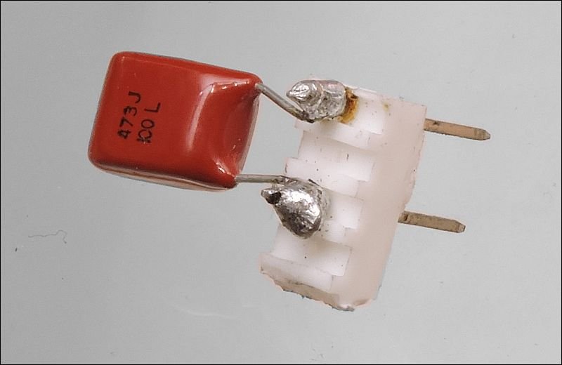

If you mount it on a piece of header (or similar) and put a small amount of back force on the header, it will make a good enough connection to check them without soldering.

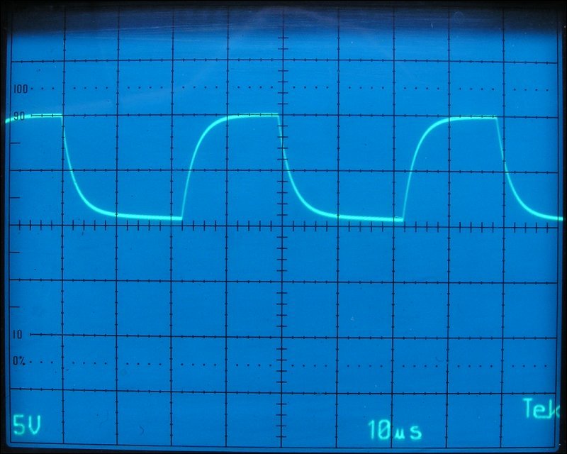

The waveform should look something like the attached waveform. Use the scope in the same settings, and DC coupling. Align the trace to the reference line before starting.

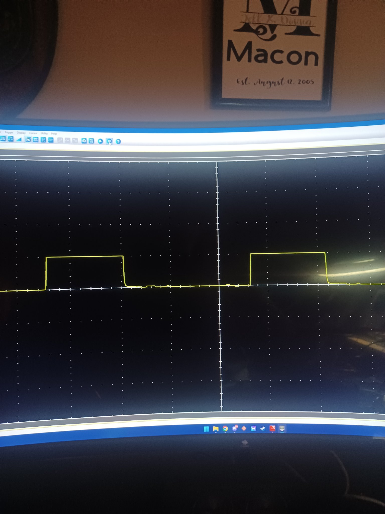

You need to set the scope to 10uS/div and 5v/div and DC coupling and confirm that the trace deflects up approximately 2.5 major divisions when touched to the B+ terminal of the amp.
What do you get on the scope when touching the probe to the output terminals of the PS driver IC?
