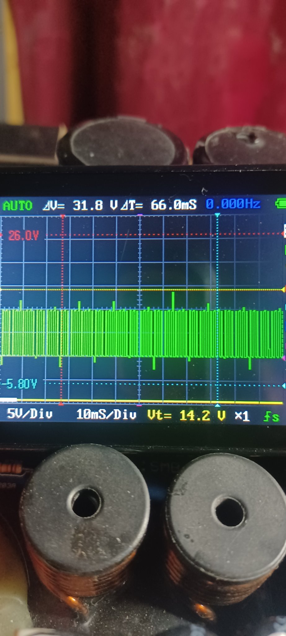

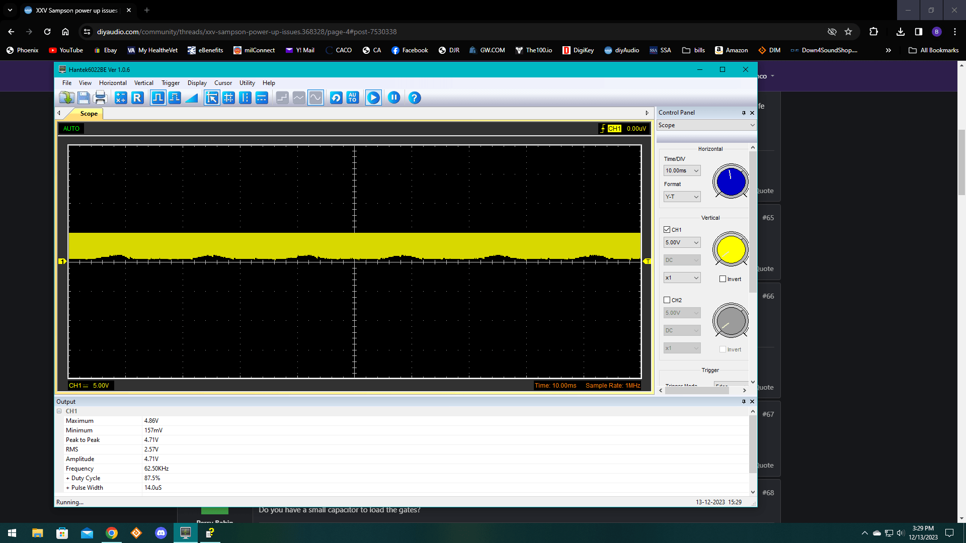

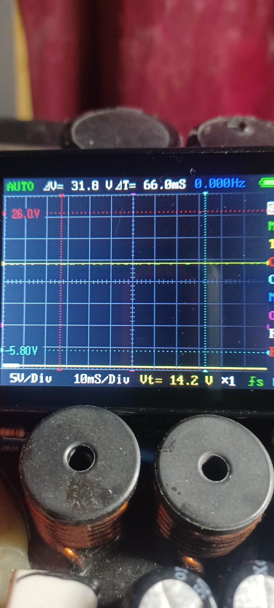

To test the scope, probe one of the output terminals of the driver IC and post the image. Set the scope to 5v/div and 10ms.

no FETs are in it yet. I was just about to take a pic and the scope died so it's charging now. Each center leg location for the FETs read the same so i'm hoping that's a good thing.

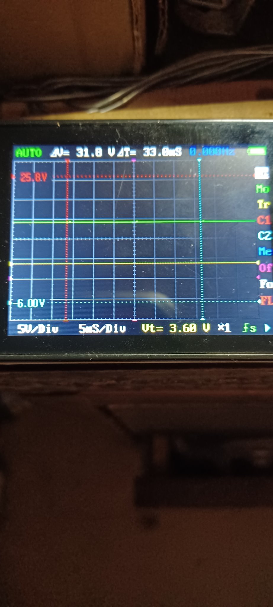

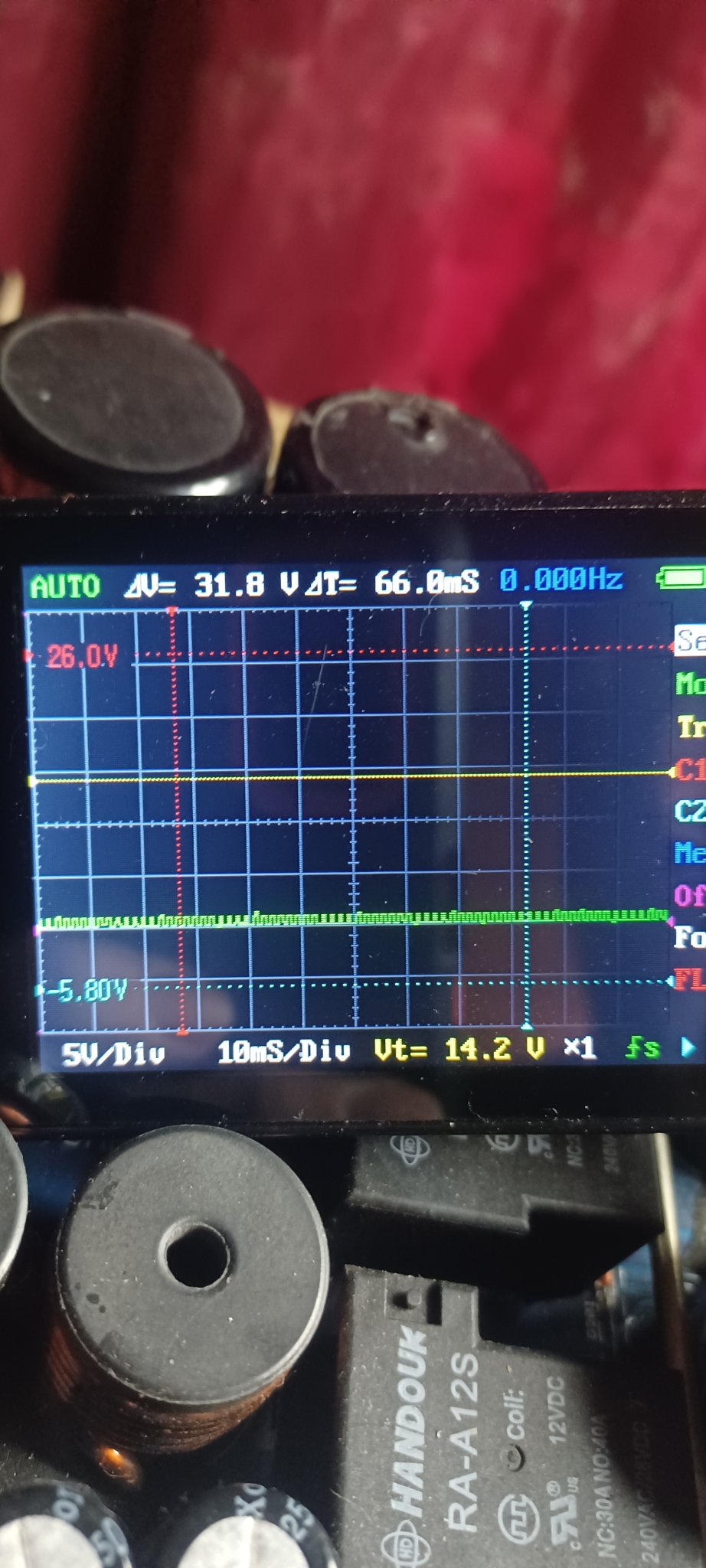

That's nothing. You couldn't get 5v+ on a meter from that. With the same ground, touch the probe to the B+ terminal of the amp and post a photo.

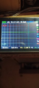

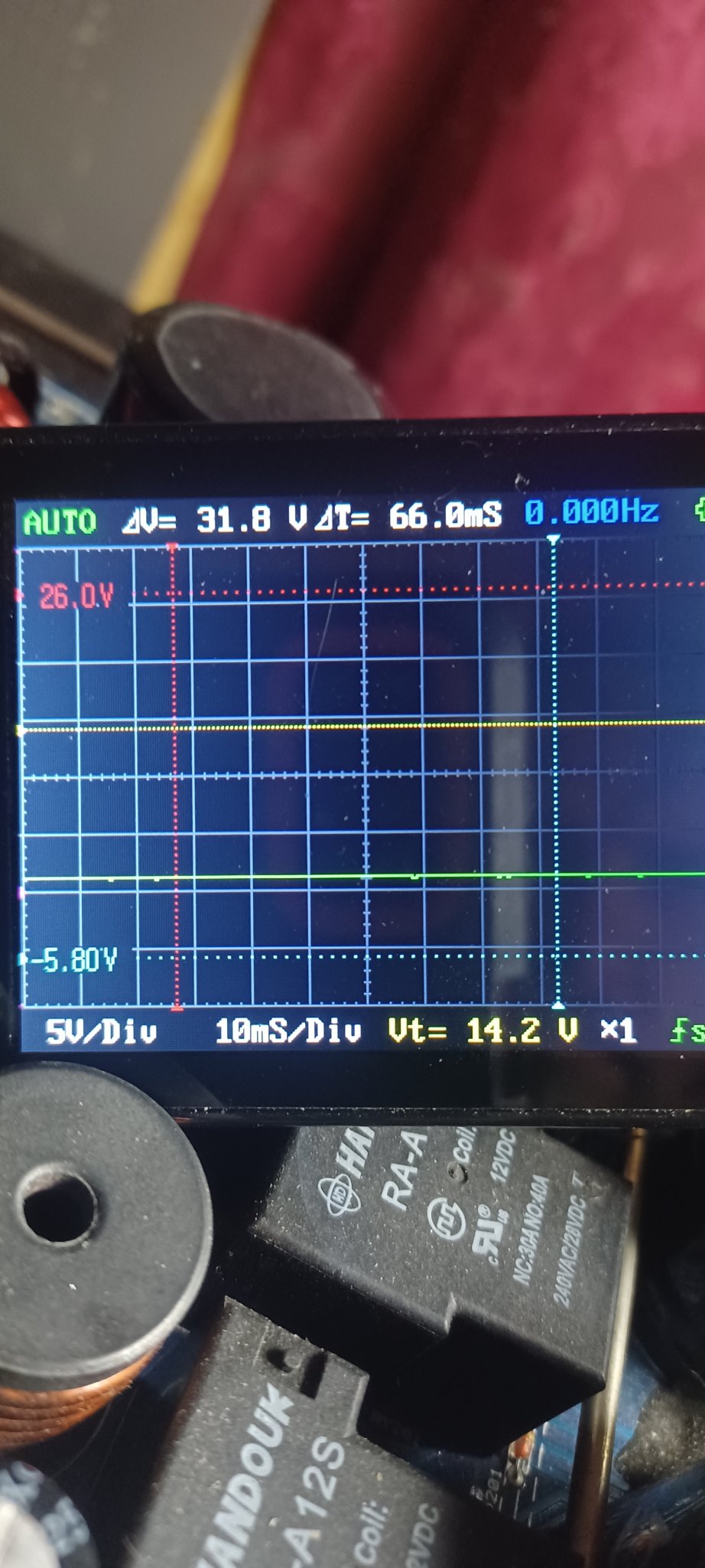

I adjusted everything I could but couldn't get anything besides a flat signal, changing the time/div did nothing either, this is grounded on amp ground and probe to amp +. I tried both of my pocket scopes and got the same results. The switch on the probe set to x1. I've tried to send this all day but for some reason i couldn't reach the site
one more thing, how do i know when dc coupling is set on this scope? There is no setting in the functions to activate it. It's a DSO v201 by Seeed Studio
If you are on DC coupling, the trace will deflect up, off of the ground reference.
You are looking for a lock on the waveform, not on B+. Post a working link to the owner's manual for that scope and I'll try to find it.
