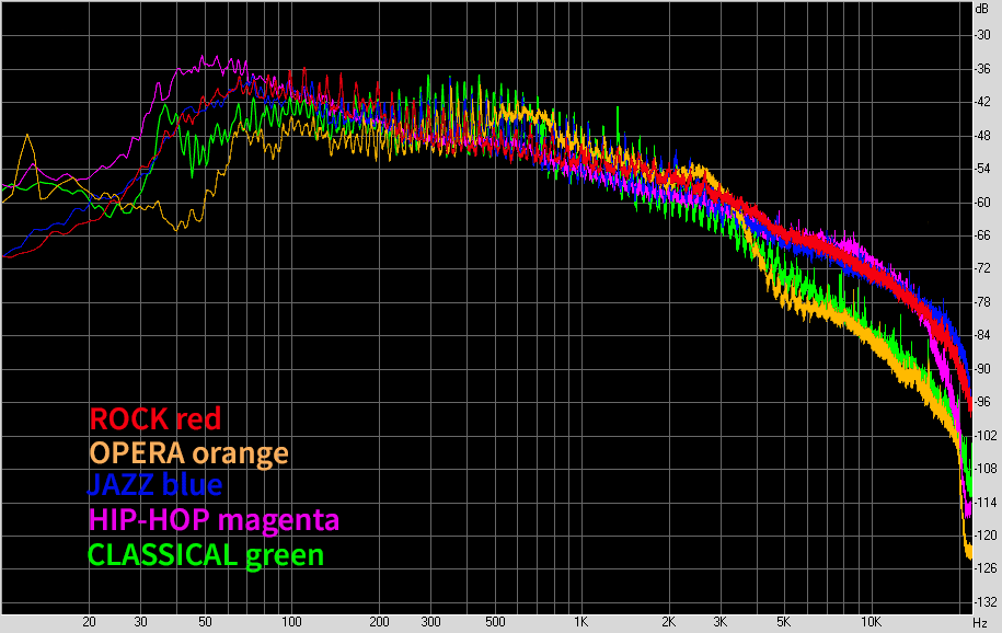

Now the second issue is the one Allen has brought up which is that in most recordings, the SPL levels across the frequency range are not equal. If you look at that same graph from post #74 (re-attached below), we see that after about 100Hz, the SPL of the higher frequencies are falling somewhere between about 3 and 6dB per octave. (I'm still trying to wrap my head around this one because it's here that I would expect to actually see the effects of the Fletcher-Munson curves. So what's happening in the HF's I find confusing.)

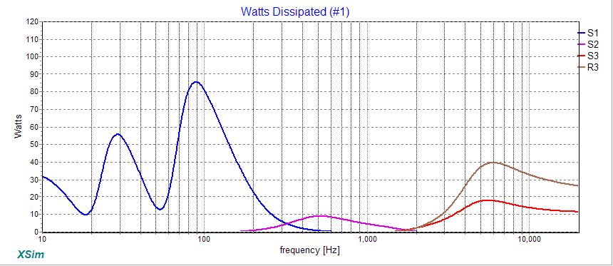

So how much wattage do you really need on that resistor in the real world if we go by that FR chart? Let's go back and see what XSim is telling us. Here I've used 60W as the input. Looking at the power chart again, we can see that the peak wattage consumption is at about 6000Hz. Depending on which genre of music you look at, 6000Hz is about 24 - 36dB down from its level at about 100Hz. If that frequency is in reality going to be about 24dB down from what XSim is showing us, then it will only need about .13W (start by using the 40W the resistor sees and then halve the power every time you reduce the SPL by 3dB). So clearly a 10W resistor for R3 is going to be fine under these conditions.
But now the question becomes, what if we operate outside the averages? What if you have very elevated levels in other types of genres, like movies as Douglas has pointed out, and how much is that peak level above the average ever going to be at the frequency we are concerned with. If they are twice as loud that would be another 10dB. Twice as loud as that again would add another 10dB. Is that realistic enough? If we want to accommodate for a possible extra 20dB that means that our wattage usage in that resistor will now go back up to about 20W.
Better to be safe than sorry.
At least, that's what I can put together at this point given my own level of understanding.

Not inaccurate... although perhaps a bit beyond common understanding. Certainly what you guys came up with is not an uncommon circuit in a crossover.
Here's the thing ... when an LC circuit approaches resonance it begins storing energy. Below resonance the coil is conducting most heavily, but the capacitor is storing a charge from the coil. Above resonance the opposite happens, the capacitor is conducting and the coil is storing a charge.
At resonance, these stored charges align out of phase and begin to circulate back and forth between the coils and caps as the input polarity reverses, like the square ball on a Pong game. The more attuned they are the bigger this exaggeration becomes. This is called the Q or "quality factor" of the circuit. The higher the Q --the more tightly tuned the parts-- the more exaggerated the response.
For a bandpass filter this causes it to take on a very low impedance. For a bandstop filter we get a very high impedance. ... well beyond that of the parts themselves.
R3 in Montana's and your designs ended up being a "doping" resistor that detuned the resonance effect... but it did it by absorbing all that circulating energy from the coil ... hence the high power dissipation.
If you look at the third thumbnail in my earlier message where I took it out of circuit, you can see just how exaggerated the resonance effects are in that circuit. Most of that resistor's current was *not* coming from the amplifier.
I realise the resonance at that point was a total accident... but there's no denying it's effects or the risk to the tweeter if R3 was to go open. Although the top is cropped to show the lesser currents... the tweeter could have seen upwards of 100 watts as it now took the brunt of the stored energy at resonance. (Yes, designs should also consider Failure Modes)
Even at lower powers and with musical decay... you would still have a lot of circulating current in that part. I certainly would not put a 1 watt part in there... it would probably last just about until the first good symbol crash or police siren.
It is, I think, a good idea that people should read up a bit on resonant circuits and understand just how they can surprise you... There's a good tutorial HERE There are about 5 pages after the first that you need to at least look at to get the whole picture.
Now don't get me wrong ... I'm not blaming or finding fault. I see this kind of thing all the time in lots of different places (not just crossovers) and it does take a somewhat experienced designer to spot it.

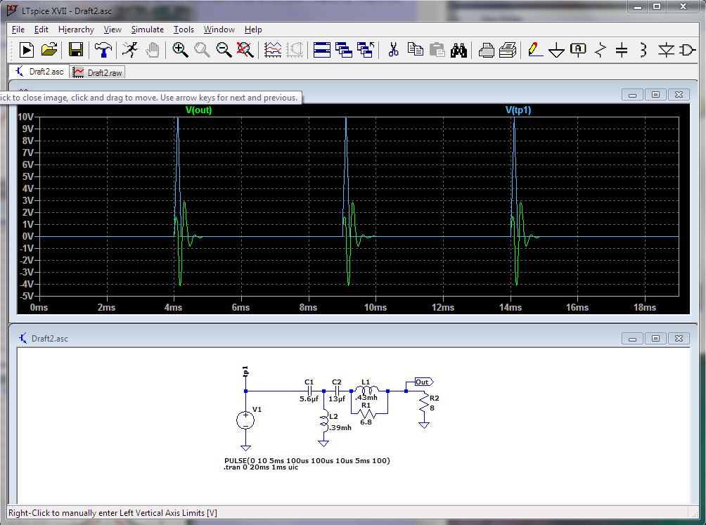

Okay... I sketched the tweeter circuit up in LTSpice and ran a transient analysis on it...
The blue trace is a single pulse applied to the input
The output is the green trace.
Given that it rings for almost a millisecond... I'd have to say "Yes it is going to be audible".
