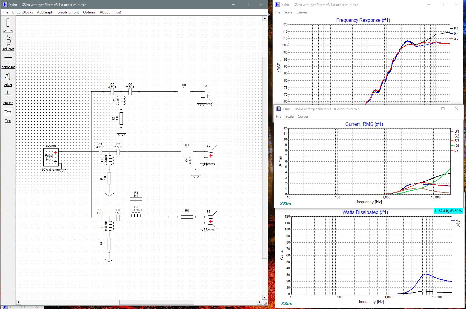

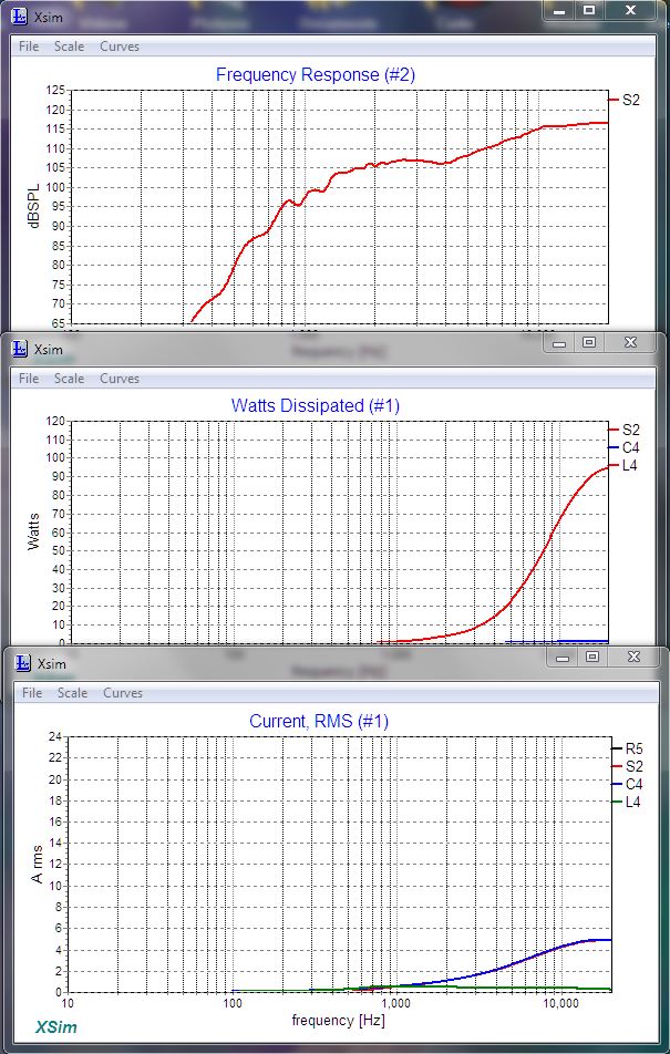

Pic 1 below shows the effect of the 47uF series HP capacitor on the FR in black. That's the ugly peak that results at about 100Hz. Adding an impedance compensating filter solves the problem (pink trace) but look at the values required. Not inexpensive. Now let's look at Rich's very elegant solution. He has combined a single resistor in parallel with the 1st shunt capacitor in the 4th order LP filter. The result in blue is that the resonance peak is taken care of, the response is actually also flattened out meaning you need to ask less of the rest of the LP components and the overall level is attenuated as well. That's 3 functions in just 1 resistor for a buck or two. That is perhaps one of the most efficient uses of a single component I have ever seen in a xo filter. Very, very nice.

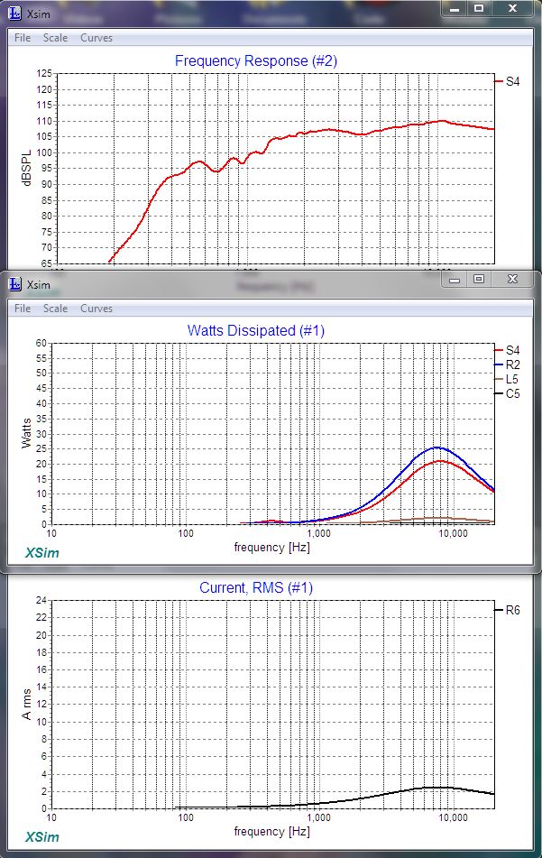

The other problem Rich had was his waveguide tweeter response which had an ugly rising response after the HP filter was added (pic 2, black trace). One way to solve this is to add in a shunt capacitor which will act as a LP filter dropping the rising response (blue trace). The other option was an LR parallel combination in series with the tweeter which works as a shelving LP filter. It solves the rising FR problem nicely while at the same time also attenuating the small peaking that was still present around 2800Hz (red trace). That flattens the response out just about perfectly. Which one is better will depend on what the FR looks like to begin with.
However, we should note that those 2 options have different electrical results. In the case of the capacitor, the result is a current draw that is rising steeply in the HF's. In this case I'm giving it 50W and if that's all that the ampflifier can produce, its maximum current is going to be 3.5 amps into 4 ohms which will in fact be exceeded. A 100W amp minimum with 5 amps od current available into 4 ohms will be required.
On the other hand, the LR filter has no current draw problems but the resistor sees a whole heck of a lot of power running through it, about 30W when we are feeding the speaker as a whole with 50W. In contrast to the usual statements that a tweeter filter won't see that much power, here you are going to have to make sure that this resistor can handle this high wattage. Adding resistors together in parallel to get the correct value will do the trick if a single high wattage one can't be found. How high the wattage rating needs to be will depend on how much power you actually think you will be using.

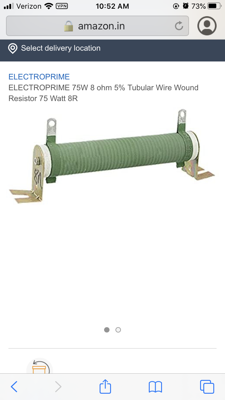

Based on the above statement by jReave, I found a high watt wirewound resistor that might work for this application. I have attached a photo so others with more experience could let me know if it would work better/or at least as well as stacking several 10 watt resistors together.
Best,
Rich
Rich, from what Douglas has said above and (in these posts), XSim does not give realistic figures and your resistor is more likely to see much less than 1W at full power based on 6kHz.
There should however be no harm in using a higher power resistor.
[P.S. XSim is not inaccurate, this is a matter of measurement context]
Thanks Allen,
That is good to know. I probably will go with the higher rated resistors since they are not terribly expensive.

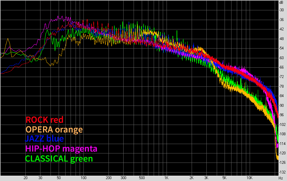

Allen is correct, normal musical decay does reduce demands on high range parts some what... but music is highly variable and not all mixes will follow his averages. So, lets ask the question of what happens if you do send it a full power sine wave sweep from software like REW or a signal generator. Yes, we can accept that most parts have brief tolerances for over-power. But rather than randomly counting on that, lets do a little circuit analysis...
(If nothing else this should be a good learning experience...)

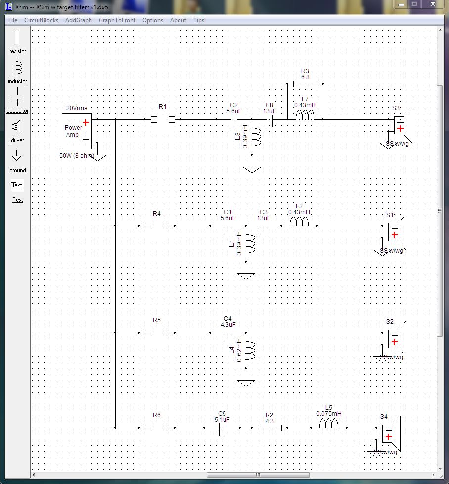

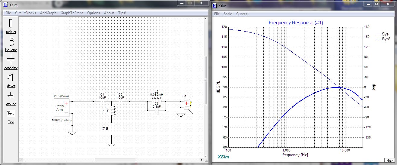

The first thumbnail is the XSim schematic we'll be tampering with. I've also included the DXO so you can play with parts values if you like. I've set the amplifier to 50 watts for this.
To activate each section, switch the lead resistors from open to short.
Be careful to note the left side scales on the rest of the panels as I had to adjust them for some of the examples.
The second thumbnail shows what happens when you enable the top filter, which is yours from your last version. Nice frequency response, btw. But lets look a little deeper into what's happening. Notice that R3 is burning up a lot of watts. Interestingly it's burning more than the tweeter, even though it's in series with it. Also note the currents and how they peak with R1 handling less than the sum of S3 and R3 ... This is indicative of resonance effects.

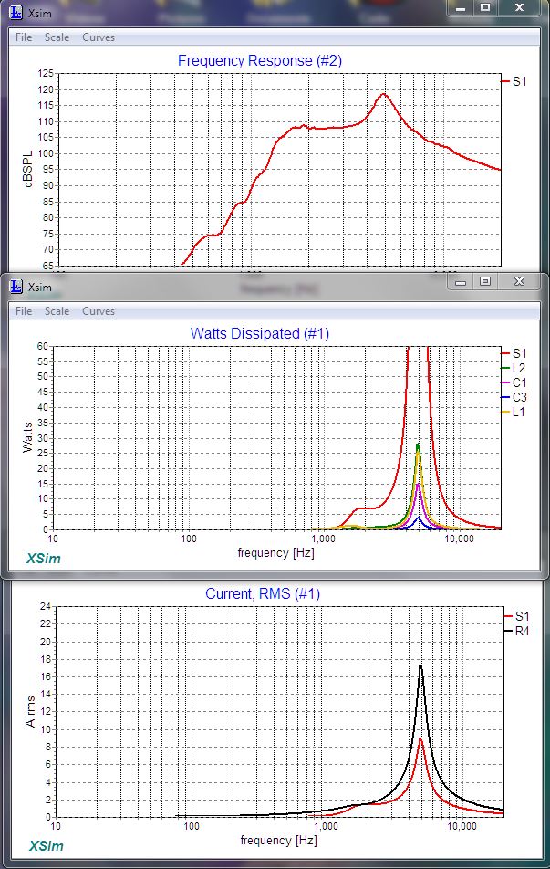

The third thumbnail shows us what's going on. I activated the second version and removed R3, and look what happened... The entire tweeter circuit has stopped being a high pass filter and is now a resonant band pass filter with a very high peak in both current and power dissipation. especially on the tweeter ... enough, in fact, to kill it. The current chart tells us that a lot of power is being drawn that is not reaching the tweeter itself. This scenario could actually happen if R3 in the top version was to fail.
We wouldn't actually use this circuit. But, what we can take from this is that the tweeter circuit is a resonant bandpass filter with R3 doping it down to a very wide bandpass and taking the brunt of the circulating currents to do so. Hence... monster resistor time.

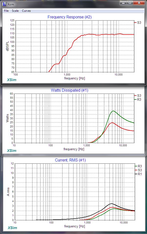

Okay, now on to the fourth one. This time I've enabled the third drawing... a bog standard 2nd order filter. The first thing to notice is that the wattage has tamed itself down very nicely and the currents are pretty sane... but UGH what a horrible frequency response. It's up about 10db at the end.
So, how to fix this? The last thumbnail shows an unusual circuit the last one on the schematic, all in series... The frequency response isn't a dead straight line but the biggest errors are in parts of the audio spectrum where A) there isn't much content and B) only the neighbourhood dogs are likely to hear it. It's within plus and minus 3db, so perfectly acceptable. Also note that the wattage load on the components is greatly reduced, R2 is down to 25 watts, the tweeter is getting most of the power and L5 is taking only a small hit as it trims down the response in that last octave for you. So now you can use that 10 watt resistor without worrying about cooking anything.
Here's the thing ... coils behave the same no matter where you put them. If a big one will attenuate higher frequencies from a woofer, a smaller one will do the same from a tweeter. If you aren't hell bent on that perfect straight line, getting "close as makes no difference" can greatly reduce the risk of things going wrong. Plus, if any of the parts in that chain were to fail, your tweeter would simply go silent and probably survive it.
