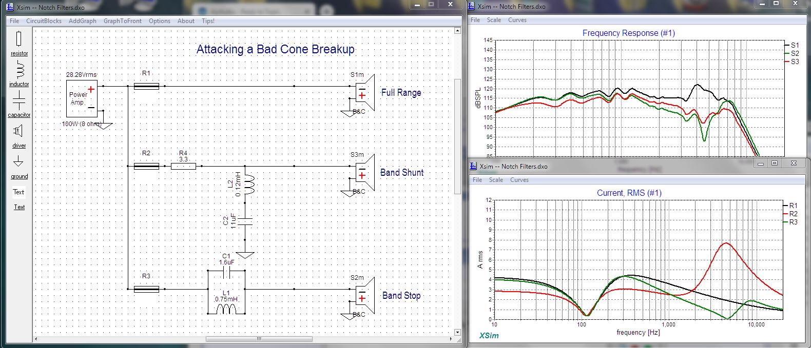

I've been looking at the schematics so far and I can't help noticing that midrange driver as a seriously nasty breakup at about 3500hz.
The best way to attack this is to notch that frequency off of the driver, so that it doesn't break up. But there's more than one way to skin that cat.
In the thumbnail below I have 3 plots for you.
The first one shows the speaker being driven full range, so we can see the cone breakup. (Black)
The second one shows the usual shunt notch filter and the way it reduces the breakup. (Red)
The third trace shows you an inline notch filter and how it reduces the breakup (Green)
Now comes the surprise... on the current panel you will see that the shunt filter causes a huge whack of current, which is just wasted. But take a look at the inline filter... the current actually goes down and the notch is deeper.
Guess which one I would recommend...
If the filters are too sharp you can add a resistor in series with the shunt filter or you can add one in parallel to the inline filter. Either way will broaden the response a bit.

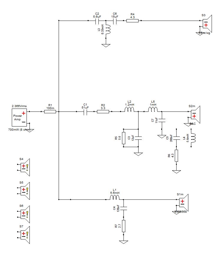

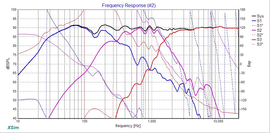

Hi Guys,

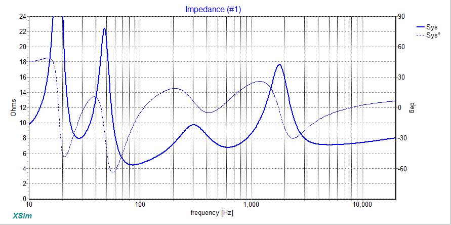

Here is my first stab at incorporating some of the ideas that you have put forth. My head is starting to swim.😀 @ Douglas Blake: I will look to add your method to address mid breakup tomorrow.

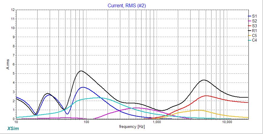

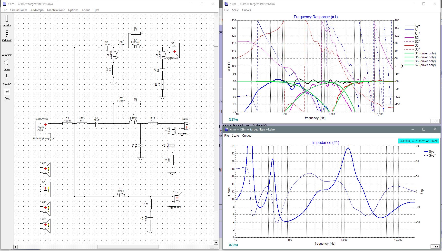

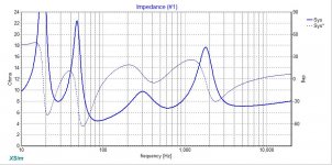

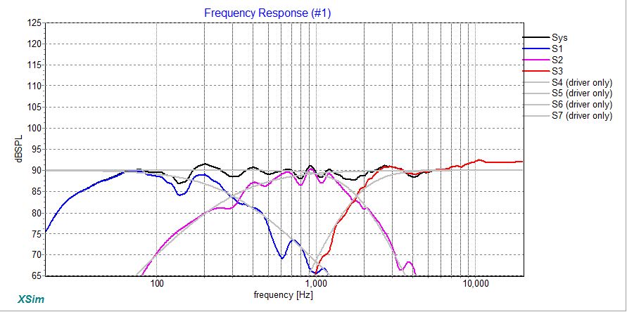

Another excellent explanation from Douglas in post 23. If you look for it in my sim below, you can see what a tanking filter added to the mid inductor does as well. I may change to the parallel notch filter. 😀

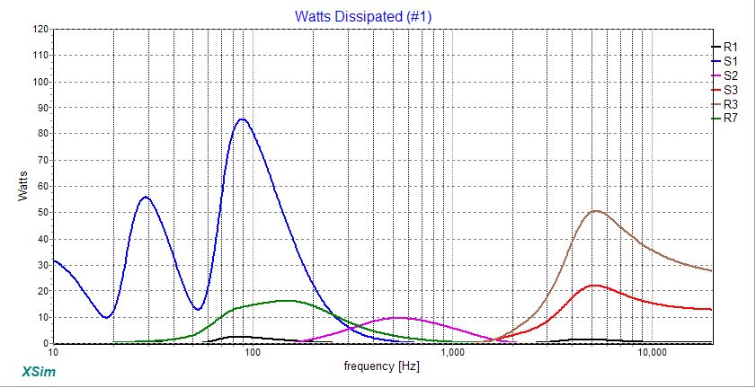

I'm a little too tired right now for a full explanation. Everything looks pretty good but there are still a couple of inefficiencies that maybe are livable or that may need improving.
That tweeter was a difficult beast to tame. I tried a shunt capacitor to flatten its rising response but I didn't like what it did with the current. I went instead with a parallel LR filter but looking at the watts chart, R3 is seeing buckets full! I also don't like that there are no resistors on the tweeter meaning that making fine adjustments in level is going to be difficult. I used a series notch filter to tame that waveguide induced rise in the response. I tried a parallel one 1st for the reasons Douglas shows above but I couldn't seem to get it to do what I wanted it to.
I also found an impedance compensation filter on the mid to be essential. Large values there but you can go with an inexpensive cap in that position. An high value iron core inductor is still a bit costly though. But it allowed the mid series capacitor C1 to be massively reduced. That will save you some bucks as that one should be of decent quality. Strangely, the main mid inductor needed to be a fairly large value too.
The woofer was simple. It falls into place very easily with about the same values Paul C used in the Tarkus.
For reference, you might notice that the highest current draws correspond to the lowest points in the impedance response. I used 60W btw to look at the extra charts. Lots of SPL there. But you'll need at least a 150W amp giving you a max of 6amps of current to work with if you want to play it up at those levels.
Play with it as you wish. As I say, there are still some improvements that can be made I think.
Cheers

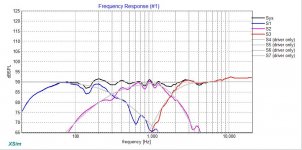

Here's another pic of the FR Graph. The 1 above fails to show what's happening lower down in SPL.
Nice work on the efficiency of your xo Rich. Better than mine I think. But man, I'm not sure I've ever gotten such a ruler flat response before above about 1000Hz. Dang.

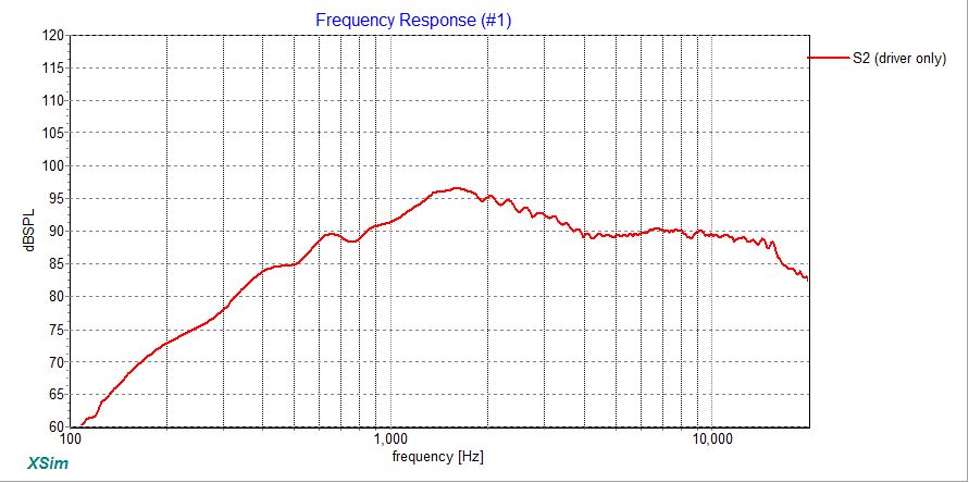

Do you have an original set of FRD and ZMA files or are they taken from measurement?
Comparing the graphs to the specs, they really don't match up very well with the published specs. Of course I'm aware the box affects them but not as much as I'm seeing.
Do you have the mid driver in an isolated chamber or is it sharing air with the woofer?
In particular, that 150hz dip in the woofer is puzzling...

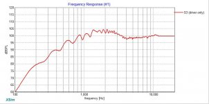

I think you should look in to it, normally you get a big 'bump' in the midrange from a DT300 (and other waveguides) that is usually compensated in the XO, but your raw response looked nothing like it?
The raw response should look at least similar to these examples:
Test Peerless XT25TG-30 / 04 at Waveguide WG-300
Vifa C17WH-

To answer your questions from your post. The files you have are from actual measurements taken with umik1 on axis at 1.5 meters. The mid range is isolated in its own chamber isolated from woofer affects. As for the woofers odd dip, I believe it is my near field measurement method needs to be changed. Maybe use the mic inside the box method. This speaker has dual ports below the woofer in close proximity. I will post some photos today so you can see what I have built.😀

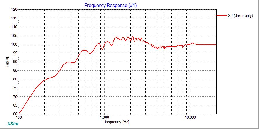

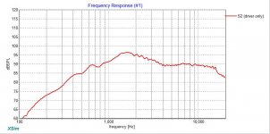

@Rallyfinnen,
I have posted a screenshot of the raw tweeter response from the Xsim file. To me it looks like it there is the rising mid range response that you mentioned. There may be differences do to the fact I measured at a point between tweeter and mid range. I'm not opposed to looking into it more, but I have lost my ability to re-measure until around November. I live and work at a golf course that has a huge dining room with faulted ceilings that makes it nice to measure speakers indoors. But, since we are now open for business I have lost my area to do such things.😡 My plan is to put a crossover together within the next couple of weeks and then double check everything later in the year.

@Rallyfinnen,
This screenshot is with same tweeter/ waveguide in another built. Do keep in mind, the design axis for this was the woofer and it was located above the tweeter in a standmount 2 way.

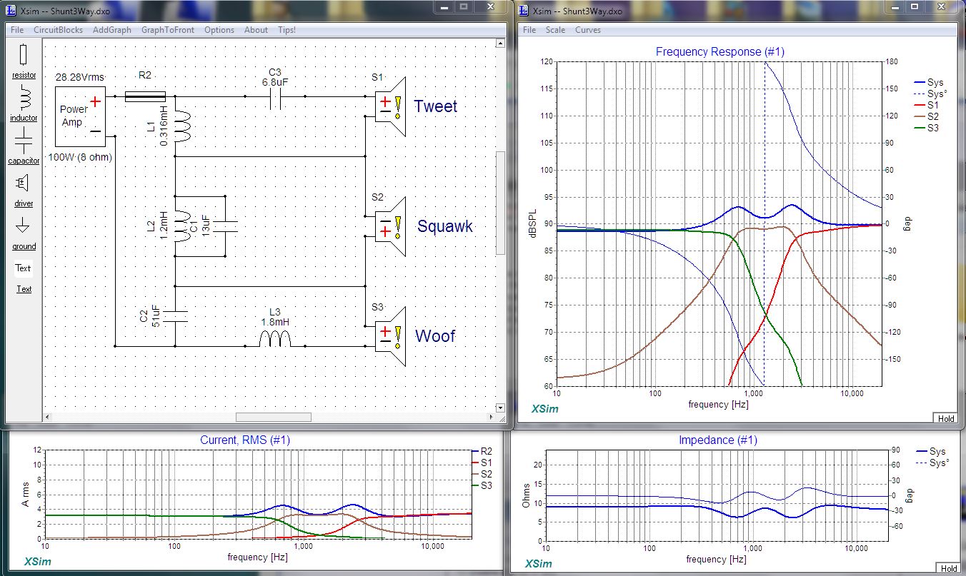

If this is the case, I would strongly suggest that we don't spend a lot of time fine tuning this or adjusting that... just put together a bog standard 3 way crossover based on dummy loads, until you can get better measurements or can find accurate FRD and ZMA files for these drivers.
In my opinion spending the $200 or so on decent parts risks becoming a waste of money, based on your current data.
When I would go out on a "room tune" call, I carried a couple of the crossovers below in my bag. I would hook them up with clip leads just to get some sense of what the speakers sounded like without massively complex circuits ... you'd be surprised how often I ended up installing them permanently.
