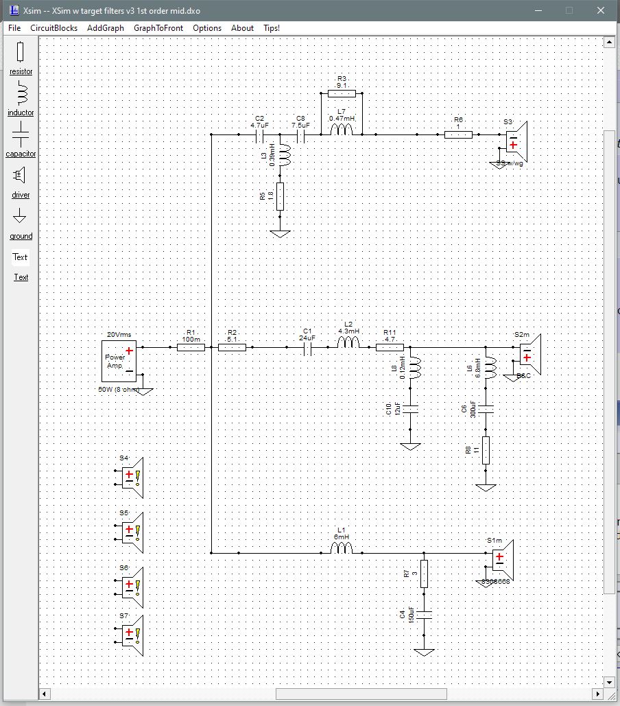

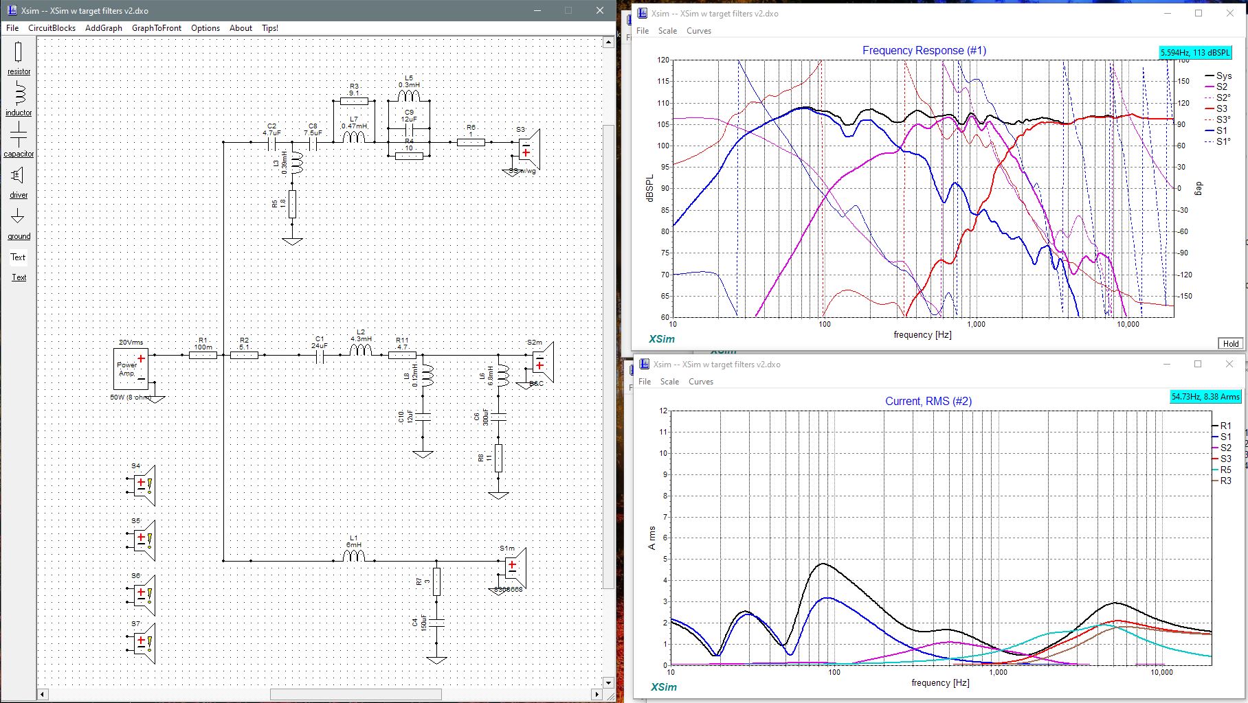

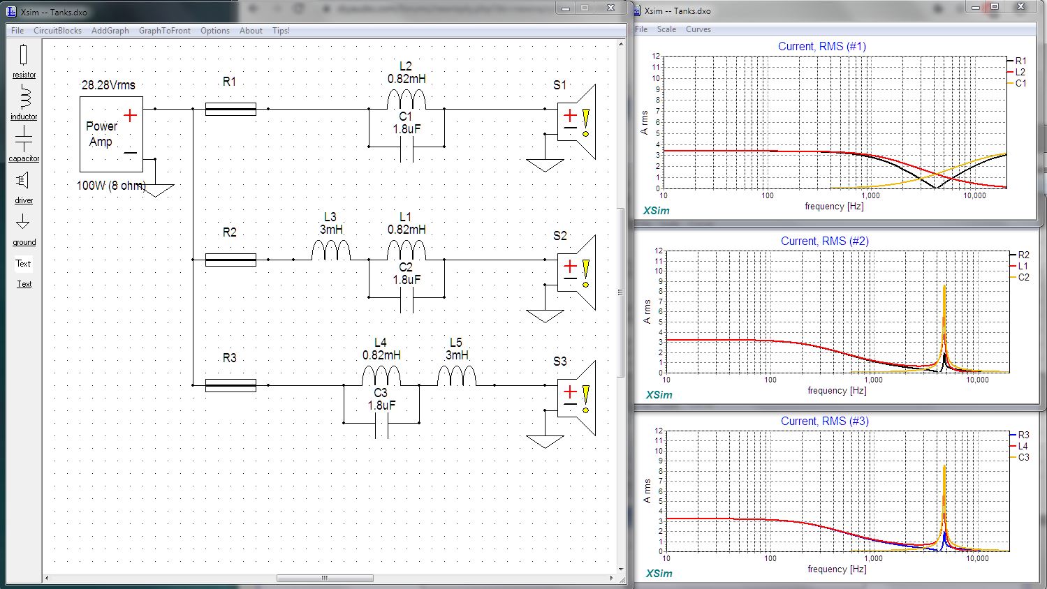

Here is something that's surprised me.
I thought I'd complete the notch filter comparison that Douglas did in post #23 by adding the tanking capacitor/inductor combination. To do this I had to add in a series inductor and considered it fair to add it in to all the other filters as well. Kind of closer to what is actually happening in the xo we are working on. Interestingly, it changed the results considerably.
The differences in current consumption are completely different. The notch filter that now produces the highest current consumption is the 3rd example, the parallel notch which previously looked to be the best choice. The series notch in blue is having no effect on the current at the notch frequency but drawing more down around 200Hz. The tanking notch is increasing the current draw above the notch frequency but not to as high a value as the red, parallel notch filter.
The differences in the FR to each filter are interesting to note as well. The red and green notches (parallel and tanking) tend to raise the response above the notch frequency. The series notch does this to a lesser extent and also increases the roll-off. That might actually be of some use. Achieving this double function while not raising the current draw at the notch frequency made me want to look at it more closely and see what it does in the actual full xo.
To that end, in the next pic I got rid of the tanking filter and added the series notch filter and with the added roll-off that it provides was able to also get rid of the 2nd order shunt capacitor. So now I've just got a 1st order HP and LP on the mid. Current draw actually looks to be improved over my 1st version. The FR isn't quite as smooth this time but should be acceptable and with a few other small changes in values here and there (for eg I switched from a series notch on the tweeter to a parallel one) the phase alignment is a bit improved.
Interesting.

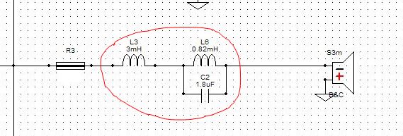

Interesting.
It's one of those "why doesn't this work" things that many engineers run into all the time ... when you incorporate two filters back to back, they are going to interact in some very surprising ways.
For example in your 3rd test, as soon as you added L3 it became part of the overall filter, changing it's resonant frequency and current behaviours.
Bear in mind that when a "tank" circuit resonates, the currents in the individual components can be, and often are, greater than the input current to the overall circuit. This is not magic, it is the resonant circuit storing energy and reacting in an exaggerated manner... which is, in fact, what we are counting on. (That was the ringing problem we talked about earlier.)
In a bandpass circuit we count on the circulating currents to significantly reduce the impedance, causing it to conduct more heavily. Perhaps even appearing to be shorted.
In a bandstop circuit we count on the circulating currents to increase the the filter's impedance, making it appear more like an open circuit.
However; when you added the new coil which is much larger than the coil in the inline band stop filter you inadvertantly changed that circuit to a an inline band pass filter compirsed of L3 and c2... L6 will continue to have a minor effect on the circuit, increasing the sharpness of the resonance. Hence both a decrease and increase in input current at resonance as shown in the graphs below. The actual component currents are confined to the tank circuit itself which is why you don't see them on the inputs.
Also note that moving the new coil behind the tank circuit does not save you.
Interesting yes ... but completely explainable.

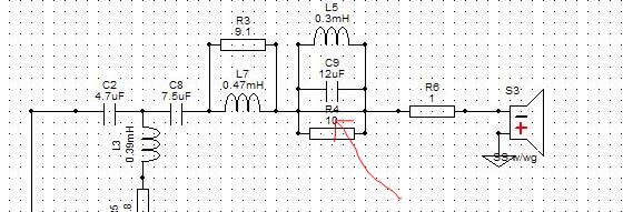

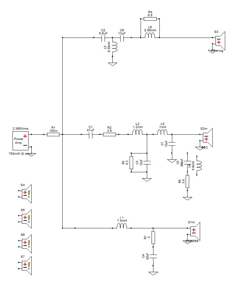

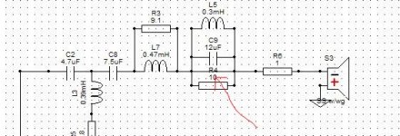

Douglas, you have a very good eye.
I threw that short in there to make a comparison and then forgot about it. The summed FR doesn't include that notch so I guess it doesn't actually need it. Huh. That's a nice surprise.
Just for clarity's sake, attached is the same xo schematic again but corrected this time. Everything else is the same as last time.

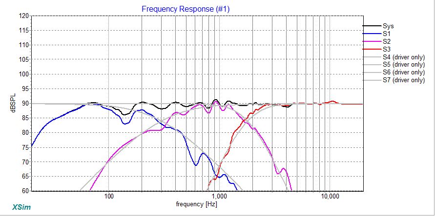

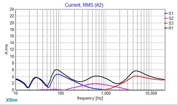

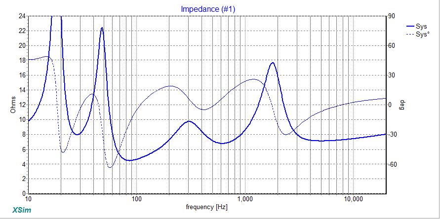

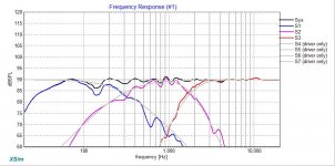

I could not help myself. So, I took another stab at a crossover design using ideas from jReave's schematic and some of my own. Please keep in mind that part of my goal is to utilize components that I already have on hand. As, @Douglas Blake point out it would be unwise to spend big on parts at this stage in the design process. Also, I'm viewing this as a learning experience.
Btw, the pic of current is with amp kicked up to 60 watts. I don't play anything at insane levels so I thought this would be a good level to use.
Perhaps I should clarify why I do that... it's the same as switching a meter or scope to a different scale. Testing equipment is always most accurate near full scale... so when something is small, you jack it up to get more "scale" out of it.
Turning up the amplifier power is not about the actual amplifier you are using ... if you notice all XSim does with that is to move things up scale, it does not produce different curves and it won't tell you "well you killed that driver"... So my only reason for jacking up the amplifier is to get more "scale" on the current and power graphs.
IF the current panel had scales that were useful at the standard 1 watt design level, I would use them instead.
To the creators of that software I would suggest that 500ma, 250ma and 125ma scales would be extremely useful.
Anyhow... this latest design looks pretty decent. Congrats.
There is one final exercise I do before going "Eureka" and waking all my neighbours (because it's 4:00am and I just had to finish) is to experimentally remove as many parts as I can without significantly degrading the performance...
Our ears and our rooms are very broad strokes devices, a couple of 1% differences, no matter how carefully achieved won't likely be noticed in the final rendering and common wisdom does suggest that as complexity approaches infinity failure approaches certainty.

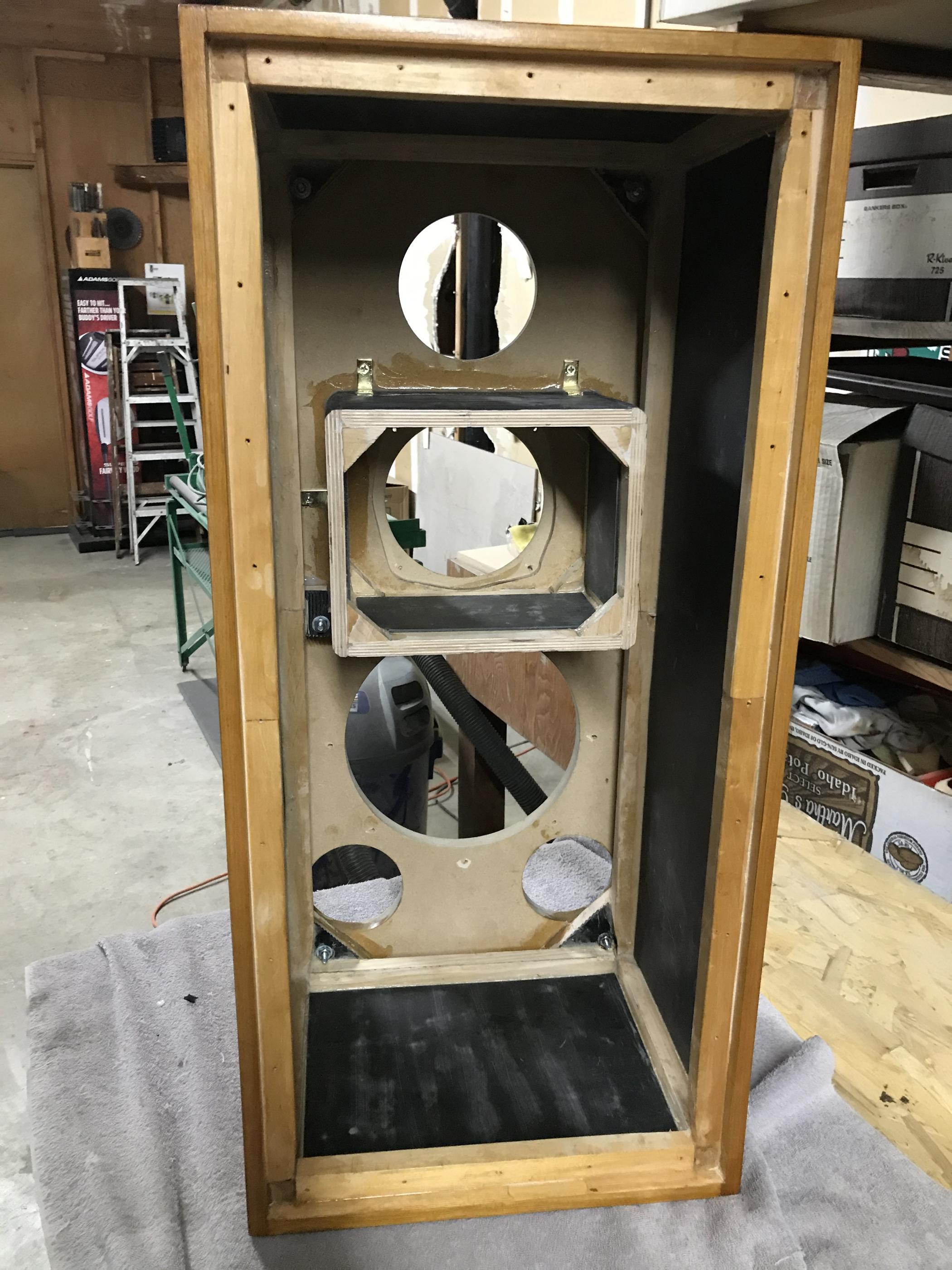

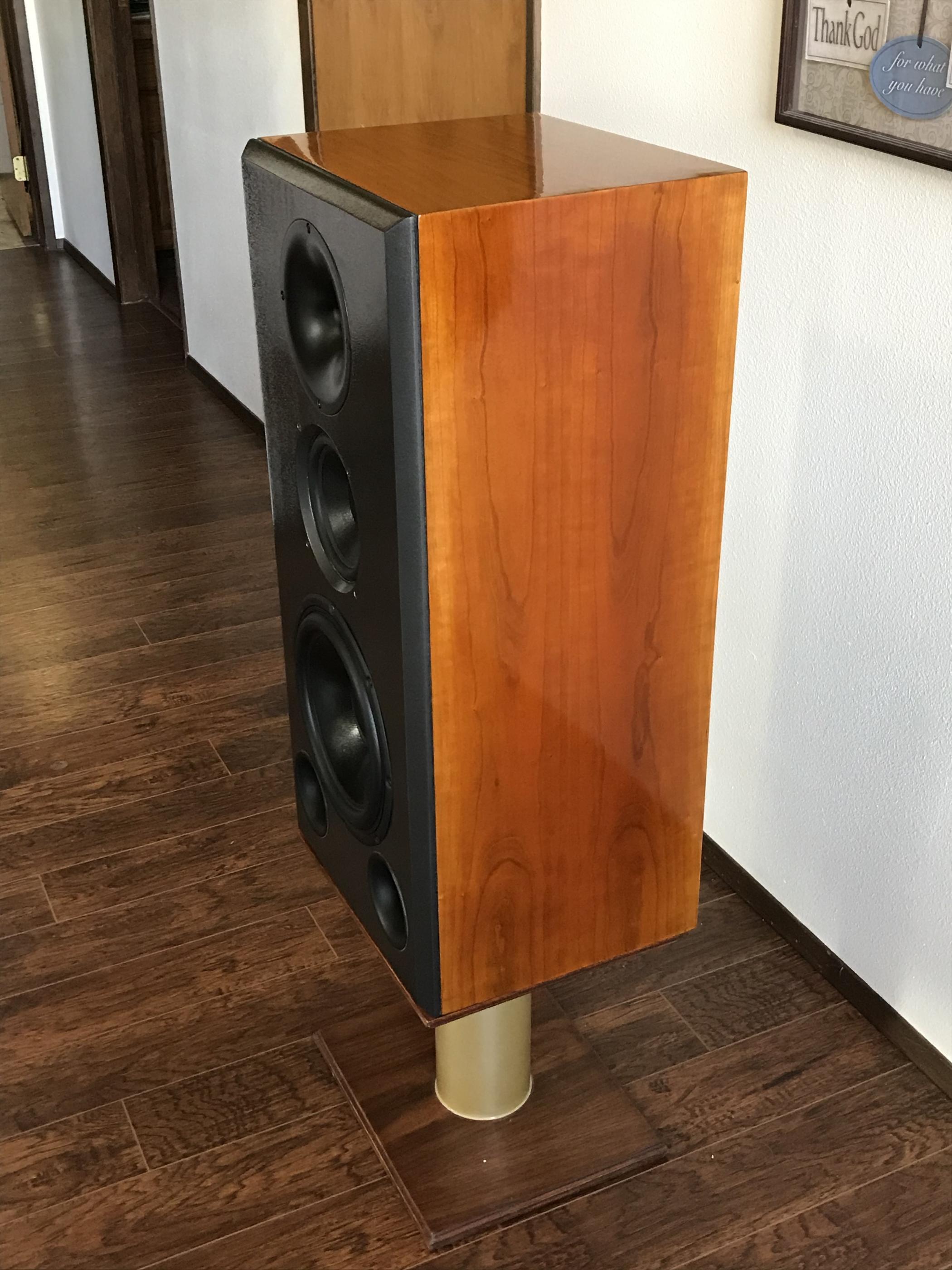

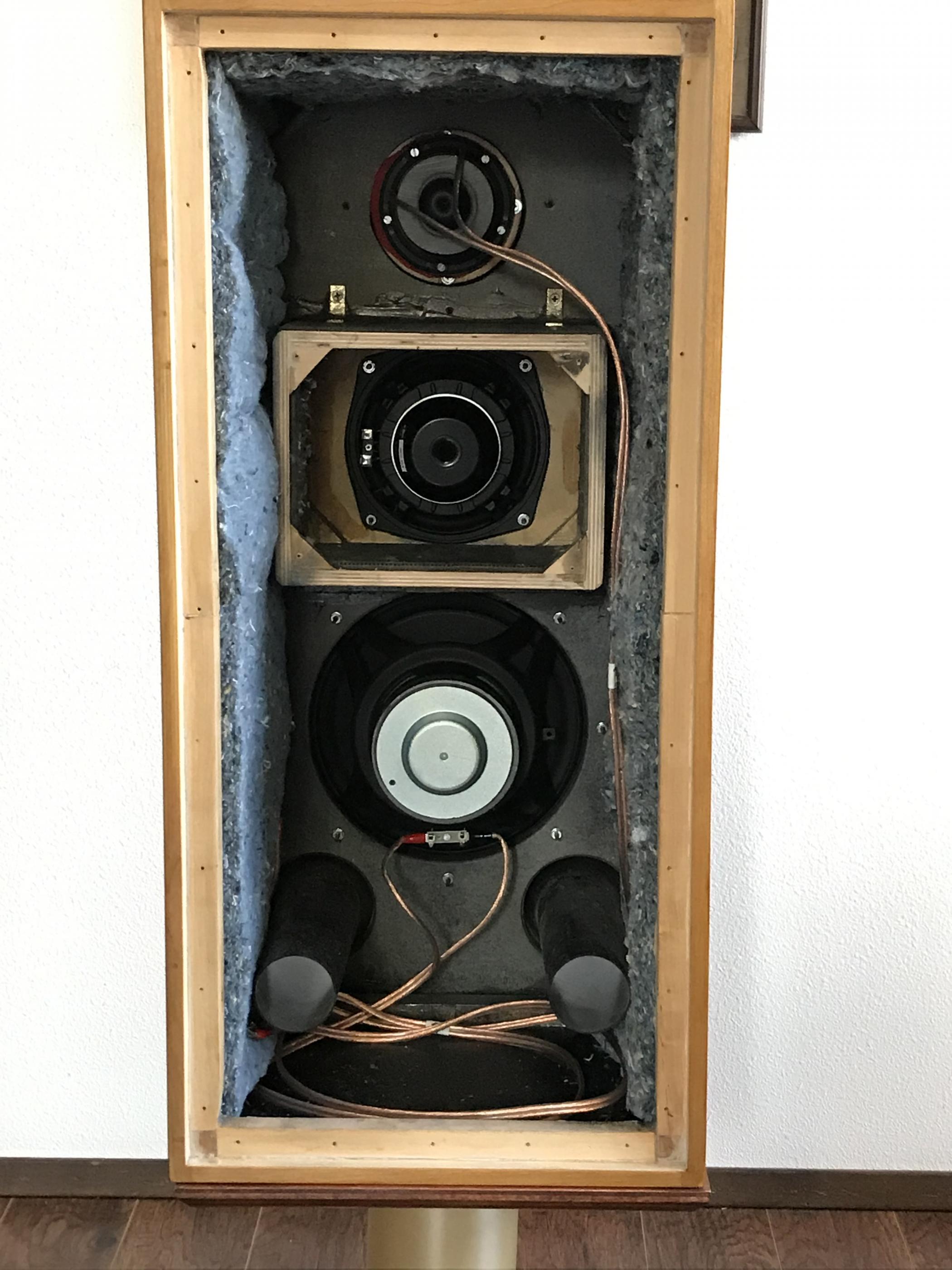

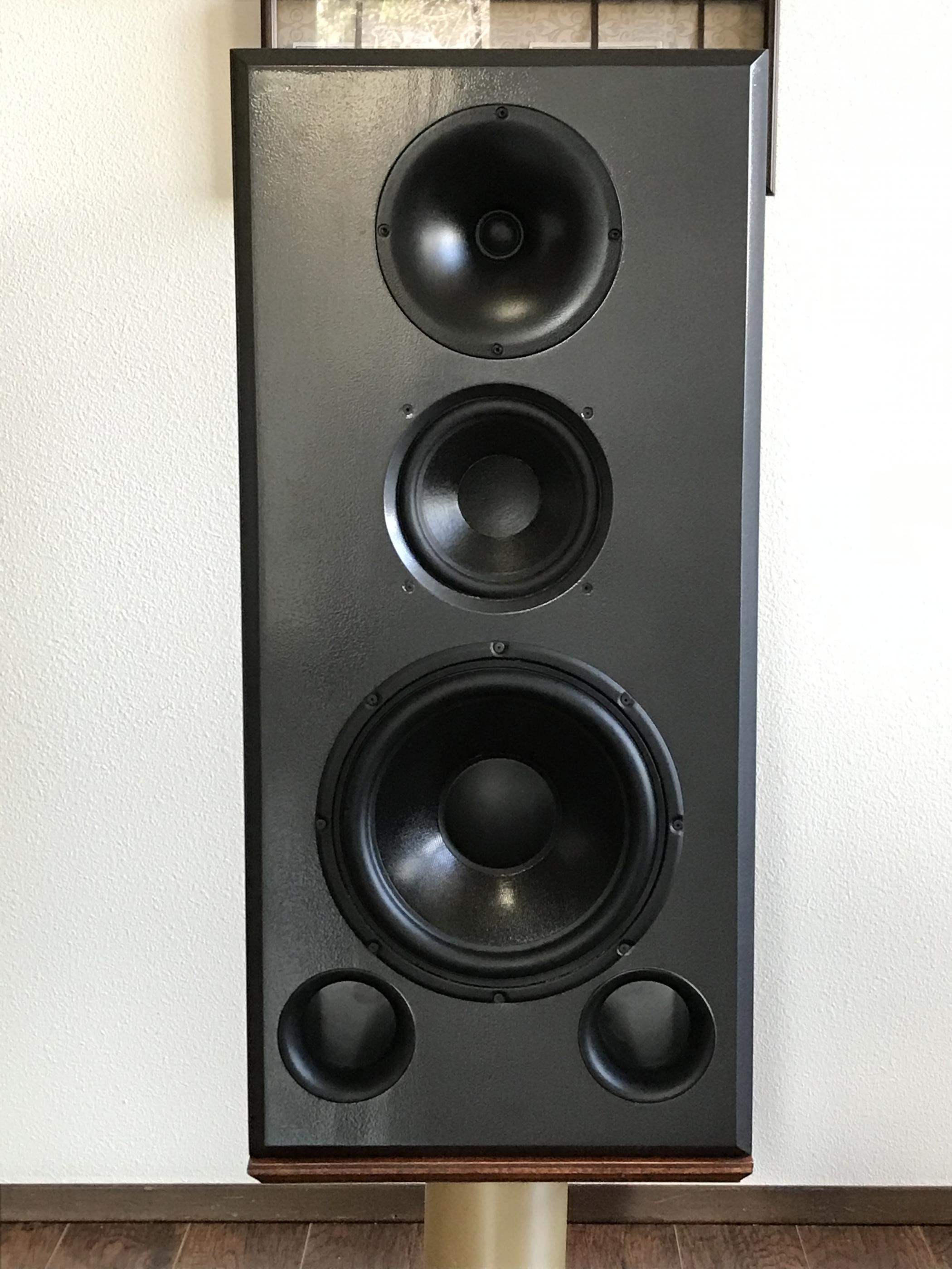

Hi Guys,
I wanted to post some photos of the actual speaker we have been designing the crossover for. I would like to mention that this cabinet design is patterned after the BBC approach of a thin well damped panels. So, I used 1/2" Baltic birch plywood veneered in Cherry than applied garnet shellac in french polish method (or a variation of it).😀 All inside panels were then lined with 1/8" thick mass loaded vinyl. I have built the heavy well braced speakers that require a hand truck to move around and I wanted to go a different route with this build.😀
This is only my 4th speaker build so don't judge it to harshly. I do think my speaker building has improved some. But, it's probably time to invest in a table saw.🙂
