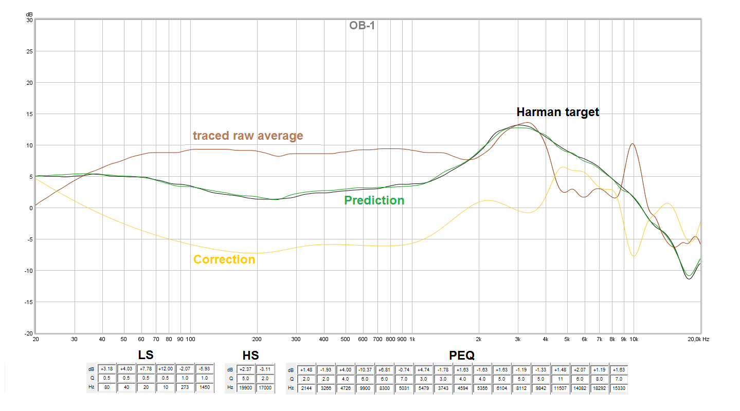

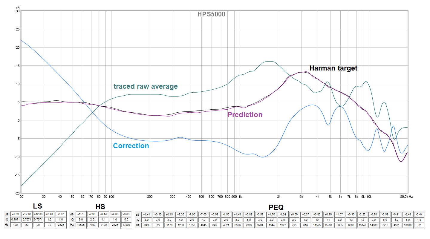

Traced also average response of dirty cheap Behringer HPS-5000 and created correction to hit Harman curve and must say in corrected stage OB-1 verse HPS-5000 now start sound very much exactly the same, for long listening sessions HPS-5000 wins because they don't clamp so hard against head and also weight much less but in they cheap don't have any nice look or feel of nice build quality.
HPS-5000 correction below, black is Harman target response curve, green is traced average of HPS-5000 raw curves measured over innerfidelity website, blue is correction curve which takes 35x EQ filters or one convolution 32bit wav-file, and purple is green times blue showing fair close coherence to black target.
OB-1 correction below, black is Harman target response curve, brown is traced average of OB-1 raw curves measured over innerfidelity website, orange is correction curve which takes 25x EQ filters or one convolution 32bit wav-file, and green is brown times orange showing fair close coherence to black target.
Can share numbers for these HPS-5000 filters too so if any is interested give a note.

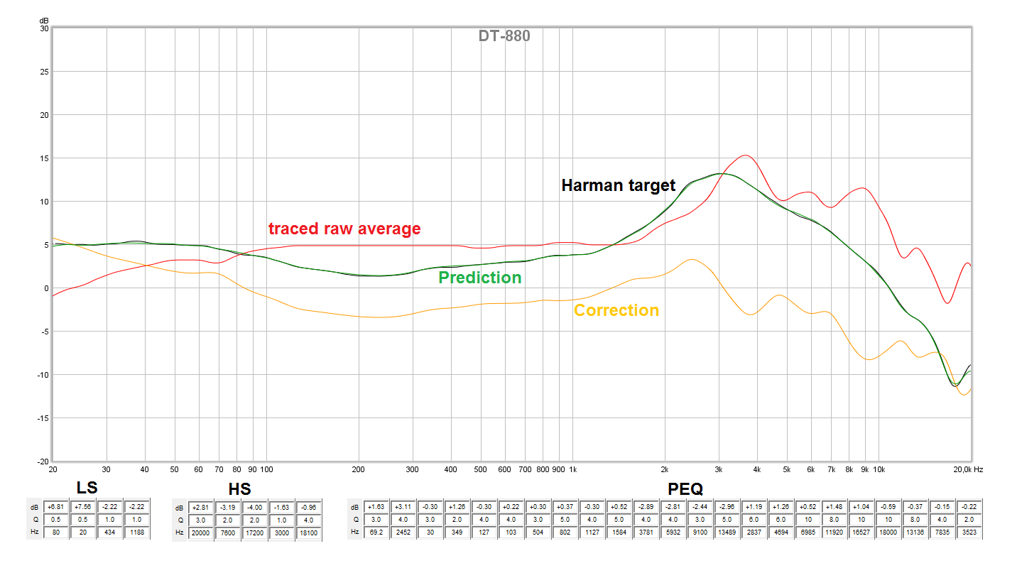

Sure babysupra, plan is tomorrow make DT-880 correction for xrk971 and thereafter will make guide in MS Publisher how response correction is created using free tools FPGraphTracer/REW/Rephase and try get guide converted and shared as pdf document.
I will take a guess here based on the graphing of REW. I think Byrtt digitizes the curves from Innerfidelity. Imports the curve for the headphone, then imports the Harman curve. They are loaded into REW where there is an EQ dialog. Then start tweaking PEQ's while watching the fit - manually adjust until the processed curve matches the target. Transfer those PEQ's into Jriver.
Byrtt beat me to it. Thanks for making the DT880 curve!
Making me a PCA is also a big thanks.
About guessing its close, difference is EQ correction is done in Rephase because it has nearly unlimited banks of PEQs and more flexiable settings than into REW, for example REW shelving filters have no way to adjust Q, also Rephase can output a convolution file into various formats depending what box is used or one can simply copy numbers from filters set into some player software.
Some can maybe do task in smarter way but its the software i learned to manage and they all free except i support some little donation from time to time because its great tools, more specific info tomorrow in a guide but until that here is headlines:
1. Capture grey curves from Innerfidelity pdf document with MS snipertool saved as png, then in MS paint draw a purple line in middle of those grey curves which should be the average response and save png file.
2. Trace that purple response curve in FPGraphTracer and save as frd file, also Harman curve is traced same way once for all and can be reused for every new set of head phones one like to correct in future.
3. In REW import those two curves and offsets head phones curve relative to Harman and zero dB point so as max of boost and cuts will be kind of symmetric in dB value hovering around zero dB line. Now at "ALL SPL" tab REW can do the math and create a difference curve between Harman curve and actual head phone curve picking math (A over B), and this new difference curve is exported as frd or txt file.
4. In Rephase above is imported and then inverted because smart thing is if this difference curve between Harman target curve or it could be another famous head phone curve say HD-650 with difference to own head phone curve is EQed visual flat in Rephase we have our filter correction numbers or can output a single convolution file. This is the step that takes most time puzzling with sweeping Q/dB/frq numbers up and down until visual curves resonances and deviation from flat start get good as possible looking, think this phase probably needs a bit of patience even one is good at it.

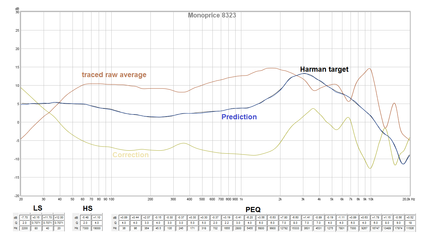

It's going to be nice to have my Monoprice 8323 and Koss KSC75 sounding like HD650 huehuehue
Which makes me wonder if the bass roll off in KSC75 is hardware limitation or due to tuning, because i like me some bass hahaha
Had a visual look at KSC75 and in it looks small and a clip on device so you probably right bass roll off is hardware limitation in having less cone area than bigger cans, experiment with boost down there to find out if head room is okay in long run, a round small diameter baffle is worst case for diffraction and comb filtering, at about 3,8kHz it looks comb has nasty null/dip/teeth and suggest don't correct that one because its probably non repairable null with common acoustic distances to same point and also clear viewable looking at impedance curve.
Monoprice 8323 peaks and dips looks bit broader and less in range so they probably not a real null and therefor should be repairable.

Monoprice-8323 / DT-880 / OB-1 / HPS5000 corrections to Harman curve, numbers for manual settings for various filters are in visuals below or alternative is use convolution engine in JRiver or Foobar and point to below attached zipped wav file. Sorry if using those wav files they are not optimized for IIR filters so a relative huge delay (memory buffering) will happen because in lack of time to study how optimize for this normal real time IIR filter scenario, wav file is in principle only for 44,1kHz tracks but some players try to convert and work for other sample rates too but don't expect optimal quality, and by the way signal is inverted using wav file so as PCA is corrected 180º.

xrk971,
Imagine DT-880 is great cans and probably personal preference but to see if EQ works good it would be nice first try test corrected OB-1 setup to see if it improve in your taste and if it does mayby start beat non corrected DT-880, thereafter test if DT-880 improve and if sound start be the same when both is corrected.
