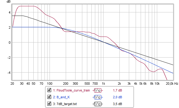

Thanks feedback, maybe explanation for what happening in "OB-1_test" correction is in place then, overall its same as original the one with 25x IIR filters plus two more normal IIR (minimum phase) and a third FIR filter manipulating phase.
1st filter is IIR low shelve 100Hz / Q0,7071 / -3,5dB, idea behind is because Harman curve is supposed to replicate good speaker in good room and that curve they scientifically researched also and is to see as red curve below. It is very hot in lows and my thinking for dial down the worst of it is because my favorite curve for linear phase speaker is the black one below and head phones should be linear phase in pass band because there is no XO point happening, where i can think of why they prefer so hot a curve is because real time speakers have XO slopes in lower region so a more hot curve would probably help mask a bit and speed up phase to have little less the group delay that develop using XO points. Blue curve below is the B&K research from past.
2nd filter is sensed by listening over and over and become a broad IIR high shelve 5kHz / Q0,4 / -0,5dB to help tip bright tonality a bit. Can't document any objective curves for this correction but in its broad with Q0,4 it should be non resonance neutral.
3rd filter is FIR that slow phase a bit from mids up towards VHF, its also broad and technical its 2nd order / Q0,5 / 30kHz. Idea and thinking behind it is all devices in recording and replay chains are bandwidth limited at highs and when summed they all push to final phase curve from mids and up will tilt heavy in speedier direction than lows, so its based guessing/prediction that to get closer to phase of original instrument that sat in front of microphone at recording studio some broad correction for all these phase distorting devices is maybe help into better realism, and of course listening over and over again was reason for it was added after trials of different values in filters settings.

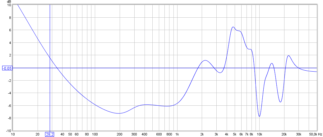

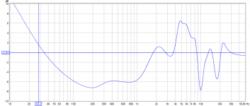

Think why that is expressed as recommend and ticked on as default is if filter with dangerous boost levels is turned on by accident or non experienced user on his thousand dollars system with volume set to twelve o'clock or more his cones can end flying thru the room and amps break fuses.
If you look below finale correction curve for OB-1 convolution file on a +/-10dB scale its balanced hovering around zero dB line so as even down at lows where boost is higher (+4,57dB @20Hz) it shouldn't be problem in tracks have no energy down there other than bit of DC thumbs that probably create and add bit of realism.
