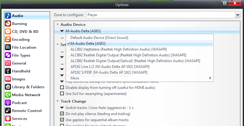

2. To setup soundcard go into "Tools/Options/Audio" and set it up for WASAPI or ASIO to get bit perfect playback, first picture below is example for mine setup to use ASIO, think start use WASAPI which is Microsoft feature to bit perfect and works flawless where ASIO can be bit more tricky probably because its non Windows driver and complicated buffer setting control panel from soundcard manufacture can often be necessary to trim right before sound stream flow perfect, drawback using WASAPI or ASIO can be or not that it takes exclusive control of sound card so as long JRiver is playing no sound from other programs will pass.

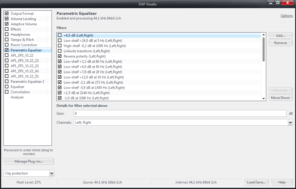

3. DSP engine is called "DSP Studio" and a fast way to call it without going through "Tools/Options" menus is place mouse over the three arrows at right side up at top and push button "DSP Studio". Second picture below show mine and understand containers over at left works so that sound stream comes in at top and goes down thru actual containers you tick on, and if for example their routing order is wrong simply drag containers with mouse up or downwards to get right routing, if done on the fly when music is playing expect some digital noise. Suggest have same containers as mine ticked on, Highlight "Output Format" and at right set it up so no sample rate converting is happening for sound cards supported modes, "Volume Leveling" have no settings but "Adaptive Volume" will also need highlighted and setup over at right suggest set it to "Peak Level Normalize", these two will ensure same volume leveling for all tracks but be aware it works not 100% before in bag ground JRiver has analyzed dynamic range and leveling for all media library. In "Parametric Equalizer" or "Parametric Equalizer 2" set those 25 filters from post 916 plus a "Reverse polarity" to correct inverting source follower SE topology.

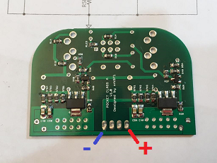

Is it alright connect regulated PSU as below if at same 2x loose flying plugs for 9V elements is temporary isolated, ask because being lazy then can hack it without dismantle anything in PCA.

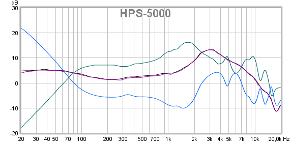

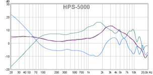

Traced also average response of dirty cheap Behringer HPS-5000 and created correction to hit Harman curve and must say in corrected stage OB-1 verse HPS-5000 now start sound very much exactly the same, for long listening sessions HPS-5000 wins because they don't clamp so hard against head and also weight much less but in they cheap don't have any nice look or feel of nice build quality.
HPS-5000 correction below, black is Harman target response curve, green is traced average of HPS-5000 raw curves measured over innerfidelity website, blue is correction curve which takes 35x EQ filters or one convolution 32bit wav-file, and purple is green times blue showing fair close coherence to black target.

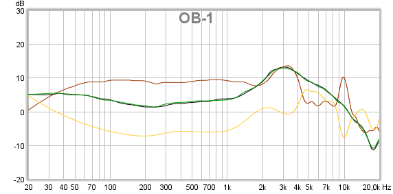

OB-1 correction below, black is Harman target response curve, brown is traced average of OB-1 raw curves measured over innerfidelity website, orange is correction curve which takes 25x EQ filters or one convolution 32bit wav-file, and green is brown times orange showing fair close coherence to black target.
Can share numbers for these HPS-5000 filters too so if any is interested give a note.
