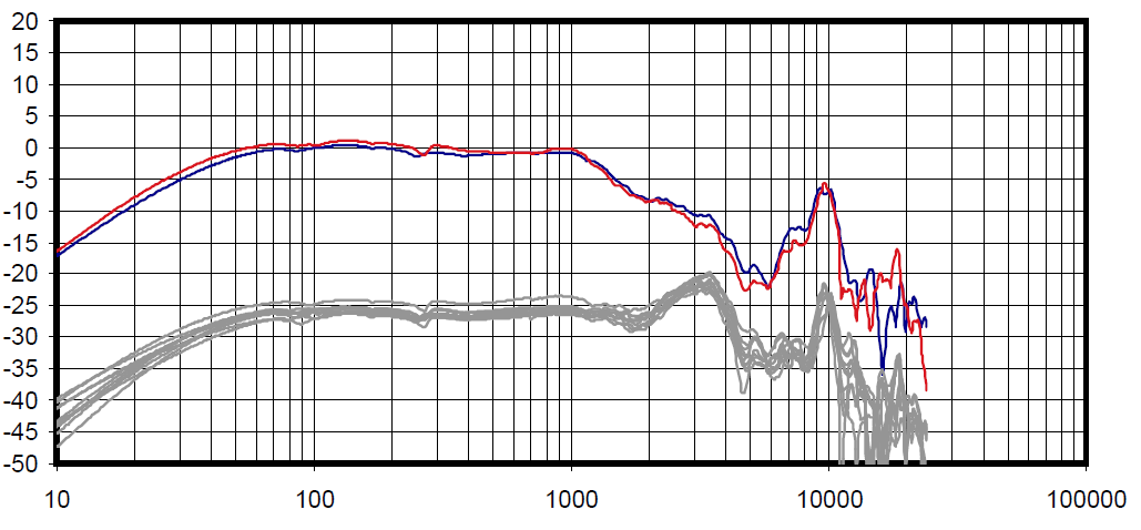

The Innerfidelity measurements with a head mannequin shows about +1dB shelf from 200Hz downwards - but not an excessive boost. To me, feels almost like the classic response we like where response is tilted to the right to fall maybe 2-3dB from 40Hz to 20kHz.
https://www.innerfidelity.com/images/StatusSMOB1.pdf
Great thanks didn't know that source sharing nice data.
Could imagine head phones have another ideal curve so as to be natural singing for human ear which it other curve than for speakers and that i have to study deeper about then, but a comment for curve is it looks to be very hot below 1kHz.
Based on average grey curves one could trace them to use for making DSP filters.
I think you are right - relative to the highs, the bass is very hot. Compared to the Sennheiser HD-600 which has been considered a studio quality neutral monitor for 28 years running.

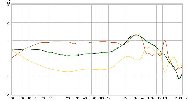

EQ filters for Status OB-1 head phones owners that will transfer average of OB-1 grey response curves at innerfidelity website to so called Harman target response curve also found over there.
Prepare setting these filters result in shocking fantastic sound performance and great thanks xrk971 pointing to that website and to the website for sharing those curves making this correction possible.
Black is Harman target response curve, brown is average of OB-1 raw curves measured over there, orange is correction curve when setting below filters, and green is brown times orange showing fair close coherence to black.

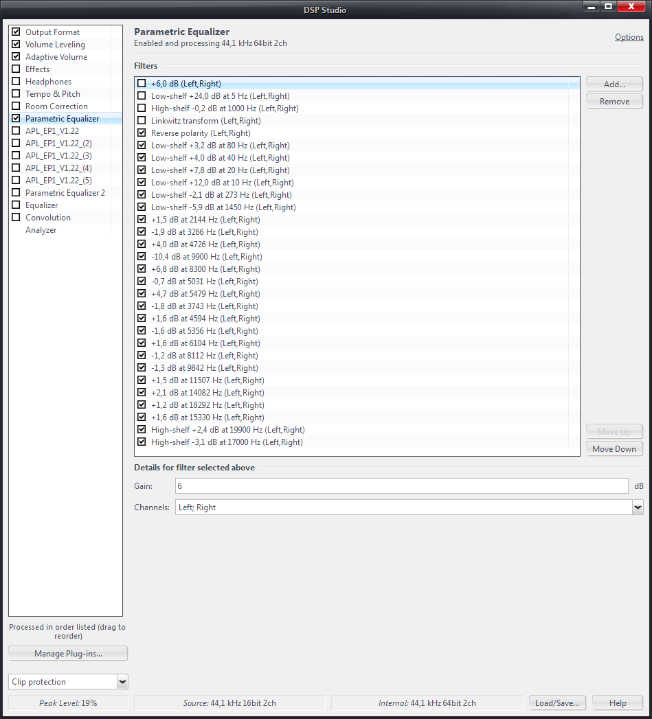

Yes it sounds fantastic and pretty shure you will agree, i'm on the second pair of nine volters since that EQ was setup into player in can't stop listening, and yes when batteries are fresh on voltage level its as good as sweet spot in front of Two Towers, try yourself live track "Hotel California" from album "Hell Freezes Over" and dream back sitting in Ronalds couch. Have idea and experience from HD 280 Pro than when changing multi core Litz cable to unpractical solid core it would be even better natural sounding killing the sometimes little hard edges on harmonics making lows more realistic which often is a little syntetic in head phones compared to good tweaked speakers, of course there is no guarantee cable mod will work but will try it later when have a plan how to dismantle and check so its possible to restore with original cable again if needed.
Technically because its pure IIR correction didn't create it as one filter inside wav file to be loaded into players convolution engine because then it gets more complicated to set up in needs of wav file at all possible sample rates and a config file that points to those wav files, for some its a piece of cake to setup but think every one can find out to copy number from those 25 filters above plus probably also good idea when at it also set a filter than reverse polarity output to correct inverting source follower SE topology. In Jriver its pratical have all these filters set in one container then its easy tick on that container and player is armed with correction listening OB-1 via PCA, later untick container and player is ready sending un EQed clean signal to speaker system or other device.
Hope post help to set it up in picture below you see JRiver DSP and over at right is all necessary filters ticked on so they form orange specific correction curve to OB-1 so as Harman target response curve is formed, at left see its one un tick point and all correction inside that PEQ container is disabled, by the way in visual i'm listening 13dB DR Fleetwood Mac track "Never going back" but sadly can hear second set batteries are running cold now so need to go out shopping more elements. It was great you pointed to that site because without those curves didn't know what important to correct for and how a target response for ear canal looks, try it out and if successful request DT880 correction too or a detailed step by step guide.
