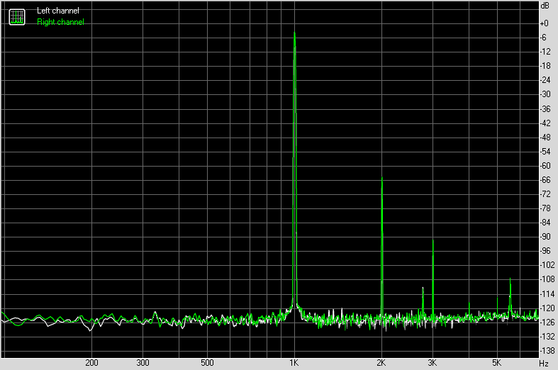

I connected Silicon Harmony to my Focsurite DAC (capable of 192kHz at 32bit), and played a high res 176k FLAC file of Spyro Gyra's Dreams of Toledo. Wow. The better the source, the better it sounds. Here is the FFT profile of this amp into 33ohms. Predominantly H2 distortion at -66dB and H3 at -90dB. Not much else. There is a bit of odd noise sneaking in from one of the DC step ups which may be going bad as I can hear a slight whining noise from it. Will change those out shortly for some new ones with a proper heatsink.

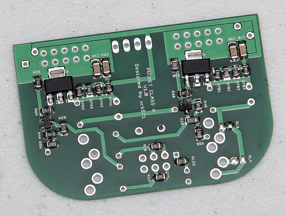

so I think in fiddling with capacitors I've killed something on my board.
on the "b" channel the mosfet reading and jfet readings are off. in this case would I be right in saying the jeft is stuffed which is causing the mosfet readings to be off, and try swapping the jfet first?

can't edit my previous post - forgot to put in voltage readings, which are:
measurements:
On the B mosfet: 15V (battery voltage) on pin 1 & 2, 12V on pin 3.
B jfet: G & S 0V, D 15V
readings on A channel seem to more or less follow the values on the LTS sim posted on p67.
However ,
R3b is 0V, R7b is 12V - not sure what to make of this? resistance readings are as normal though.
Again channel A readings are normal
ideas?
All I did between it working and not working was replace the output caps...lol

I think I have seen this before on BabySupra's first build. Check for a cold solder joint or loose connection on the resistors below the JFET (R4, R5). If they are open (bad joint), it makes gate of mosfet same as rail. Use soldering iron to retouch the SMT joints and use DVM to confirm that there is voltage across R5 showing current is flowing. Should be same as current across R3.

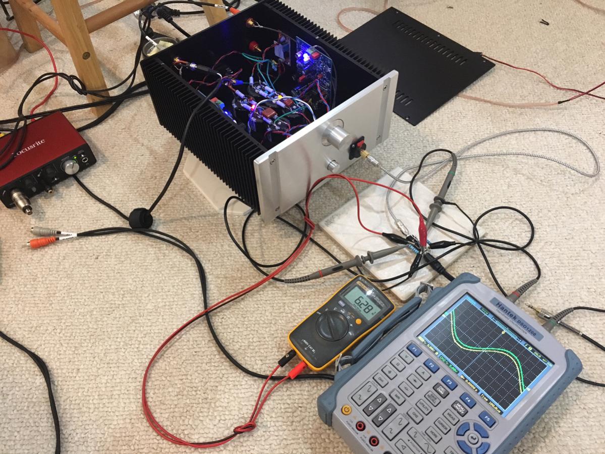

I just ran a test with 51R power resistors and amp Vcc set at 29.0v. With the O-scope showing the trace as un-clipped, the Fluke showed 6.28vac. That's about 773mW (circa 800mW) into 51 ohms. Since the amp was designed for 8ohms, it should put out exactly 5w unlcipped into 8ohms. So you may say 800mW is wimpy compared to a Class AB opamp like an LME49600, but that's pure Class A operation - the only kind of operation possible with a single ended Class A amp. Heatsink temp is still a safe 55 deg C. We are dissipating 32w from each channel to get 800mW into 51ohms or 2.5% efficiency! 😀
hey thanks. according to measurements it should be working now - will test it with headphones in a sec.
touched up solder joints - no dice. replaced jfet - same readings. then i found out i didn't solder one leg of the replacement jfet. silly me. too eager haha

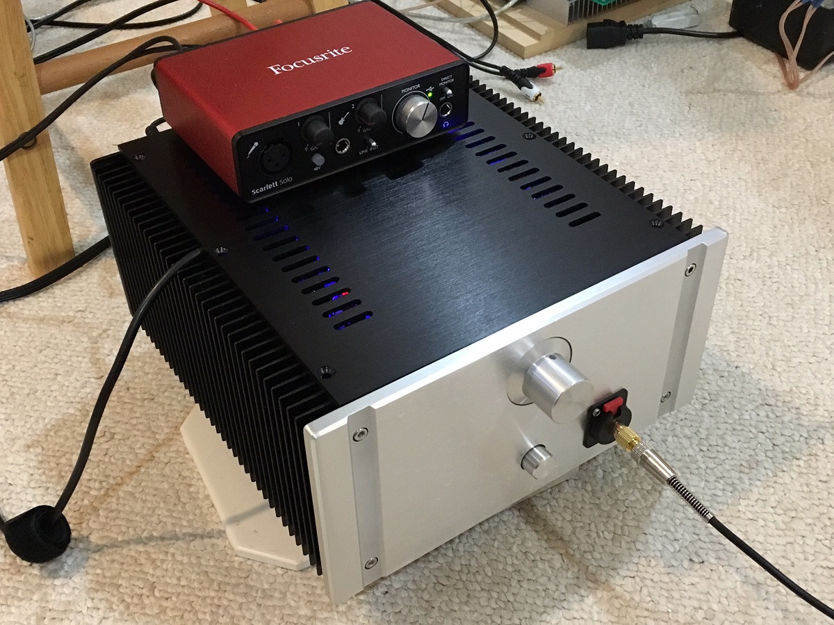

My first all aluminum Class A case - a surprise is that the whole case acts like a heatsink since aluminum conducts so well. The top, bottom, front and back panels all feel warm and the solid aluminum volume knob too. Amazing how much heat the equivalent of a 75w lightbulb puts out.
