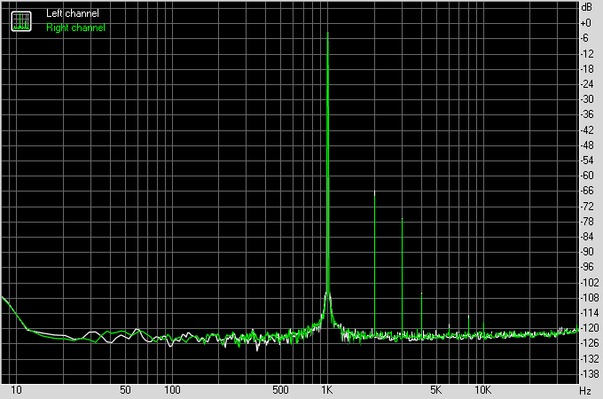

Another NHB going out to Singapore. This one is tuned to dig deep with LCD-2. Dual 1000uF 16v OSCONs + 10uF 35v Silmic II's on outputs, and 10uF 35v Silmic II's + 1uF 63v Wima MKS on inputs.
Measured FFT:
