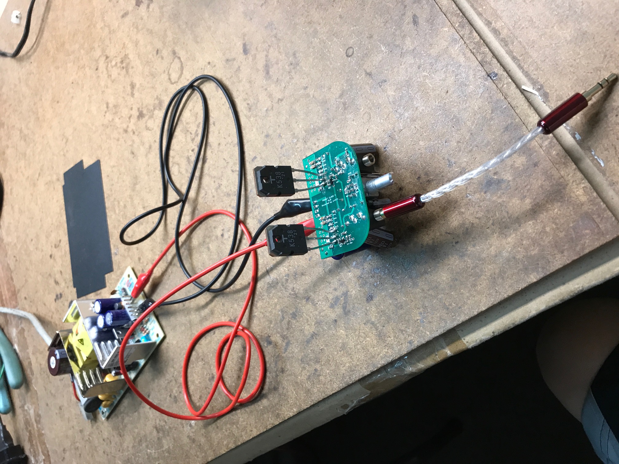

I just switched to a 18V 60W medical grade switching DC power supply and replaced mosfets with NTE2378
here are my new measurements:
channel B:
R7: 7.79
MOSFET GDS: 10.93, 18.02, 7.8
JFET GDS: 1.91, 10.94, 2.1
R3: 7.1
channel A:
R7: 7.53
MOSFET GDS: 10.64, 18.02, 7.56
JFET GDS: 1.99, 2.25, 10.63
R3: 7.39
PS btw, i just realized my R4 values are both 33R (i think i read somewhere you recommend starting with 47R for R4, but from one of the pre-made mouser shopping carts on post 1, 33R was listed as R4)

Nice work. That mosfet looks like us working and you are getting 65mA bias and your output voltage is basically balanced at the halfway point. How does it sound? If you make R4 larger, say 47R you might get 75mA or 80mA bias. You will need a heatsink on those MOSFETs then.
Watch out for running too much current through R7's. Above 65mA it's exceeding 500mW. You can try switching over to the desktop amp values and see if this mosfet works similarly to an IRF610.

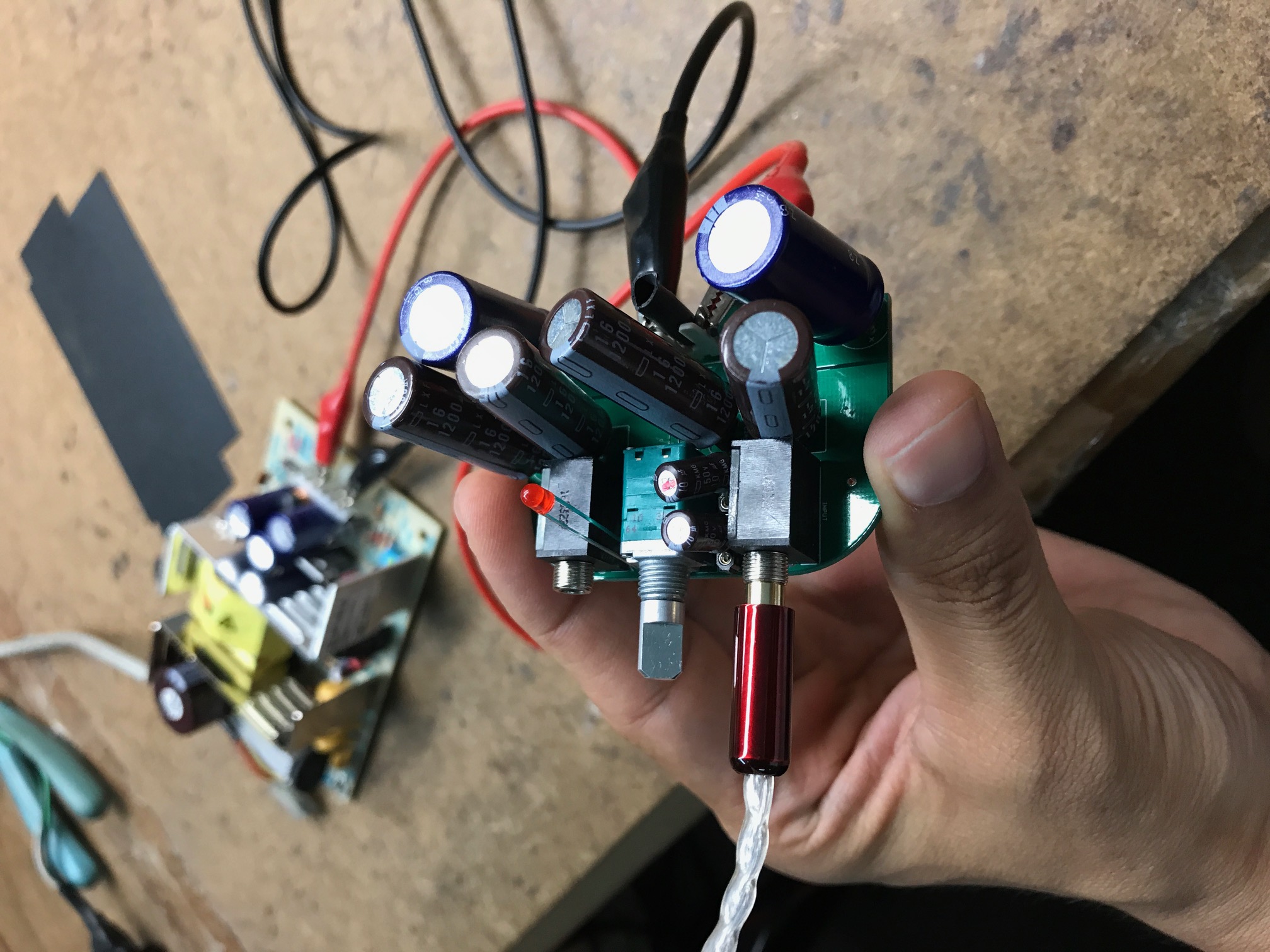

The modification took longer than I anticipated (the S solder pad of mosfet B broke when I was removing stock mosfet, any tip to easily de-solder stock mosfet?) so I was already running late to pick up my toddler from the daycare when I completed my work. I did a quick listen and here are my 60 sec listening impression
1. Channels appear balanced
2. Channels appear to be clean sounding, but I wasn't listening for noise
3. I used Walnut V2 DAP playing WAV files, using line out into PCA, I feel it sounds better than Walnut directly out of headphone out
4. FWIW Walnut V2 vs Fiio X3ii or Xduoo X3, maybe not beat them, but close enough to promote discussions on HeadFi
Keep in mind this is very quick listening impressions and I was in a hurry to get out the door
Question, for my next step, would cap rolling yield better sound improvement or going with the full desktop variant modification?

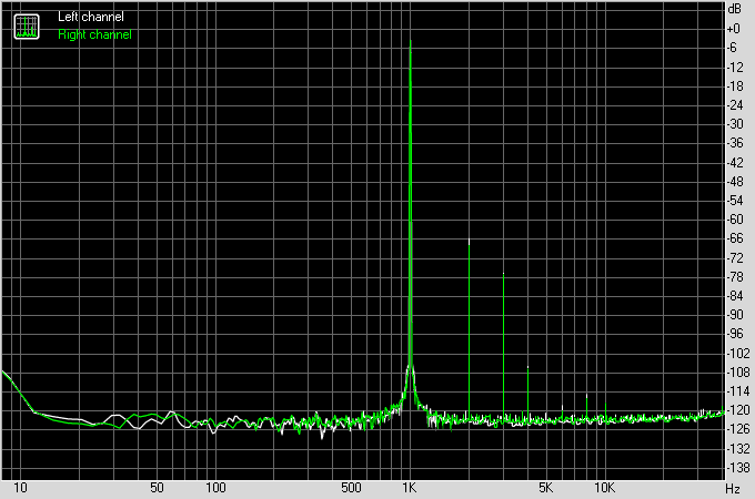

Another NHB going out to Singapore. This one is tuned to dig deep with LCD-2. Dual 1000uF 16v OSCONs + 10uF 35v Silmic II's on outputs, and 10uF 35v Silmic II's + 1uF 63v Wima MKS on inputs.
Measured FFT:
Measured FFT:

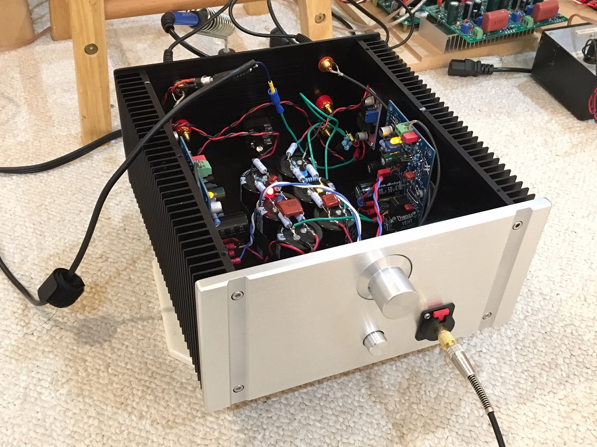

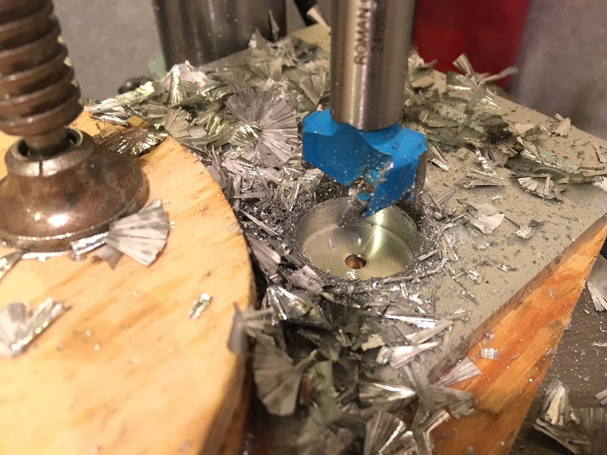

Silicon Harmony casework is a PITA. A 24mm Forstner bit goes through 8mm thick aluminum plate well (for headphone jack).
It's mostly together and listening and checking temperatures. Heatsink is reaching about 50 deg C at the middle where the MOSFETs are located. Sound is still great. Very quiet, no noise or hum. Super powerful sound.

Thanks, Prasi! You did a beautiful job on the layout for this board. Looks and sounds great. I didn't know what a PITA casework is until I had to hog-out a big hole in aluminum. Noisy, messy, time consuming. But it had to be done. Soldering is so much more fun 🙂
