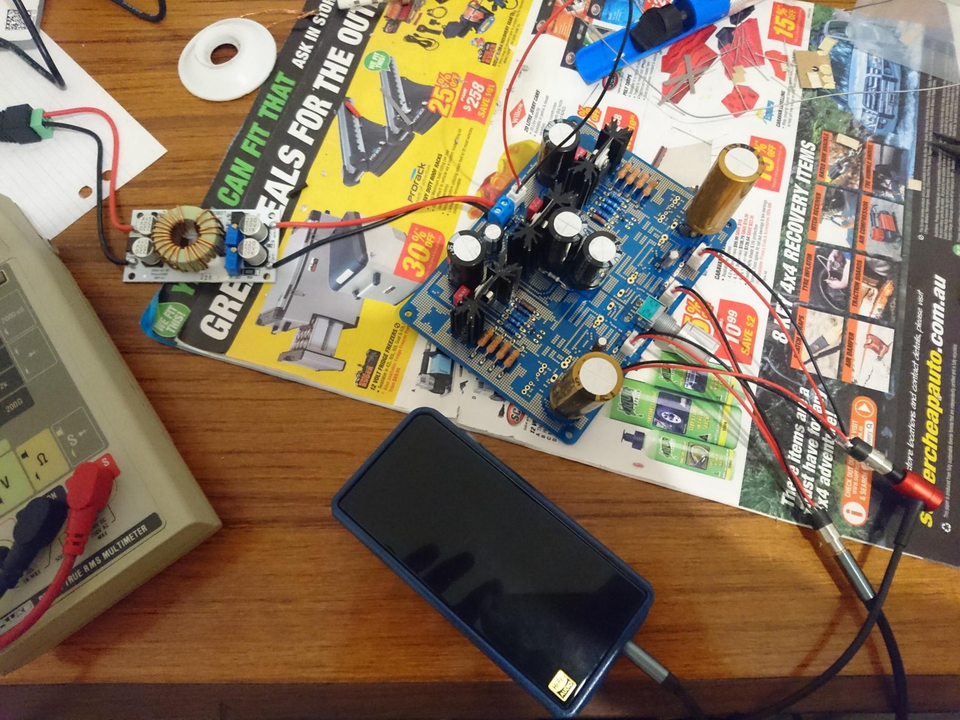

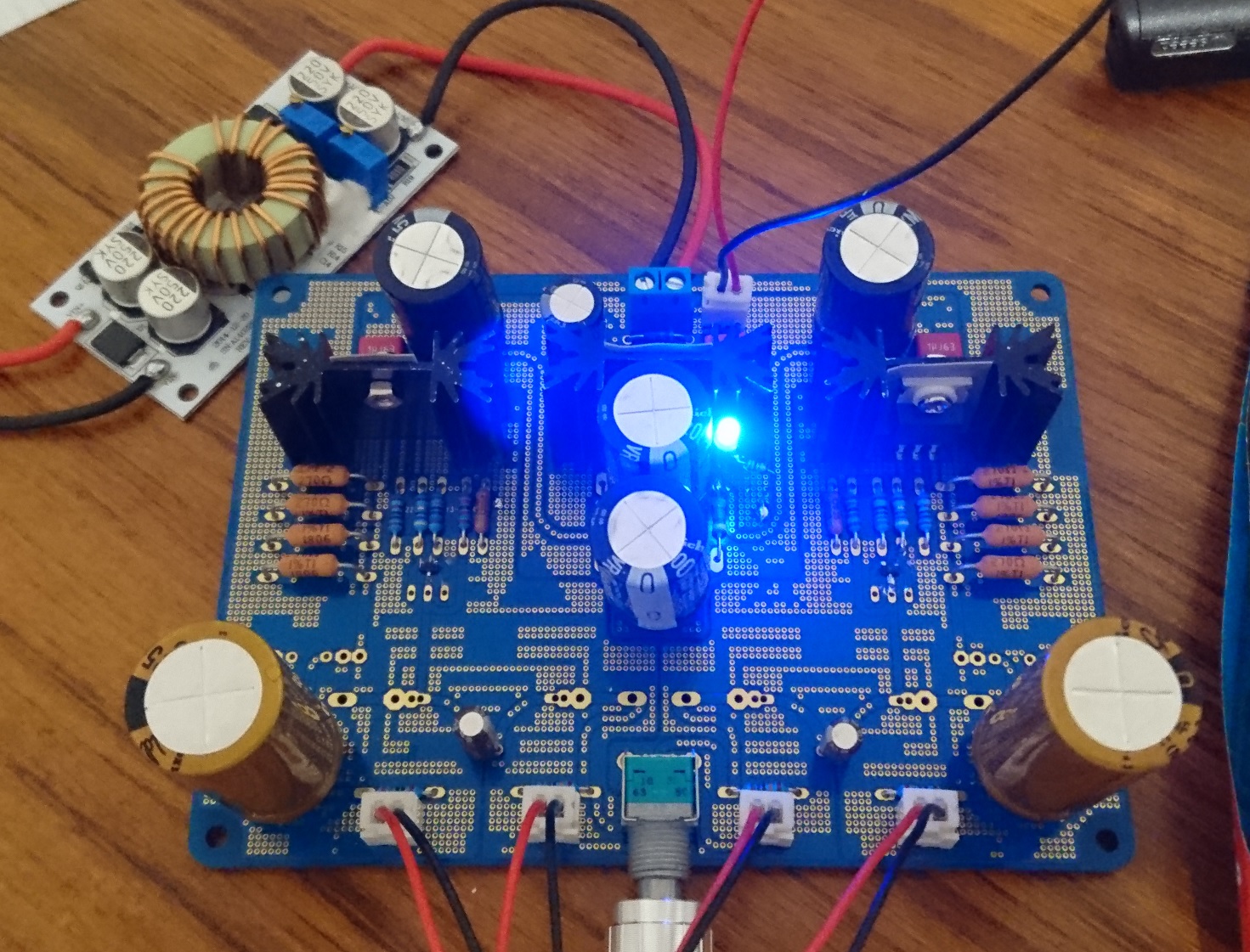

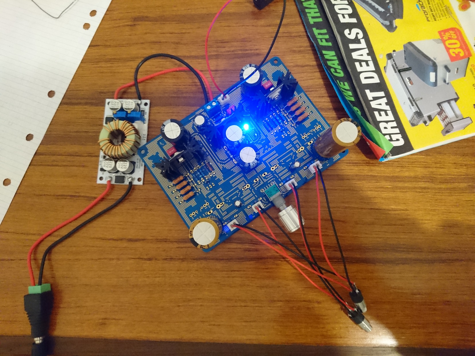

I got it singing! 10.1 &10.28v (20.22v Vcc after the multiplier and filter) across each resistor bank with the stock values!
Is it worth balancing out?
Haven't worked out how to attach pictures from my phone yet so that'll have to wait
Maybe because of the capacity for the board to absorb heat, it's very difficult to remove components/solder from clogged holes , the solder never quite gets hot enough. (iron at 400C)
Was thinking of swapping caps (and resistors) but I don't think it'll be possible...
Congrats! That’s pretty well balanced and perfect DC setpoints - don’t worry. Use a fat chisel tip to apply more heat for desolder.

Nice work! Congrats on being the very first besides me to build the DCA. It was easy wasn’t it? You deserve a pat on the back for perfect DC bias with DC midpoint after MOSFET source at 1/2Vcc. Doesn’t get better than that so you will have the best possible clip performance. Meaning 500+mW into 50ohm cans! Not bad for pure SE Class A headphone amp with 2 actives and no choke loading. (For comparison, the PCA with 65mA bias only managed 50mW).
One thing to double check is the polarity on your audio input and outputs. The board exhibts mirror symmetry at the midpoint (left-to-right). So 4 jacks left to right are
+ve -ve / -ve +ve / +ve -ve / -ve +ve
Why? Because JPS64 designs for symmetry for best noise performance and for ground loops to be minimized. It makes for custom wired connectors though. So I think you need to flip polarity of left input and right output. Then your phase will be correct and soundstage will be much better.
Use a small sharp tip of an Xacto or needle to push the barb of the crimped JST connector down to pull it out. Lift barb back up a little and reinstall in correct order.
Thanks! The polarity looks wrong because I ordered the pre-crimped leads off ebay since I don't have the crimping tool. Not sure if the picture is clear enough to see, but there's one red and one black wire going to the ground lug 😉
Also if you look closer, the 68R resistor is actually 680 - I misread the BOM! Theres a small 1/8W 75R underneath to bring it back to 68R
Ok, I see that now. You caught that. Better to pull them out and resolved in correct color. But if it doesn’t bother you that’s cool.
