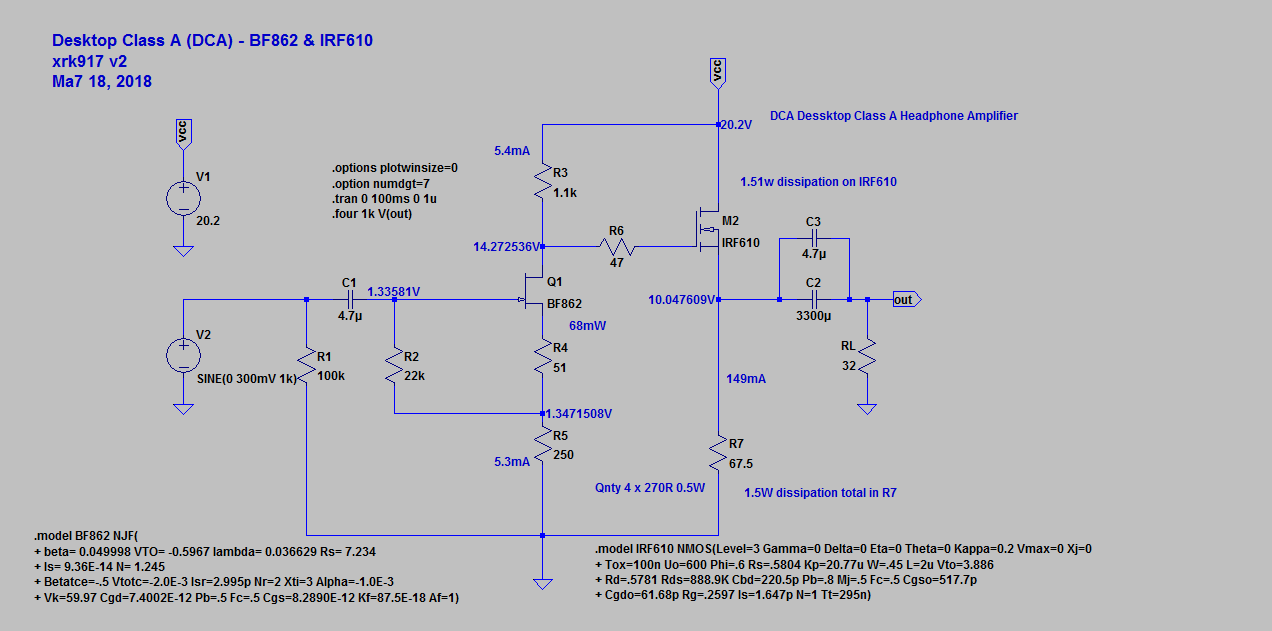

Another thing,
could you display the currents in your schematic.
It is helpful for understanding.
Also specify voltage, especially the power supply.

Hi Lineup,

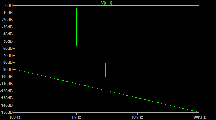

Yes, the BF862 is really nice sounding. Super low noise, and very inexpensive. Has 20v limit though. Here is a typical DC setpoint for the DCA when running a hot 150mA bias. There is also a 125mA setting that has a bit more H2 vs H3 but overall higher THD. Still, 0.02% to 0.05% THD for driving 30ohm cans is not bad for a two transistor amp with no global feedback.
X
FFT for 2vpp into 30ohms:
X

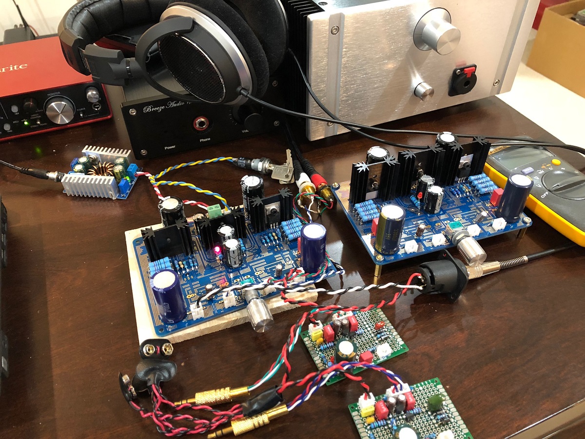

In preparation for testing out the balanced drive setup, I just built a second DCA. Works like a charm upon initial power up. This is an easy to build amp - guaranteed to run if you don't make any mistakes in stuffing it.
I only had some smaller stubby heatsinks, and they work fine still. In the foreground are some nice SE Class A, unbalanced-to-balanced drive phase converters made with just two BJTs. Those are powered by 4x9v batteries for 36v Vcc. My DAC has balanced outputs so not absolutely needed, but useful for plugging in any regular unbalanced source.
Some hand adjustments of resistor values is giving more balanced output. The R106/R109 1k1 resistor was producing early negative clipping. Changing to 910R improved things a lot.
Adjustments of R107/R111 to 56R seems to give a good balance of overall low THD and good proportions of H2 vs H3.
Vcc is set at 20.07v at the MOSFET drain.
For 1,0vpp into 270ohms, this gives 0.023% THD and H3 is -18dB below H2.
It sort of depends on your particular JFETs and MOSFETs, but if you are using the JFETs I provided, yes. One way to check is to adjust the R106/R109 up or down a bit to get about Vcc/2 at the output node above the power resistors and on the source side of the MOSFETs. Within 0.5 to 0.7v is ok but if it is more than 1v off, then adjust it. The default 1k1 was giving me 8.3v with 20v Vcc, so it was clipping way early on bottom. With new value, it was 9.4v. As for the balance in H2/H3, you need to look at FFT but using a value between 51R and 67R should be ok - you can adjust to taste. I did find that Vcc of about 20.2v was the sweet spot and 21.5 give very low THD but H2 and H3 are about equal.

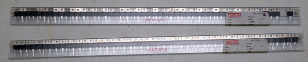

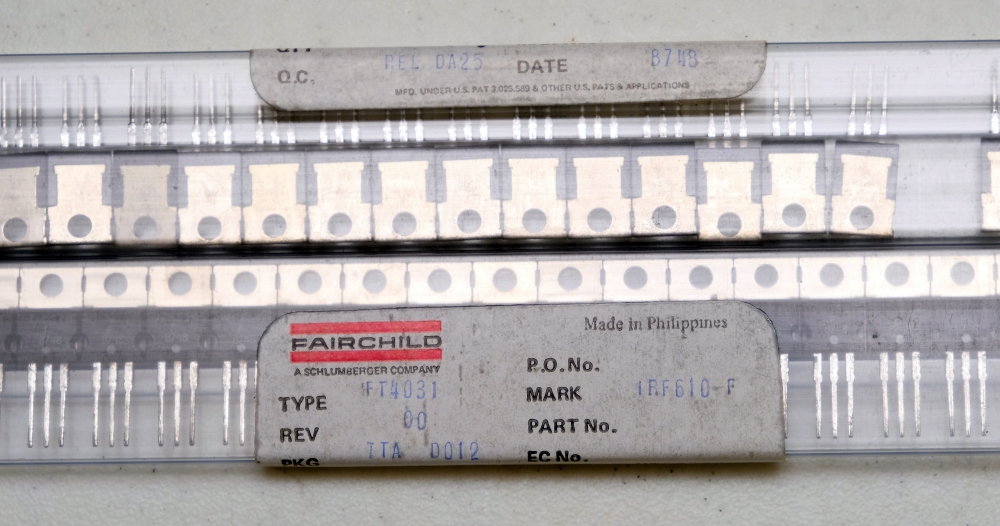

If anyone for this build or others you might be building, I recently scored some NOS Fairchild IRF 610. Got a hundred.
1usd for two needed in the DAC, shipping etc covered. If you need more, we can figure it out.
I will also VGS match them to best of my ability.
