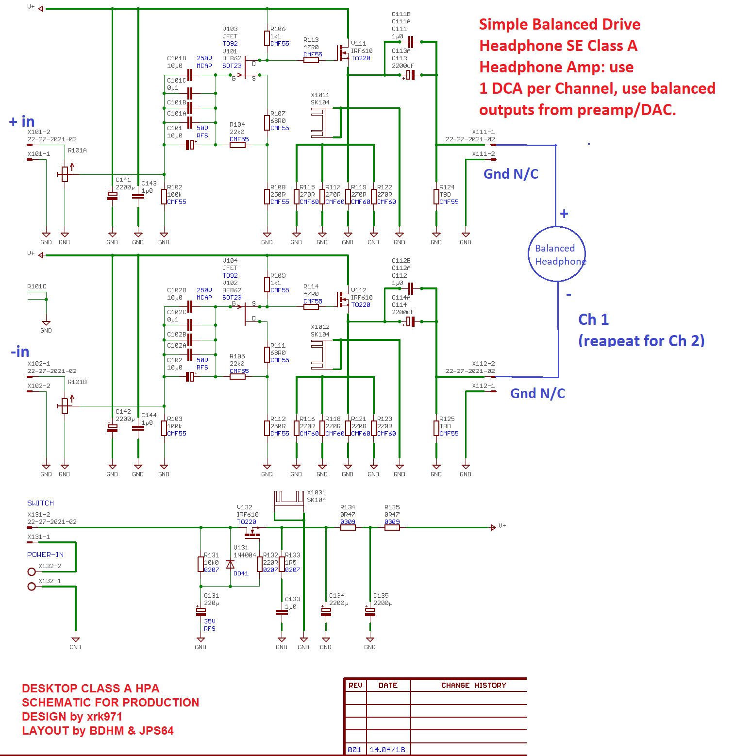

In case anyone has a DAC or preamp with balanced outputs (+ve and -ve phase balanced line driver), and they have headphones modified to accept balanced drive amps, there is an easy way to make yourself a unique, and very cost effective balanced SE Class A HPA. Just use two DCA boards, one for each earpiece (driver). By doing this, you get 4x the power, and twice the slew rate. Best of all, because this is a SE Class A amp that is cap-coupled, you never need to worry about the amp going DC on you and blowing out your expensive cans. I have tried this with the PCA before and it sounds fantastic. So much dynamic reserve, and everything sounds so much more powerful.
Here is schematic:
So, if you were to run each amp with Vcc of 25v, and 150mA bias current, with 42ohm cans you can get about 2.2wrms and +/-20vpp swing from an effective Vcc of 50v. This is useful for super inefficient 74dB planar headphones.
Here is schematic:
In balanced mode you have the two 2200uF output blocking caps in series, giving you an effective reduction to 1100uF. Best short one out or increase their size to 4700uF to maintain the same bass response.
