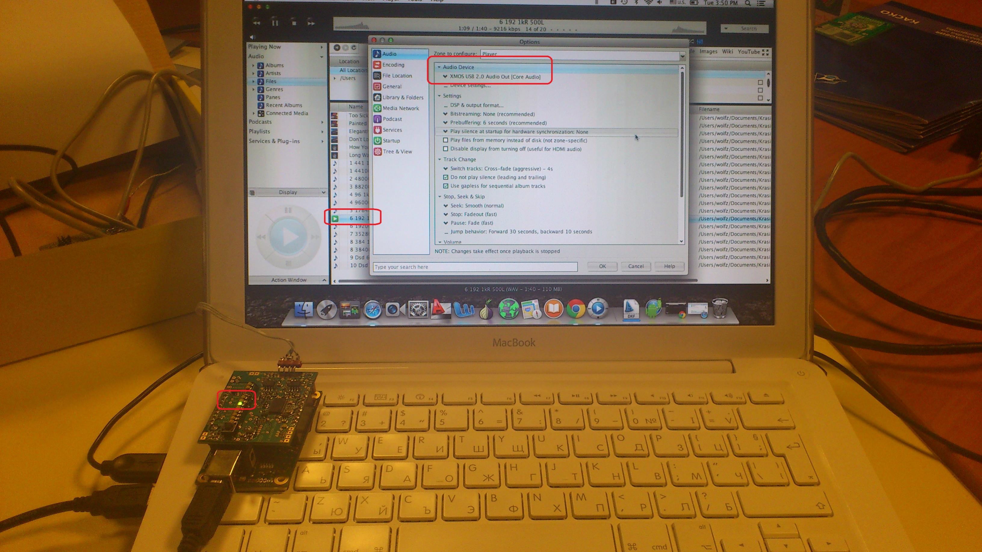

Sorry for my late answer, but I have to find MAC. My friend has MAC Unibody 2008, with only USB 2.0 ports. MAC OS X 10.9.1.

The Mac, which I tested there weren't problems with recognition of the board, everything was smooth and according to the expectations.

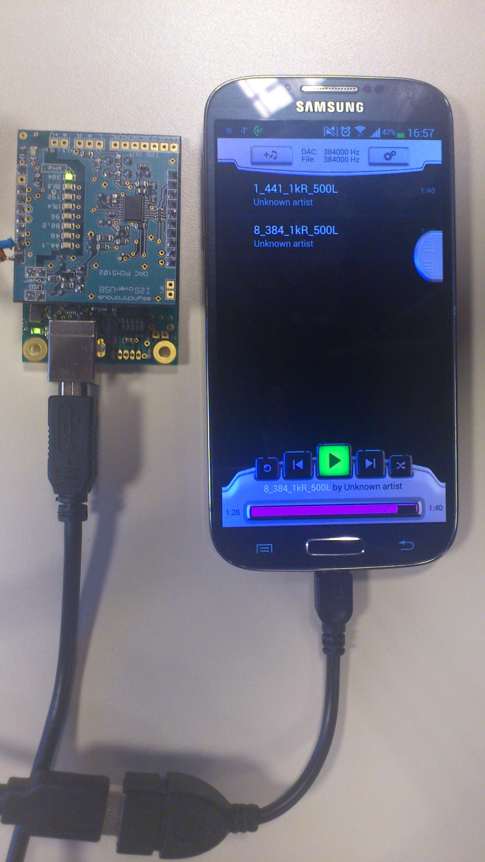

Some good news for Android users.
I've tested the device with Samsung Galaxy S4, HTC One X by using this program,
https://play.google.com/store/apps/details?id=com.extreamsd.usbaudioplayerpro
I've tested it up to 384kHz and works perfect. Of course with external power supply for the USB part. If one can install this program (there is a trial) and have USB OTG, XMOS board must be working. If someone test his Android device, please share.

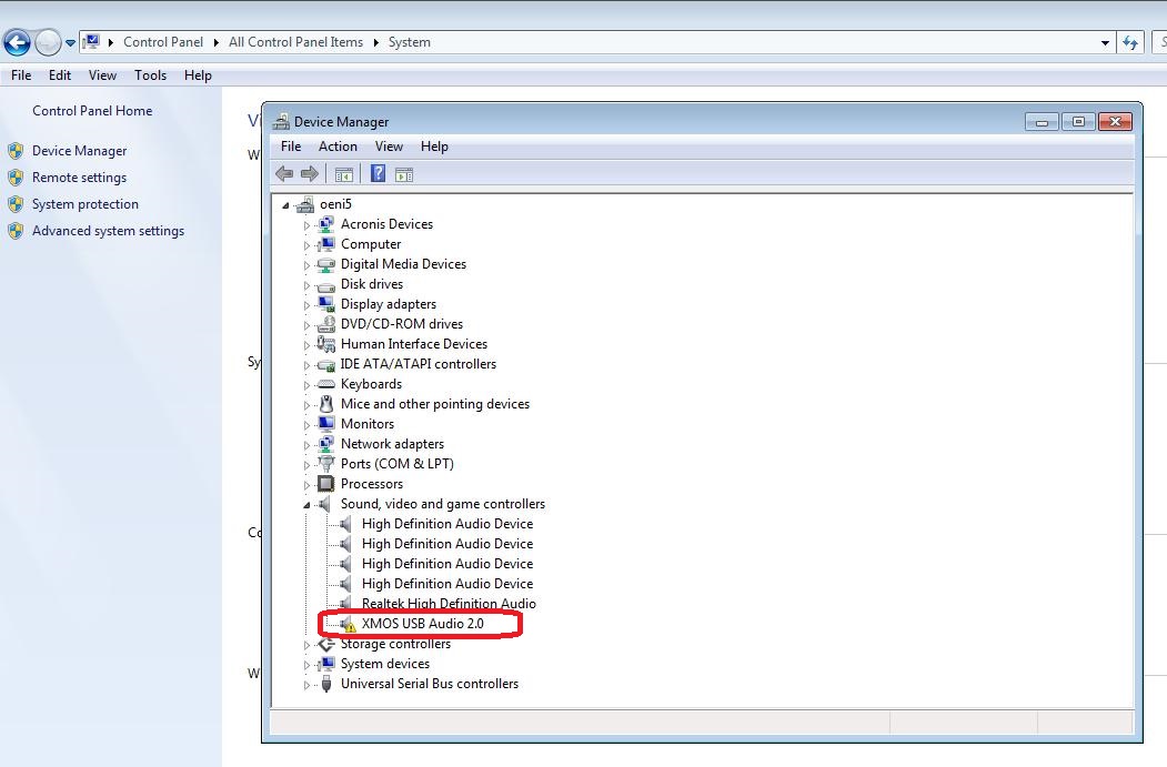

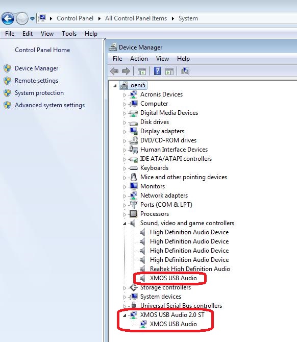

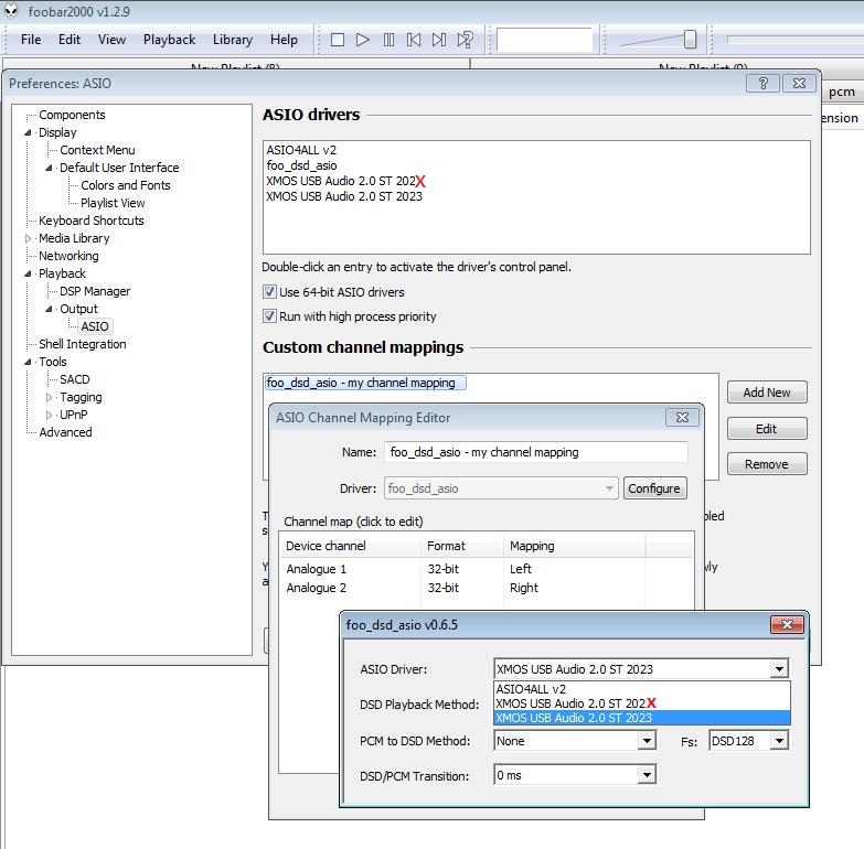

I'll attach some pictures, one is before the installation of the XMOS driver, second one is when the drivers are installed and the last one is that if you use more that one USB audio device, you have to select the device that you want to use at the moment (for example: foobar).
